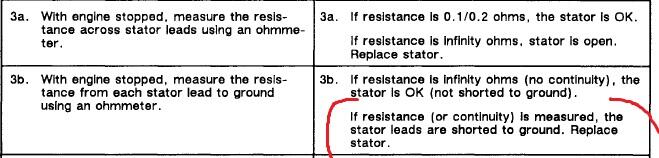

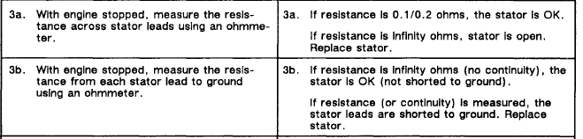

gwest_ca-(File Mod) 12,320 #6 Posted August 4, 2025 For 15 amp stator 3 Share this post Link to post Share on other sites
squonk 47,244 #7 Posted August 4, 2025 This test in red is only valid with the leads hanging free. A chafed lead can be repaired instead of replacing the stator 1 Share this post Link to post Share on other sites
