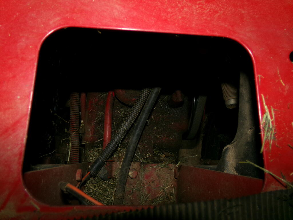

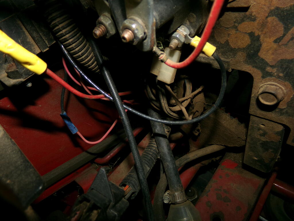

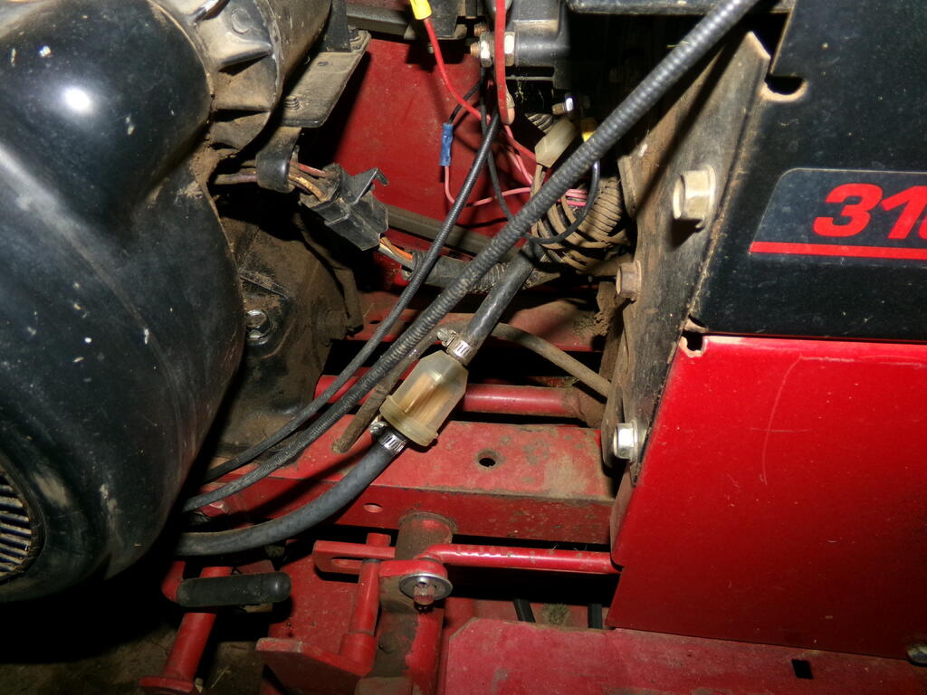

Razkid 69 #1 Posted August 3, 2025 The person that owned this tractor took the fuel line off because it got cut by the steering gears under the dash so that couldn't have been the correct routing of the line. Shouldn't there be some type of hold down for it under the seat location? Should it come out on the left side of the dash housing? If someone could post a picture of it's routing from the tank, I would appreciate it. TIA! Share this post Link to post Share on other sites
Ed Kennell 47,270 #2 Posted August 3, 2025 This is my 310-8. The fuel line leaves the tank and goes under the seat on the left side crossing to the right. No picture, but it must enter and exit the tunnel on the right side. Then crosses back to the left side in front and above the fan gear. 1 Share this post Link to post Share on other sites
Lee1977 7,768 #3 Posted August 3, 2025 It goes through the hole with the plastic bushing on the right side of the hood stand. There is also clip to hold it bolted up inside the hood stand at the front. Share this post Link to post Share on other sites
Razkid 69 #4 Posted August 4, 2025 Thanks for the replies! I have the fuel line installed in the correct location now so let the fun begin! 1 Share this post Link to post Share on other sites
