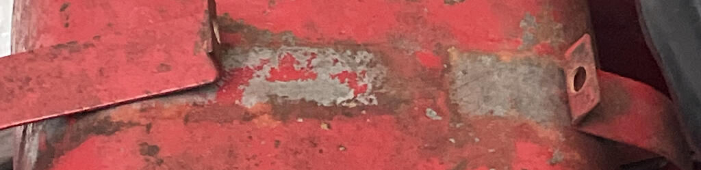

FLtractor 223 #1 Posted August 3, 2025 Evening, For those of you that assisted me on my fuel system issues, thank you, I got the new under gas tank valve installed, but when attempting to re tighten the metal gas tank strap, realized it’s much too tight with too short a bolt with no area to manuver hand to tighten nut.. so off to hardware store tomorrow to get a longer bolt to make easier accessible. Wondering if anyone has used any different means to secure gas tank on instead of the orignal factory metal strap idea. Share this post Link to post Share on other sites
rjg854 13,343 #2 Posted August 3, 2025 If it worked before it should work again Are you sure you've got it placed properly and there isn't something under the band that shouldn't be in there? Share this post Link to post Share on other sites
FLtractor 223 #3 Posted August 3, 2025 1 hour ago, rjg854 said: If it worked before it should work again Are you sure you've got it placed properly and there isn't something under the band that shouldn't be in there? No exactly as was orignal. Just very tight space to work in and couldn’t even get the Orginal nut threaded on the Orginal square bolt with 4 pairs of hands. Having to have one hold and one tighten. 1 Share this post Link to post Share on other sites
pfrederi 21,145 #4 Posted August 3, 2025 Use a square nut and a slot or phillips head bolt. The square nut will sort of self lock against strap. 1 Share this post Link to post Share on other sites

Retired Wrencher 6,982 #8 Posted August 4, 2025 Fltractor it’s made to be that way to hold a tank in place. Get yourself some big pliers press the two ends together if you have some channel locks use that and slip a bolt and nut tighten easy do not torque it down. Enjoy the project. 1 Share this post Link to post Share on other sites
FLtractor 223 #9 Posted August 4, 2025 6 minutes ago, Retired Wrencher said: Fltractor it’s made to be that way to hold a tank in place. Get yourself some big pliers press the two ends together if you have some channel locks use that and slip a bolt and nut tighten easy do not torque it down. Enjoy the project. Thank you for the advice. Share this post Link to post Share on other sites
