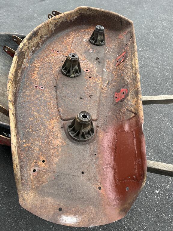

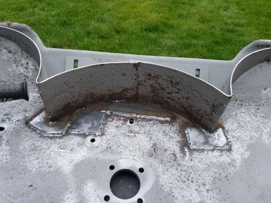

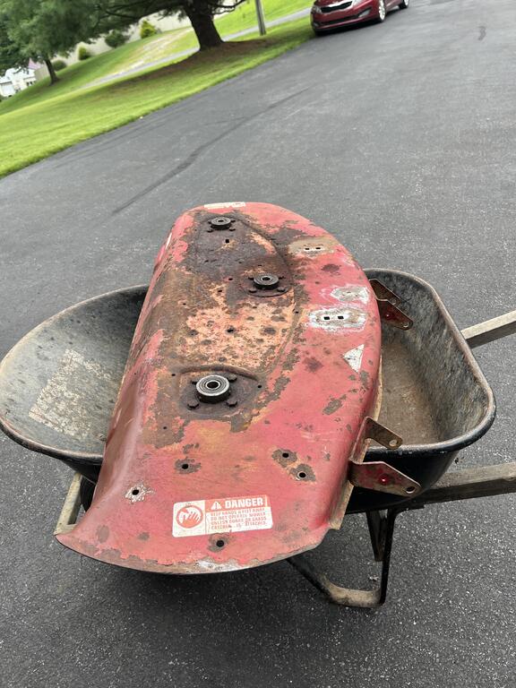

terc 24 #1 Posted August 1, 2025 I am sure this has been discussed before, however I was not able to find any info. So what are the recommendations on how to prepare a badly rusted mower deck and which rust reformer to use before priming and then painting. I was able to repair those sections that were totally rusted thru with new metal. Share this post Link to post Share on other sites

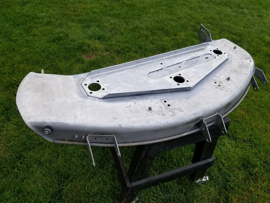

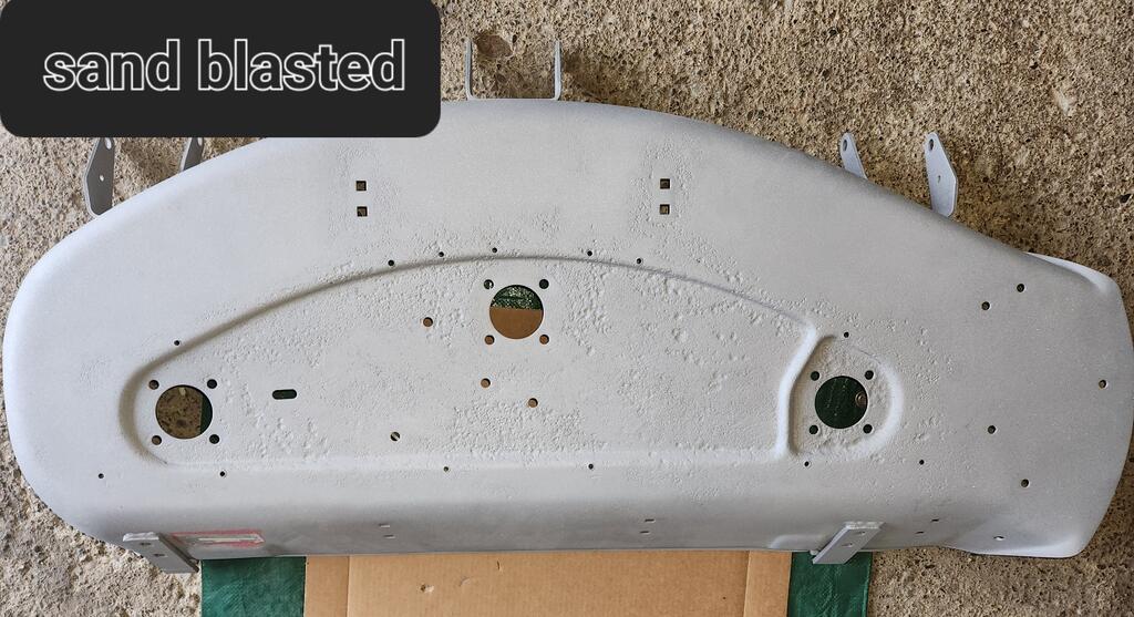

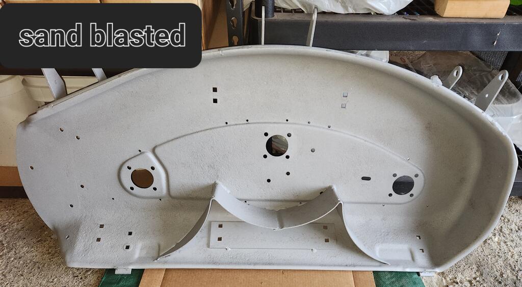

Brockport Bill 2,258 #4 Posted August 2, 2025 I have found if deck i acquired has lots of pitting then having it professionally sand blasted rather than my own labor of wire brush and grinder pad that the sandblasting is worth the expense...it really gets into the rust pits....huge advantage having every bit of corrosion gone.....plus the paint job looks much better if that's important to you. 3 Share this post Link to post Share on other sites

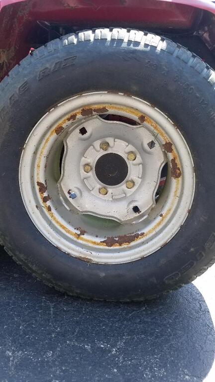

Brockport Bill 2,258 #7 Posted August 2, 2025 7 hours ago, ri702bill said: I use a pneumatic needle scaler for such work. It does a fine job. agree, the scaler often more effective for pitted areas..... I often use the scaler as well -- more effective often than the 90 degree grinder or the wire brush --- I find the scaler tool especially helpful for hard to reach areas when doing rims - especially the deep rear rims the scaler gets into areas like creases the other tools or my hands can't easily get into etc - 4 1 Share this post Link to post Share on other sites
Brockport Bill 2,258 #8 Posted August 3, 2025 I have long appreciated the info, insights and advice here on RSQ as I have have become more vested in the herd since my original 312-8 we bought in 1989 -- one of the topics always of interest were the comments about saving the mower decks and especially the rust issue and the various strategies -- eg: Pete's advocacy of the oil and sun baking etc -- so a few weeks ago in June i removed my deck for it's typical routine mid summer cleaning -- pressure wash and oiling - - its now been a few weeks, so I thought i would share what the bottom of the deck looks like after what i am guessing was about 4 or 5 cuts -- but in full disclosure, I don't mow my lawn when its wet - i always use top throttle and and i don't wait for it to get 5 inches tall -- but as you can see the deck is still virtually bare of any stuck on accumulated grass debris and clippings -- so I guess its more proof of the value of oiling and other strategies to "SAVE THE DECKS " here are photos from cleanig and oil then after mutiple cuts 2 1 Share this post Link to post Share on other sites

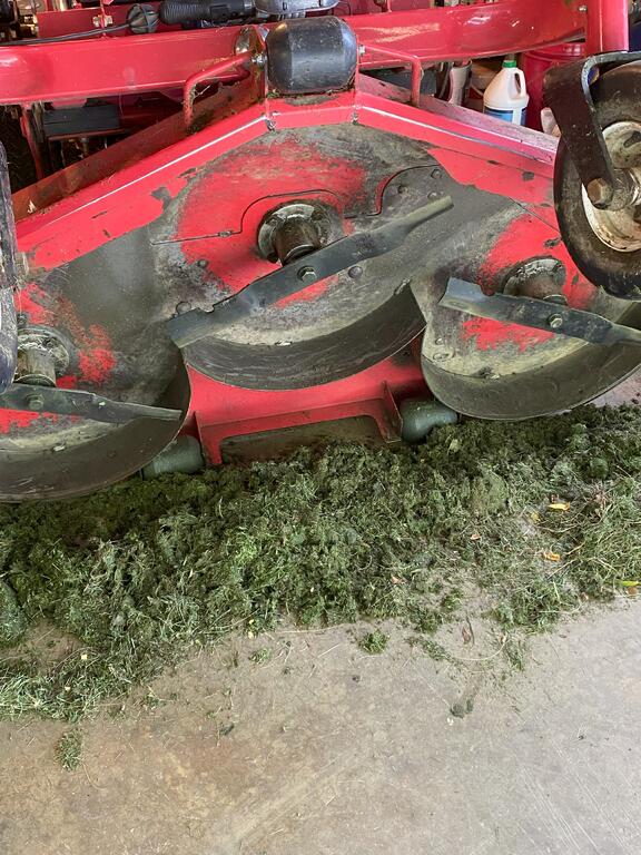

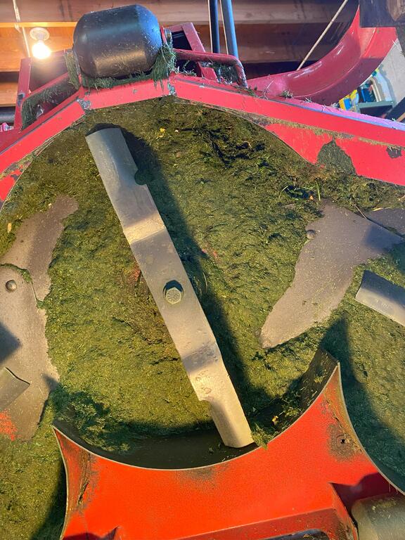

lynnmor 8,693 #10 Posted August 3, 2025 (edited) Three weeks in a row with a complete cleaning and oiling. I call BS on the effectiveness of oiling to prevent buildup. That's about 6 gallons of crud each time. Edited August 3, 2025 by lynnmor 1 Share this post Link to post Share on other sites
peter lena 9,804 #11 Posted August 3, 2025 @lynnmor have none of that in / on my decks , would not have suggested it if it was a repetitive issue , only have rear discharge decks , with baffles removed . highest cutting setting , retention of any grass is always next to nothing . will be cutting later today . pete Share this post Link to post Share on other sites
Brockport Bill 2,258 #12 Posted August 3, 2025 1 hour ago, lynnmor said: Three weeks in a row with a complete cleaning and oiling. I call BS on the effectiveness of oiling to prevent buildup. That's about 6 gallons of crud each time. that accumulation of grass looks like it has a lot more moisture in it than my grass - are you mowing damp grass? -- or your grass must be lots healthier than mine with more mositure content? It's interesting photo because i never get that accumulation. Share this post Link to post Share on other sites

kpinnc 17,563 #16 Posted August 3, 2025 4 hours ago, lynnmor said: Three weeks in a row with a complete cleaning and oiling. I call BS on the effectiveness of oiling to prevent buildup. We've had so much rain this year that any mowing results in sticky green accumulation on a deck. That soft heavy spring grass? We've had it all summer. I have no idea which method works best. What works in NC may be useless in Indiana. Different environment, different grasses. I think what is important is to try to keep the deck cleared off after each use. Until I find something that is effective, that's what I'll do. 1 Share this post Link to post Share on other sites
lynnmor 8,693 #17 Posted August 3, 2025 I clean out after every mowing, there is always considerable buildup. Since the 60" deck on my zero turn flips up to a vertical position, cleaning is rather easy. My 60" Wheel Horse deck builds up the same but all I can easily do is run it up a ramp and hose it out. While I try to mow only dry grass I did mow one time this year with a wet lawn and it even rained while doing it, I had the least amount of buildup ever. There is no such thing as soaking steel with oil of any kind, ask yourself how would they keep it in the can. 1 Share this post Link to post Share on other sites
kpinnc 17,563 #18 Posted August 3, 2025 1 hour ago, lynnmor said: There is no such thing as soaking steel with oil of any kind, ask yourself how would they keep it in the can. I agree. However, I think coating the deck with oil has its merit. Is it a fix all? No it is not. Oil creeps everywhere by capillary action. That's one of the properties that make it a good lubricant. If nothing else, the underside of the deck won't flash rust. Personally, I think that is the only positive it provides down here in the south. Again, just cleaning out the grass after each use works best. Maybe epoxy coating or similar lasts a while, but I haven't found anything that protects a deck all season yet. Share this post Link to post Share on other sites
