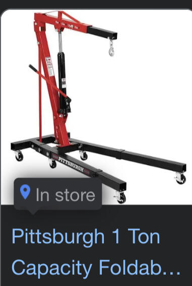

FLtractor 114 #1 Posted August 1, 2025 (edited) Afternoon, Anyone ever use a hoist such a this to lift a garden tractor by using a 4 way sling that could firmly and safely support the weight? Edited August 1, 2025 by FLtractor 1 Share this post Link to post Share on other sites
Gasaholic 352 #2 Posted August 1, 2025 28 minutes ago, FLtractor said: Afternoon, Anyone ever use a hoist such a this to lift a garden tractor by using a 4 way sling that could firmly and safely support the weight? I'm assuming there's a picture somewhere but it didn't make it into the post? I somehow suspect you refer to a shop crane/ engine hoist? Share this post Link to post Share on other sites
FLtractor 114 #3 Posted August 1, 2025 8 minutes ago, Gasaholic said: I'm assuming there's a picture somewhere but it didn't make it into the post? I somehow suspect you refer to a shop crane/ engine hoist? Forgot to post .. fixed see above Share this post Link to post Share on other sites

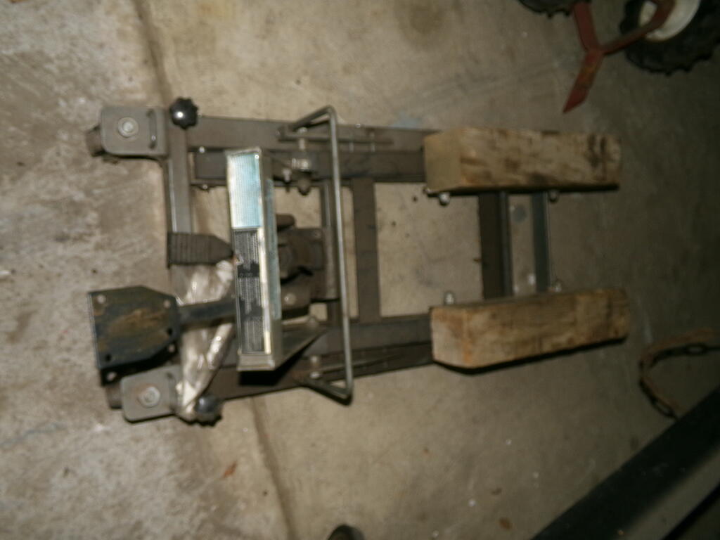

Ed Kennell 44,810 #4 Posted August 1, 2025 Never used an engine hoist to lift an entire tractor, but till you got the required rigging on, I don't think you would have much lift height remaining. I use a small overhead hoist to lift the front end only for installing and removing decks. To lift the entire tractor, I think you would be better served to use a garden tractor lift or a scissor lift table if you want it higher. 4 1 Share this post Link to post Share on other sites
FLtractor 114 #5 Posted August 1, 2025 19 minutes ago, Ed Kennell said: Never used an engine hoist to lift an entire tractor, but till you got the required rigging on, I don't think you would have much lift height remaining. I use a small overhead hoist to lift the front end only for installing and removing decks. To lift the entire tractor, I think you would be better served to use a garden tractor lift or a scissor lift table if you want it higher. Good point about lift height and the hydraulic table.. thinking of different ways I could remove and replace the rear tires and remove the deck eventually. Share this post Link to post Share on other sites
ri702bill 11,232 #6 Posted August 1, 2025 An old fashion floor jack works well for removing rear tires. Just be careful as the tractors tend to be right side heavy and the frame will revolve on the front axle pivot pin.... 6 Share this post Link to post Share on other sites
JoeM 9,603 #7 Posted August 1, 2025 45 minutes ago, ri702bill said: frame will revolve on the front axle pivot pin I have a couple door stop shaped wood wedges that I tap in the gaps between the frame and the top of the front axle. 5 2 Share this post Link to post Share on other sites
953 nut 64,066 #8 Posted August 1, 2025 1 hour ago, ri702bill said: An old fashion floor jack works well for removing rear tires. Just be careful as the tractors tend to be right side heavy and the frame will revolve on the front axle pivot pin.... Once the first tire comes off the other side WILL go down so don't jack the rear any higher than needed. I prefer to jack the rear up and use jackstands or cribbing under both sides to stabilize the frame prior to doing any work. I use my engine hoist to lift the front end for mower removal / instal like @Ed Kennell. 3 1 Share this post Link to post Share on other sites

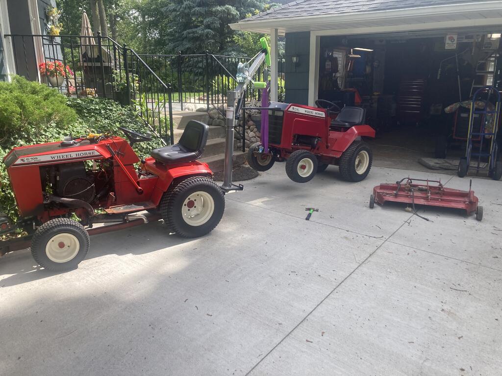

SylvanLakeWH 30,557 #10 Posted August 2, 2025 Here's what I use for decks. Harbor Freight pick up truck crane mounted on 2" hitch winch plate: Works great! 3 Share this post Link to post Share on other sites

adsm08 4,186 #13 Posted August 2, 2025 (edited) I would not think using an engine hoist to lift a tractor would work well. I agree you will have too much length in the rigging to get it very high, and you will need to have the boom very far out. The weight ratings at the different boom length are what the ram can lift, and often much lower than the actual weight at which the assembly becomes unbalanced. To lift an axle for tire service this is at best the wrong tool that might do the job, but poorly, akin to using a large wrench as a hammer. A floor jack with proper support is far better, and they don't get too unbalanced. My kids can both hold the tractor level while it is on a jack. To lift a tractor the whole way off the ground, you can go ahead and try, but please do it far away from me. To get the deck out, detach it, turn the front wheels the whole way to the right, and slip the deck out from the left. Sometimes tipping it up a little bit to clear the lift link is required, but that's all the more "lifting" I've ever had to do on my 855. Edited August 2, 2025 by adsm08 Share this post Link to post Share on other sites
