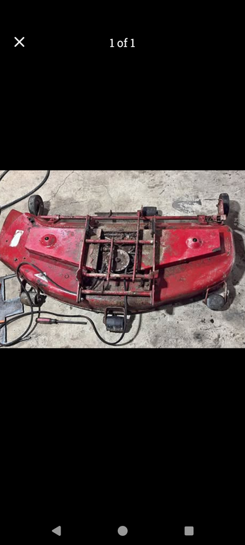

jsoluna 514 #157 Posted January 3 (edited) Already thinking about spring. More to come on the front blade, weight ballasting, etc but I'm curious: I had planned on patching up the 42"SD deck, but it is pretty bad for the entire spindle mounting area and will require significant repairs. Rather than fix the Raider's 42", am I able to swap the lifting carriage from it onto another, more common newer style deck? The Raider is pre Attach-A-Matic. There this decent newer 48" not far from me. Is it possible to swap the lifting components over and use a different deck or are there other issues I'm unaware of? Edited January 3 by jsoluna Share this post Link to post Share on other sites
Handy Don 17,170 #158 Posted January 3 Disclaimer: I am NOT an expert on the Raiders. That said, decks need three things: 1. A compatible lifting chassis (attach-a-matic location and strength) 2. A compatible power delivery, i.e. mule & belt routing 3. Room under the tractor (short, “medium”, or long frame; front wheel size) @gwest_ca can you please add a link to the “cross reference” document that shows which decks were made to go on which models? 2 Share this post Link to post Share on other sites
ebinmaine 80,068 #159 Posted January 3 @jsoluna You got one o them there welding thingamajigs. Y' oughtta add a mule bracket to the front of the Raider. 1 Share this post Link to post Share on other sites

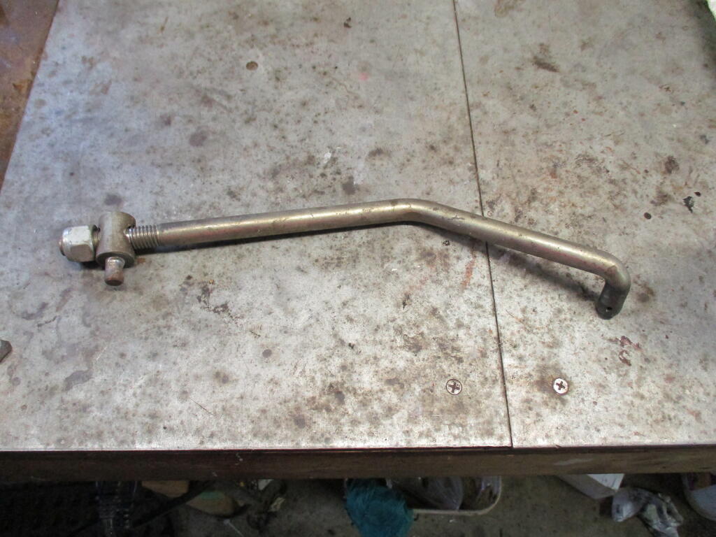

pfrederi 20,992 #160 Posted January 3 (edited) might be faster easier to put front tachmatic on the tractor. and use this to lift the deck Edited January 3 by pfrederi 3 Share this post Link to post Share on other sites

jsoluna 514 #163 Posted January 3 2 hours ago, Handy Don said: Disclaimer: I am NOT an expert on the Raiders. That said, decks need three things: 1. A compatible lifting chassis (attach-a-matic location and strength) 2. A compatible power delivery, i.e. mule & belt routing 3. Room under the tractor (short, “medium”, or long frame; front wheel size) @gwest_ca can you please add a link to the “cross reference” document that shows which decks were made to go on which models? I have the document in my files, thanks Don. I was curious if anyone has done this exact thing before by using a deck that was not necessarily intended for that model, and if so what that entails. Share this post Link to post Share on other sites
jsoluna 514 #164 Posted January 3 1 hour ago, pfrederi said: might be faster easier to put front tachmatic on the tractor. and use this to lift the deck How big of a deal is it to convert the Raider to the Attach a Matic mule and lift system? Would it still work with the electric PTO vs the manual PTO that is more common? 2 Share this post Link to post Share on other sites
ebinmaine 80,068 #165 Posted January 3 Just now, jsoluna said: I have the document in my files, thanks Don. I was curious if anyone has done this exact thing before by using a deck that was not necessarily intended for that model, and if so what that entails. Add the front hitch by welding a bracket on it. That'll permit use of the front mule drive. Then add a mid attach o matic if ya don't already have one. Then add the lift link as seen above. Presto. 1 1 Share this post Link to post Share on other sites
ebinmaine 80,068 #166 Posted January 3 1 minute ago, jsoluna said: Would it still work with the electric PTO vs the manual PTO that is more common? Yes 2 1 Share this post Link to post Share on other sites

jsoluna 514 #168 Posted January 3 58 minutes ago, ebinmaine said: Add the front hitch by welding a bracket on it. That'll permit use of the front mule drive. Then add a mid attach o matic if ya don't already have one. Then add the lift link as seen above. Presto. Fantastic. Thanks again guys. I'll be looking for the related parts to convert this spring if anyone would like to part with them. 1 Share this post Link to post Share on other sites
