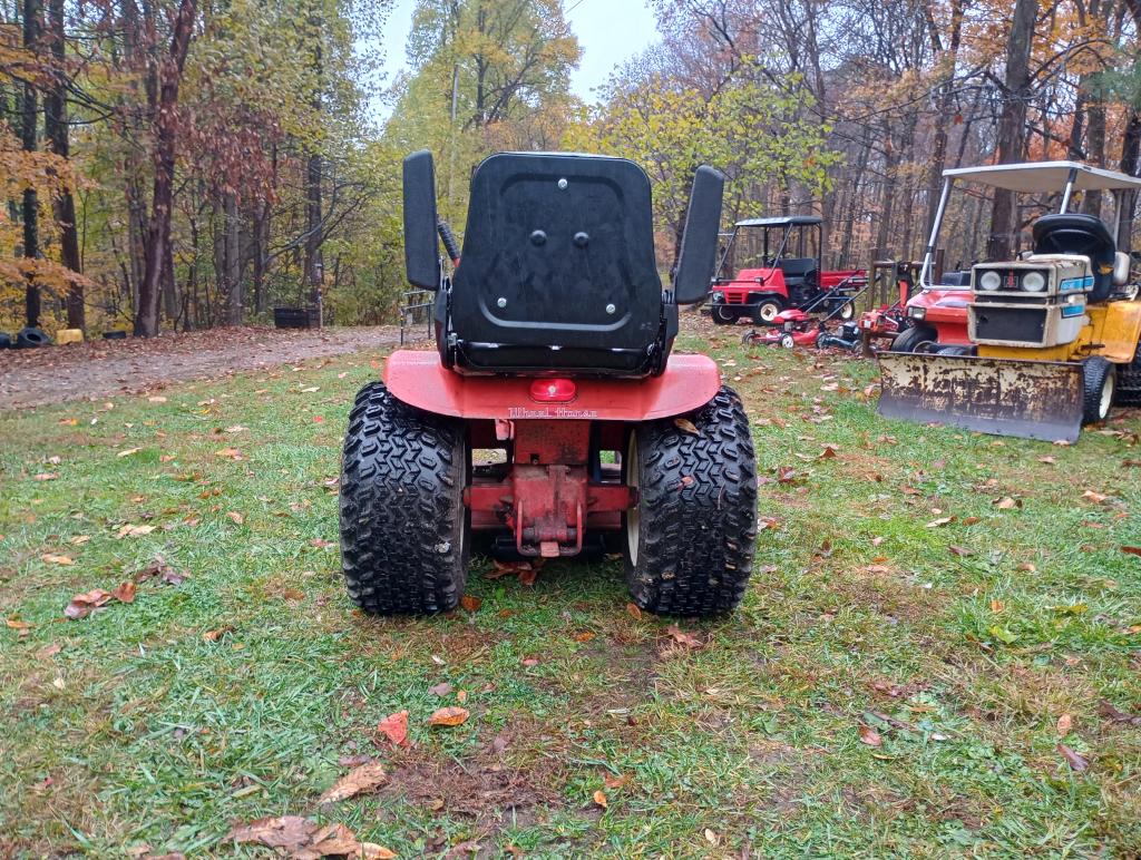

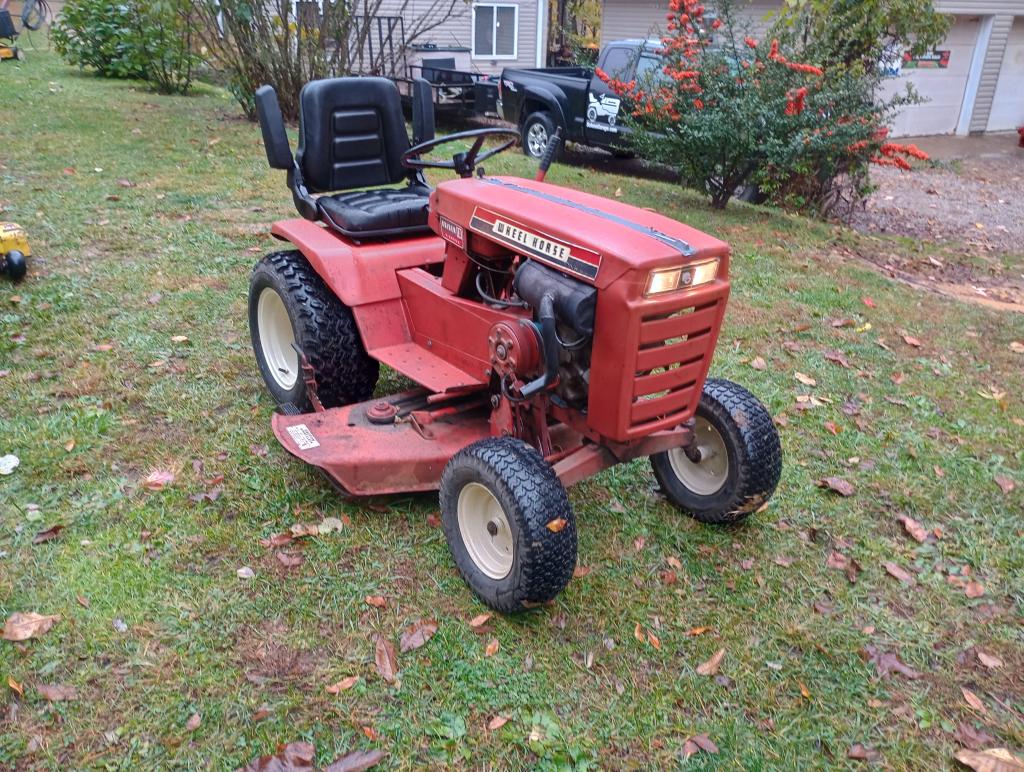

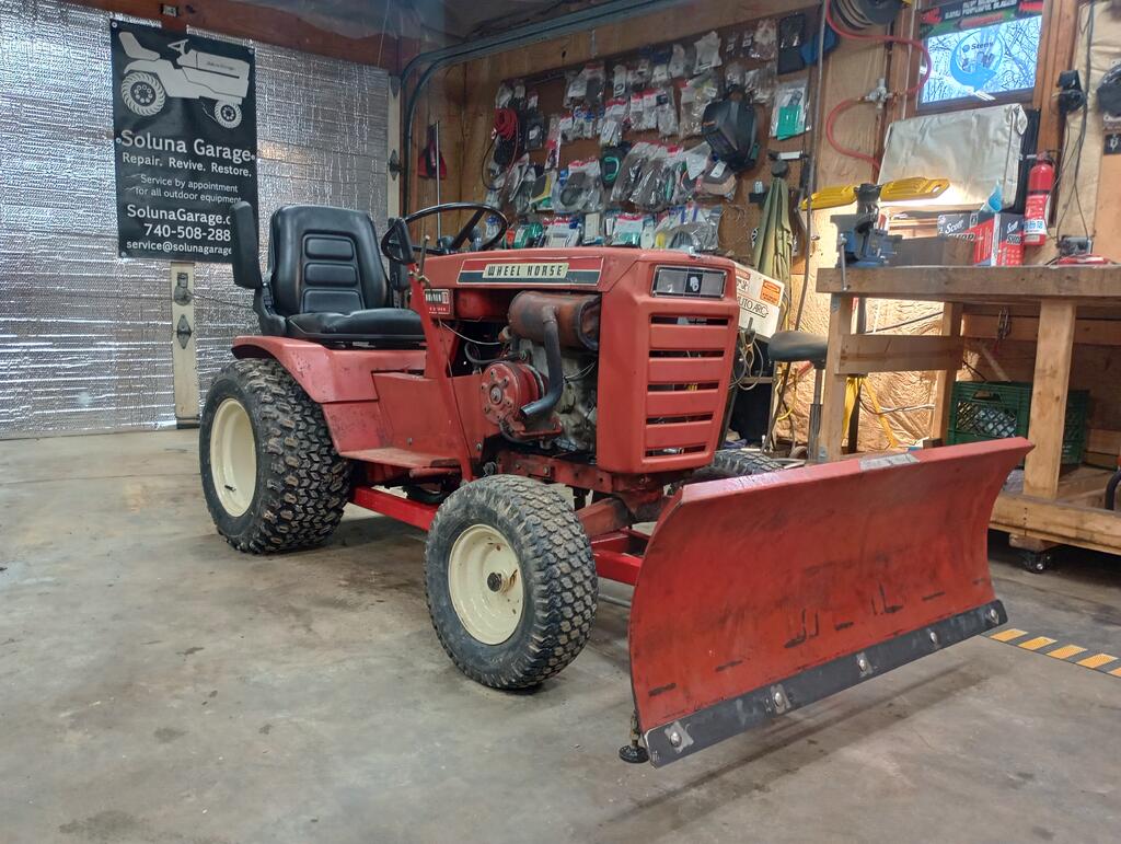

kpinnc 19,107 #101 Posted October 25, 2025 1 hour ago, jsoluna said: Some current full unit view pics for posterity. Should be good for another 30-40 years! 2 1 1 Share this post Link to post Share on other sites

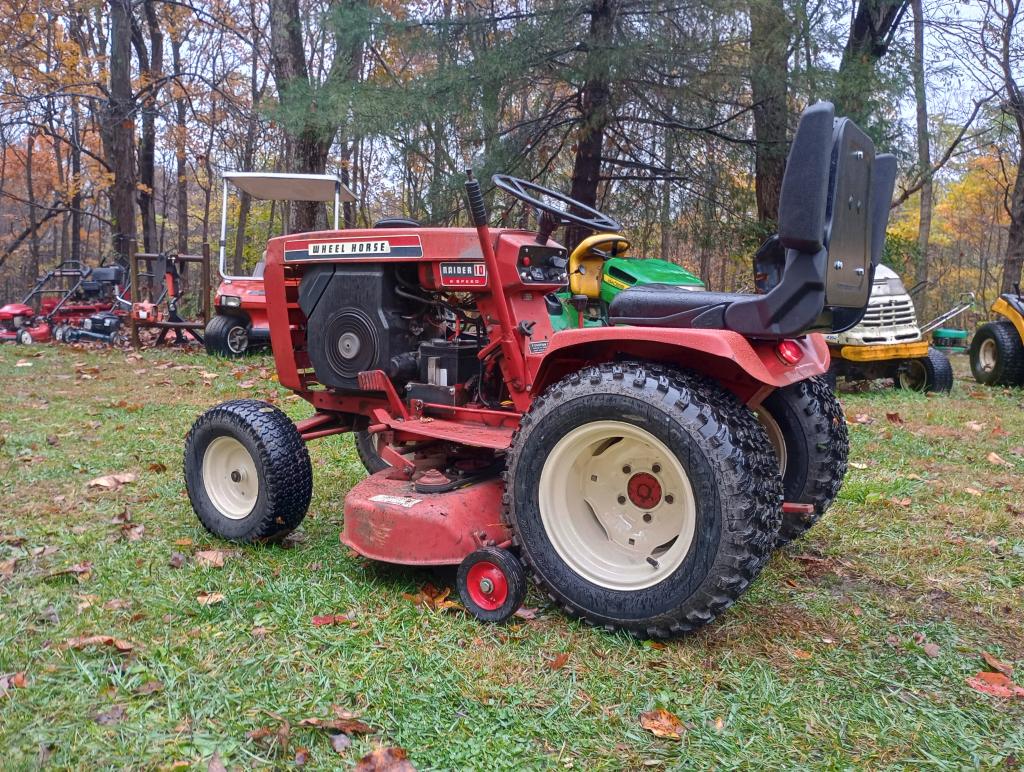

jsoluna 514 #102 Posted November 19, 2025 (edited) Progress still going on in the background. Pics to come. Our YouTube channel has videos set to publish later this month. Flushed and filled transmission fluid. Replaced rear wheels and tires. Installed new high back seat with armrests. Replaced deck idler pulley, belts all around. Been using the unit pretty much exclusively around her for leaf cleanup, general town ng and dragging duties, and it has really proven itself to be a reliable, enjoyable machine. I also just found a basket case 520H literally five minutes from our shop....I think the bug has bitten. Edited November 19, 2025 by jsoluna 1 3 Share this post Link to post Share on other sites

jsoluna 514 #106 Posted November 20, 2025 New seat and rear wheel/tires. Really made a difference in how it feels and performs. I'm 6'4", so that's why the seat is so far back, but it is mounted on sliders. I've used these seats for other projects and you cannot beat them for the price and comfort. Tires I have also used on other projects and they excel in all conditions over ags except for clay/mud. 2 3 Share this post Link to post Share on other sites
ebinmaine 81,281 #107 Posted November 20, 2025 6 hours ago, jsoluna said: New seat and rear wheel/tires. Really made a difference in how it feels and performs. I'm 6'4", so that's why the seat is so far back, but it is mounted on sliders. I've used these seats for other projects and you cannot beat them for the price and comfort. Forgive my poor memory here... Where the seat pan latches - is your latch and catch bar in excellent condition? That's a known trouble area for wear which will allow the pan to flip up. I'm not as tall as you at just over 6 ft but I'm larger in build. I keep the seats on my tractors about 2" further back than stock max position by using drilled steel square bar. The latch and catch NEEDS to be good and solid because we set back so far. 6 hours ago, jsoluna said: Tires I have also used on other projects and they excel in all conditions over ags except for clay/mud. Really like the look of those. We do have the mud here so I can't use them. Also a forest full of decomposing leaves. If I ever need a set for using with chains in the winter I'd consider buying those. Very nice! 3 1 Share this post Link to post Share on other sites

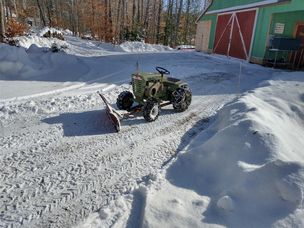

ebinmaine 81,281 #117 Posted November 23, 2025 15 hours ago, kpinnc said: I have picked myself up several times and before anything else- made sure no one saw my gymnastics... Here's the post telling my story... @jsoluna you'll like this one. 2 1 Share this post Link to post Share on other sites

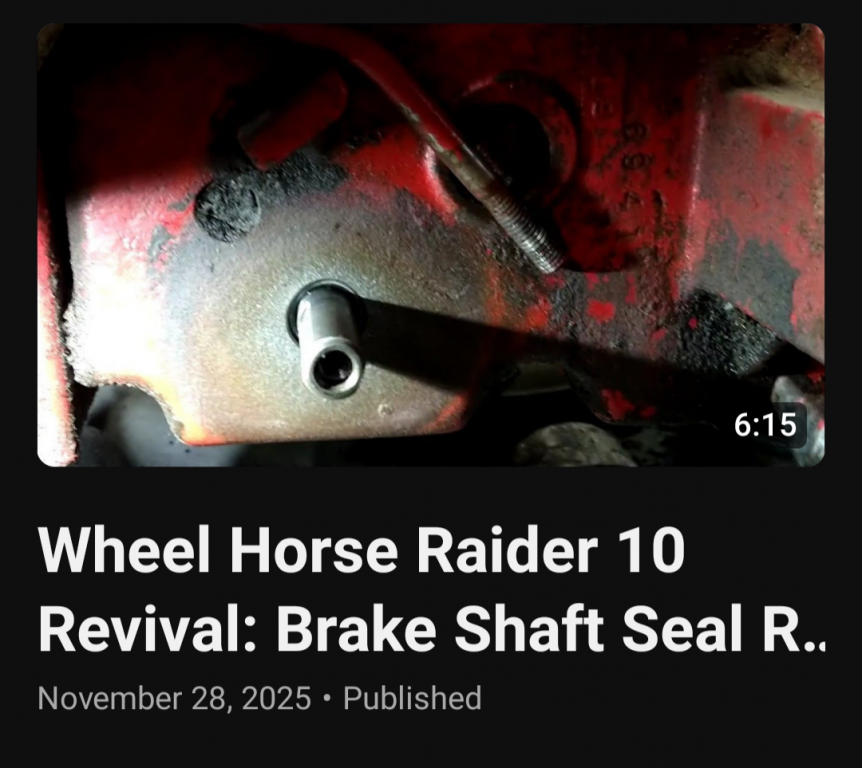

jsoluna 514 #119 Posted November 30, 2025 (edited) Soluna Garage: Raider 10 Brake Shaft Seal Replacement Edited November 30, 2025 by jsoluna 3 1 Share this post Link to post Share on other sites
ebinmaine 81,281 #120 Posted November 30, 2025 Good tip on that feeler guage for sliding the seal on. I'll have to remember that.. If you need a shifter boot or brake band there are good sources for both here on Redsquare. 2 1 Share this post Link to post Share on other sites

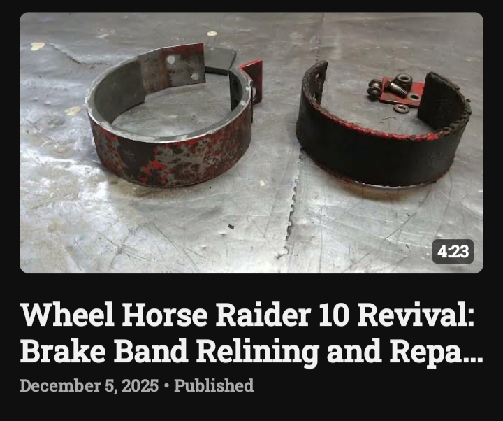

jsoluna 514 #121 Posted December 5, 2025 Raider 10: Brake Band Relining 2 Share this post Link to post Share on other sites
jsoluna 514 #122 Posted December 5, 2025 The front blade is installed! Thanks @ebinmaine for the axle bracket! More details to come. Made a replacement wear bar, made the solid lift link, made a new pivot pin, and fabricated some skid shoes to help with the gravel drive. Loaded the rears. Excited. 1 2 Share this post Link to post Share on other sites

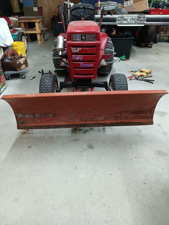

ebinmaine 81,281 #123 Posted December 5, 2025 21 minutes ago, jsoluna said: The front blade is installed! Thanks @ebinmaine for the axle bracket! Glad to help!! I haven't forgotten about your tie rods. Just busy. I'll get some out this weekend. 21 minutes ago, jsoluna said: More details to come. Made a replacement wear bar, made the solid lift link, made a new pivot pin, All excellent. 21 minutes ago, jsoluna said: and fabricated some skid shoes to help with the gravel drive. I'll be very curious to know how those work. Your impressions. Thoughts. Corrections. Etc... I have two kinds here. Honestly not impressed with either. I've considered making a solid full width pvc pipe edge protector... 21 minutes ago, jsoluna said: Loaded the rears. Excited. Also excellent! One BIG helpful hint on the plow vs gravel situation. Tilt your plow FORWARD one more hole. See these pics. Bit of a tough angle. Trina and I both keep a forward tilt. This makes the chiseling down effect far less. 3 1 Share this post Link to post Share on other sites
mudmowerdiesel 236 #124 Posted December 5, 2025 Awesome rig 1 1 Share this post Link to post Share on other sites
jsoluna 514 #125 Posted December 5, 2025 (edited) Thanks for the tip on the blade tilt. I'll get the details for the skid shoes this weekend. They were a bit of a rush job, so they aren't pretty but are adjustable and I think will make a difference. I like the mechanical feeling of this tractor. The lift, the steering, the transmission, it all has a very "direct" feel. I personally really like that about the old rigs. I'm starting to see why Wheel Horse has such a following. The simplicity and practicality of the design is awesome. Edited December 5, 2025 by jsoluna 3 1 Share this post Link to post Share on other sites
