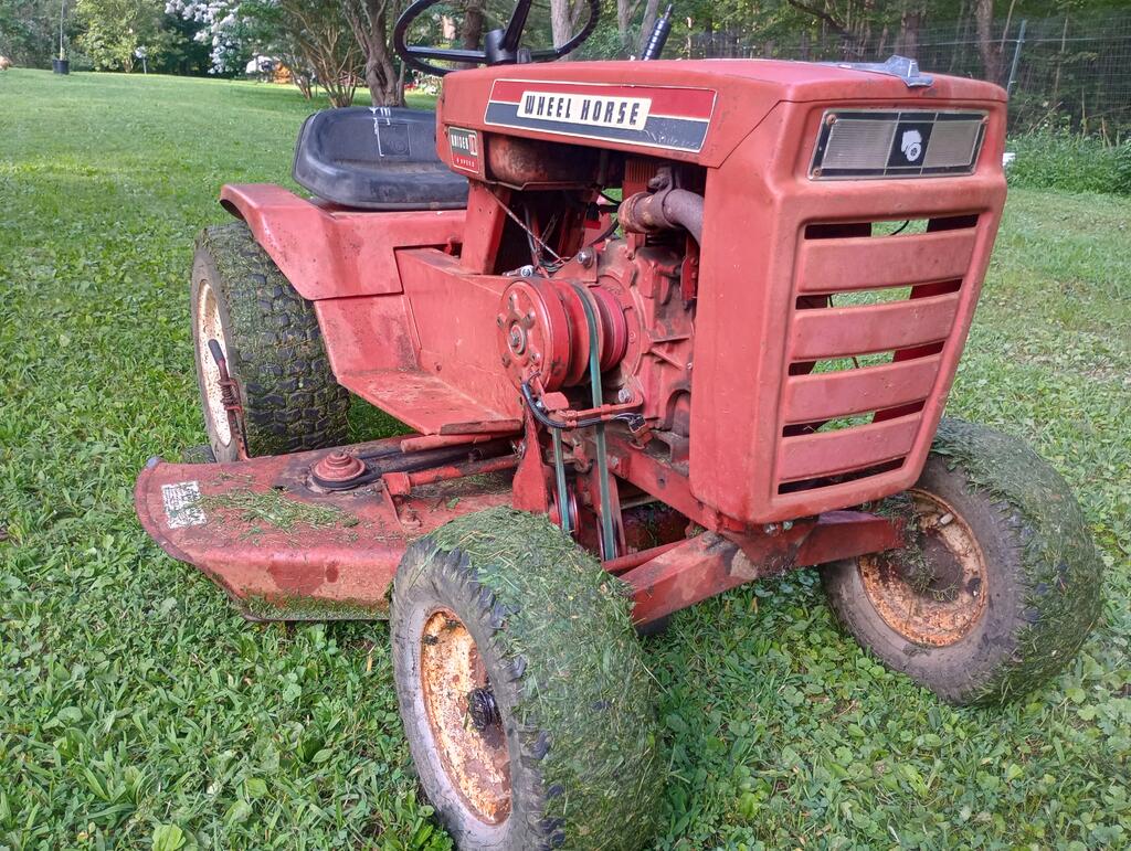

jsoluna 514 #1 Posted August 1, 2025 Hello all, First time poster here. Long time garden tractor enthusiast. Inherited a 1971 Raider 10 #10-0300 and will be reviving the unit this year completely mechanically. It was parked years ago due to a clutch issue. Since the electric clutch is NLA and hard to find used, we decided to rewind the clutch field coil, and successfully got the unit back to work! It's a real tank, and our first Wheel Horse. We would like to use it for a little of everything around the shop, most importantly for front blade work. I looked over the attachments guide in this forum and I see the part number is NLA for proper front blade for this unit. -What are our options here? -Do other series of blades interchange? -When looking for a used one what all would need to be included in order to make sure it will hook up properly to the Raider? Revival series began last week on YouTube: Website for all our business and projects (lots of Cub Cadet stuff): Soluna Garage 2 Share this post Link to post Share on other sites

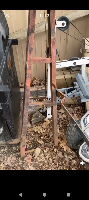

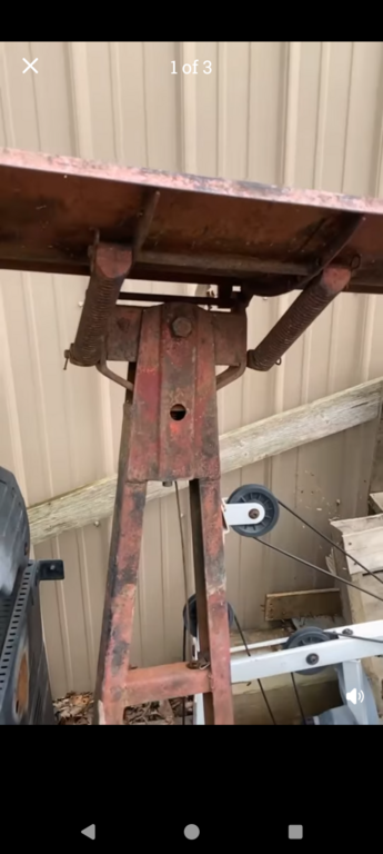

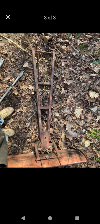

jsoluna 514 #18 Posted August 6, 2025 On 8/1/2025 at 10:04 AM, rjg854 said: looks like the guys have you covered. As you already know, people here are willing to help with any question you might have. The support on all three threads I've posted have been fantastic, thanks everyone. Great community, encourages us to learn and to be curious. Any input on what plow model this is? Looks like a 42", but aside from that I can't tell the difference between models. Does not come with axle brackets, so I'd have to source them (big deal, or no?) but the price is right. Should fit the Raider 10? 1 Share this post Link to post Share on other sites
gwest_ca-(File Mod) 12,321 #19 Posted August 6, 2025 Hard to tell if that one is for a short frame or long frame tractor. It does require the rear axle brackets that mount against the front of the axle housing and are outside the dozer A-frame. The later models use brackets that bolt to the bottom of the axle housing and are inside the dozer A-frame. 1 Share this post Link to post Share on other sites
Handy Don 16,914 #20 Posted August 6, 2025 (edited) 20 minutes ago, gwest_ca said: Hard to tell if that one is for a short frame or long frame tractor. It does require the rear axle brackets that mount against the front of the axle housing and are outside the dozer A-frame. The later models use brackets that bolt to the bottom of the axle housing and are inside the dozer A-frame. Definitely short frame. ’64 or maybe ’65, no later than ‘68? The ’63 was the first with the cast iron-capped springs but it still had the foot-operated quadrant release, while the one pictured has the bracket for the lever-grip release. BD-4264 or 6-4111 is my guess. Check for play in the blade pivot. If the blade was heavily used and the standard long-shoulder bolt was replaced with one having more threads, then the bolt and pivot socket likely have significant wear—not fatal, but less precise in use. Edited August 6, 2025 by Handy Don 1 1 Share this post Link to post Share on other sites
953 nut 67,217 #21 Posted August 6, 2025 10 hours ago, jsoluna said: Any input on what plow model this is? Looks like a 42", but aside from that I can't tell the difference between models. Keep on looking, that one is for a short frame (earlier model) you need the long frame grader blade. 10 hours ago, jsoluna said: The support on all three threads I've posted have been fantastic, thanks everyone. Great community, encourages us to learn and to be curious. Thank you, kind words are always appreciated. 1 Share this post Link to post Share on other sites

jsoluna 514 #23 Posted August 6, 2025 Thanks everyone. Looks like I'm back to the grind/hunt for a long frame blade. 1 Share this post Link to post Share on other sites

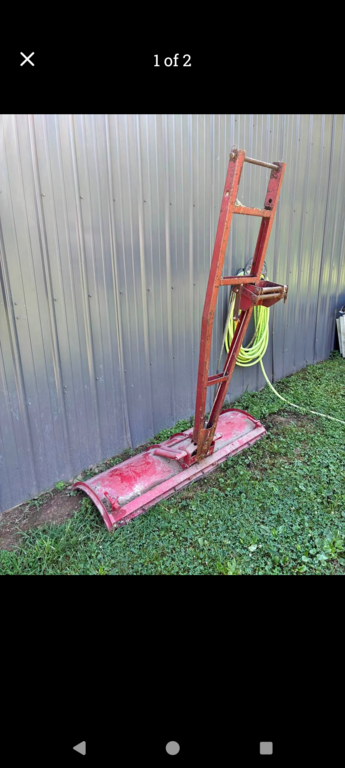

jsoluna 514 #24 Posted August 10, 2025 How about this one? It's about 30 miles from me. 1 Share this post Link to post Share on other sites
rjg854 13,154 #25 Posted August 10, 2025 That's what you're looking for Share this post Link to post Share on other sites
