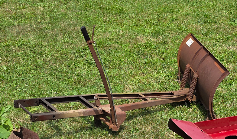

JR Pedersen 18 #8 Posted August 1, 2025 Does anyone know if this would work on my '68? If so what other parts would I need? Hard to tell from the Parts Diagrams. Share this post Link to post Share on other sites
JR Pedersen 18 #9 Posted August 1, 2025 It came off a 1974 D-200... Share this post Link to post Share on other sites
peter lena 9,940 #10 Posted August 1, 2025 @JR Pedersen what ever you get , be a great time / opportunity to do a function detailing on it , get a penetrating oil soak going on the entire unit , also hot sun really draws lubrication into metal , patina is result. get that plow up on 2 milk crates , one up front near steering quadrant , the other , rear of frame cross brace , roller stool , the squeeze lever spring is in the . swing arc of the plow , with lubrication and red aerosol spray grease , that unit will move with ease . also check out the plow WEAR STRIP , turn it over or replace it . done a number of those , like HITCH PIN CLIPS , on rear lever connection , pushed all the way thru to end open , area , that way they will not fall out . done a number of those , always oil the face of the blade for easy slide off , pete 1 Share this post Link to post Share on other sites
ri702bill 12,475 #11 Posted August 1, 2025 The D series implements do NOT interchange with any other series..... 1 Share this post Link to post Share on other sites
