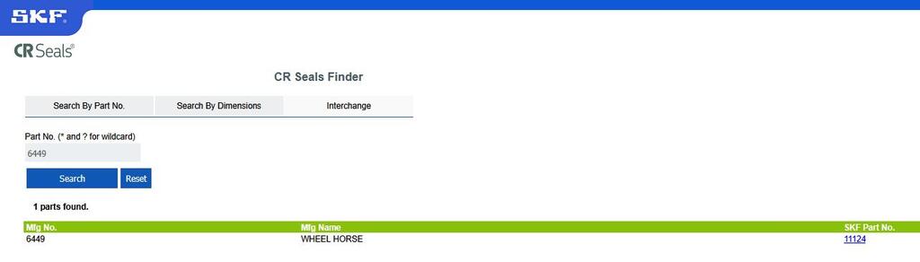

pfrederi 21,051 #5 Posted July 30, 2025 I have used CR 11124 for several hydros no issues. Share this post Link to post Share on other sites
