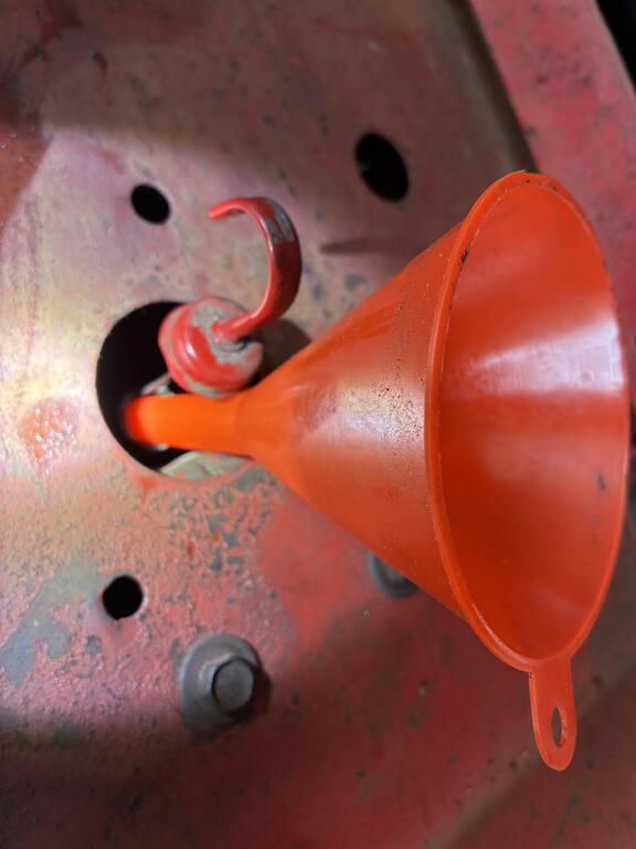

They don't make them like they used to but I'm surprised how much of a difference 2 years make. My 1975 C-160 has a steel filler/dip stick tube
 The 1977's is plastic. The 1975 has steel clips holding the dipstick. The 1977 has a rubber stopper that is so hard it's completely ineffective. I'm thinking that I'll replace it with a cork and hope that I don't lose the dipstick. The biggest difference (so far) is that the seat and rear fenders are hinged on the 75. The 77 seat flips up to reveal a hole that you can't really get your fingers through to check the oil level. The fenders are bolted down! They also changed the hitch so that the tow bar and the mount for a lift attachment are both incorporated. Not useful to me but I'm sure that those of you with a plow and a wagon would like it. All I've done so far is power wash the tractor. The amount of crap that came out from behind the panel was shocking! Change the transmission fluid and filter. If there is a vent for the transmission mines plugged because it took forever to fill it. Advise is always welcome!20250823_181918.jpg.23951714931a1f6eb7c420e30c2ded7e.jpg

Did you jack the front in order to fully drain the transmission?
There is no vent, you can carefully clean and remove a bolt for the seat support to vent while you fill.  If the one you remove doesn't go thru, remove another one.  Someone on here will know which one is best, I just use patience and add the oil over time.
  • Like 1

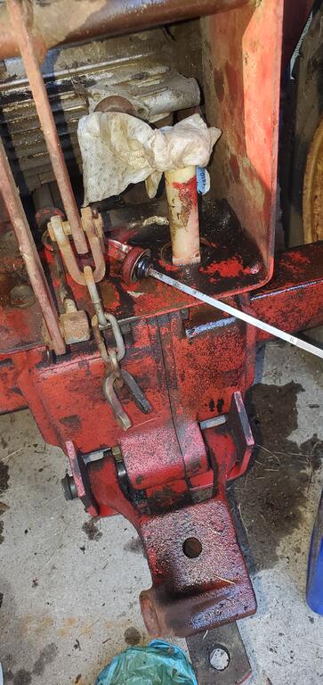

Handy Don
I’ve learned to fill using a funnel linked to a tube much smaller than the filler tube and long enough to almost reach the bottom of the transaxle. Yes, it takes a long time to fill but no “burping” of oil out of the filler.
Also, something to keep in mind with hydros is that when draining, a substantial amount of oil remains in the charge pump, motion pump/motor, and the plumbing to the lift valve and cylinder which is all but impossible to extract. I always measure the oil that came out when figuring how much to put in to avoid accidental overflow.

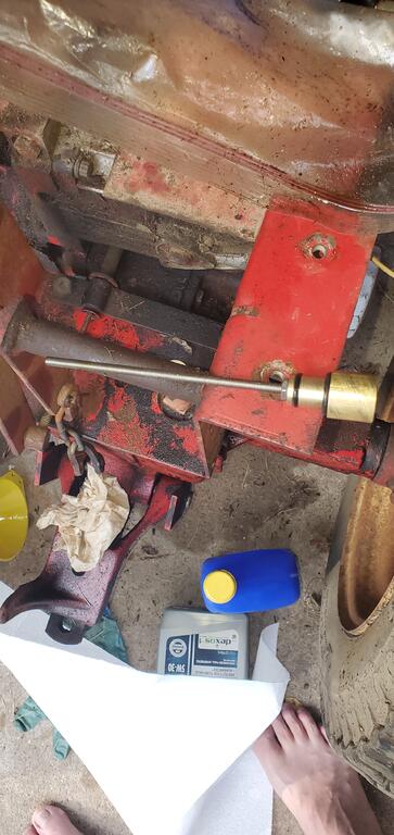

SylvanLakeWH
Here's how I filled mine. The dip stick created the perfect balance of air vent / oil in... slow and steady resulting in no spills.
  • Like 3
  • Excellent 1

I didn't think about it until just now but I have a vacuum pump I use to change the oil in my boat. I'm wondering if that would remove more of the transmission fluid?
The rubber in my dip stick is so hard that it will never seal so I made one.
  • Like 4

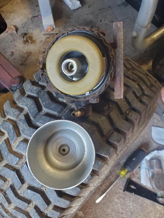

Started pulling apart this afternoon. I started with the carb. It was welded to the block. At least it seemed that way. It took a chisel and several blows from a jammer to break it loose. When I took the bowl off I was shocked at how clean it was. I don't remember when Ethanol was put in gas but I'm willing to bet that this one has never seen it
  • Like 2
  • Excellent 3
