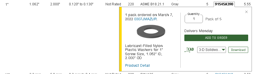

ebinmaine 81,282 #5 Posted July 25, 2025 2 minutes ago, 953 nut said: Transaxles with Eaton 1100 transmissions did have this thrust washer, though there are probably many that no longer have them if the hub was ever removed. They are in place to protect the axle seal from contacting the hub. You may be able to get them from TORO, or Parts Tree, TORO part # 106826 I would bet McMaster-Carr has them. And probably for Less money. 1 Share this post Link to post Share on other sites
JoeM 10,318 #6 Posted July 25, 2025 1 hour ago, ebinmaine said: I would bet McMaster-Carr has them. I used these with just a light lap in the ID with a die grinder. 3 Share this post Link to post Share on other sites
