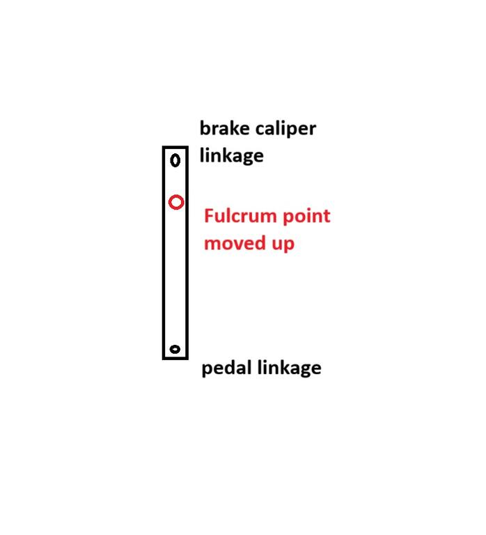

953 nut 69,321 #33 Posted August 11, 2025 27 minutes ago, Shed said: So I can't stop haha I'm going to mess around with the brake adjustment. If this manual brake doesn't work I'm ditching it and going to hydraulic You may want to rethink your brake linkage before spending money on a hydraulic setup. Pushing on a rod is probably allowing too much flexing to take place, If your rod was being pulled the tension would be applied to the caliper much better. Share this post Link to post Share on other sites

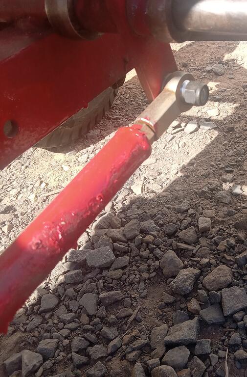

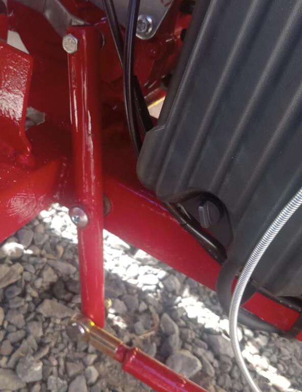

Shed 377 #34 Posted August 11, 2025 1 hour ago, 953 nut said: You may want to rethink your brake linkage before spending money on a hydraulic setup. Pushing on a rod is probably allowing too much flexing to take place, If your rod was being pulled the tension would be applied to the caliper much better. The linkage I 3/8 hemi joints to .5 8th inch wall tube then the z bar I upgraded to the same the only part that's not is the link between the z bar and the brake lever. The z bar is 12 inch with 6 inch center pivot. I'll send some pictures 1 Share this post Link to post Share on other sites

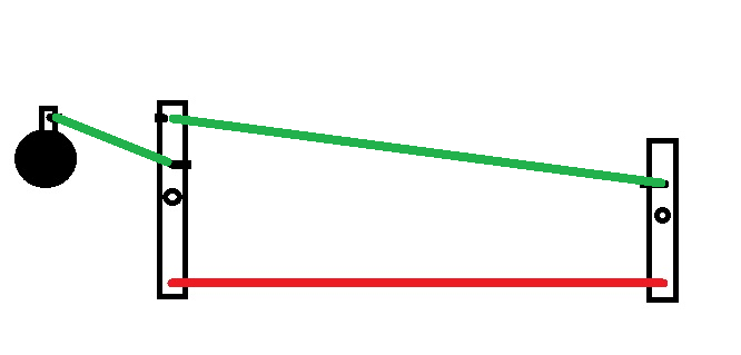

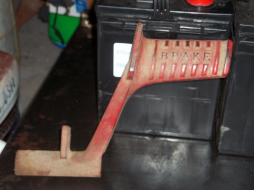

953 nut 69,321 #37 Posted August 11, 2025 Any play at the pivot points and linkage will have the effect of shortening the movement of your brake caliper arm. If you moved the rod above the pivot point I think it would work much better. You could use the brake pedal from ant eight speed to do this. 1 Share this post Link to post Share on other sites
wallfish 20,618 #38 Posted August 11, 2025 Yeah, probably best to keep all that linkage higher so it can't get caught on something like a rock and stop the tractor. But having them connected like this would add more mechanical leverage force to the bake 2 1 1 Share this post Link to post Share on other sites
Shed 377 #39 Posted August 11, 2025 54 minutes ago, wallfish said: Yeah, probably best to keep all that linkage higher so it can't get caught on something like a rock and stop the tractor. But having them connected like this would add more mechanical leverage force to the bake Thanks I see what your getting at here. It would take it from a push to pull. I even thought about extending the arm on the brake caliper to try and do away with the crazy link arm Share this post Link to post Share on other sites

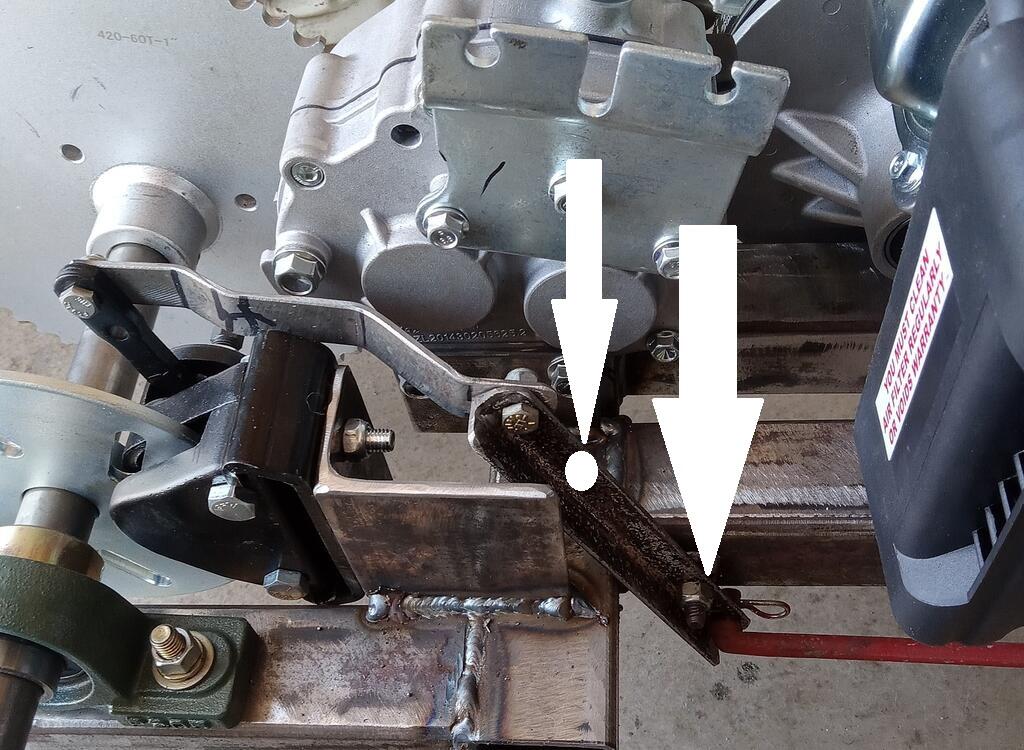

wallfish 20,618 #40 Posted August 11, 2025 27 minutes ago, Shed said: Thanks I see what your getting at here. It would take it from a push to pull. I even thought about extending the arm on the brake caliper to try and do away with the crazy link arm It's a fine line between the mechanical advantage and the distance to move the pedal Just went back and looked at your pics. If you can make a bracket to move that fulcrum point on the angle piece to gain the mechanical advantage it might be the easiest fastest solution. Share this post Link to post Share on other sites

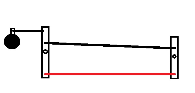

Shed 377 #41 Posted August 11, 2025 I went back to the instructions haha had to dig them out of garbage who reads them... so I adjusted them and they work but not great so maybe if I lower the top hole like that drawing and keep the bottom long that should help. Even used brass washers to smooth things out 1 Share this post Link to post Share on other sites
Shed 377 #42 Posted August 11, 2025 Crowbar method long handle piviot point short side pulls nails out perfect so if I go with that theory apply it to my z bar the top side connecting the caliper should be short then the bottom should be long should increase force. I'm thinking of making a hemi joint top link maybe help with 1 Share this post Link to post Share on other sites
wallfish 20,618 #43 Posted August 11, 2025 41 minutes ago, Shed said: top side connecting the caliper should be short then the bottom should be long should increase force Moving it half way down would double the amount of force applied to the caliper arm 1 Share this post Link to post Share on other sites
