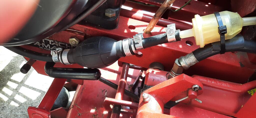

Ed Kennell 44,862 #3 Posted July 24, 2025 Add a marine primer bulb at a low spot in the fuel line. Two or three squeezes and you'll have instant starts. Your battery and starter will thank you. 2 5 Share this post Link to post Share on other sites

clueless 3,348 #8 Posted July 24, 2025 10 hours ago, Ed Kennell said: Add a marine primer bulb at a low spot in the fuel line. Two or three squeezes and you'll have instant starts. Your battery and starter will thank you. Do this first, it will cost you about $15, if it's still not starting then go from there. Even if this doesn't fix the problem you've made it to where it will start up four time faster than it use to once you've fix your problem. Best $12 to $15 improvement I've ever made on my rear tank tractors 5 Share this post Link to post Share on other sites

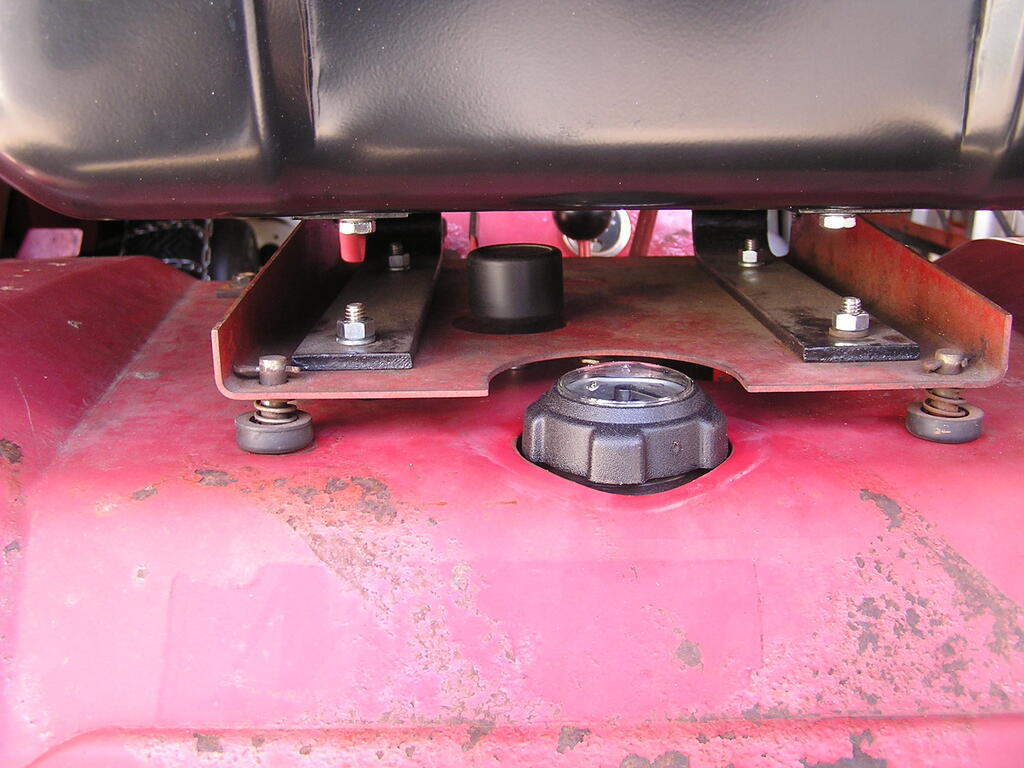

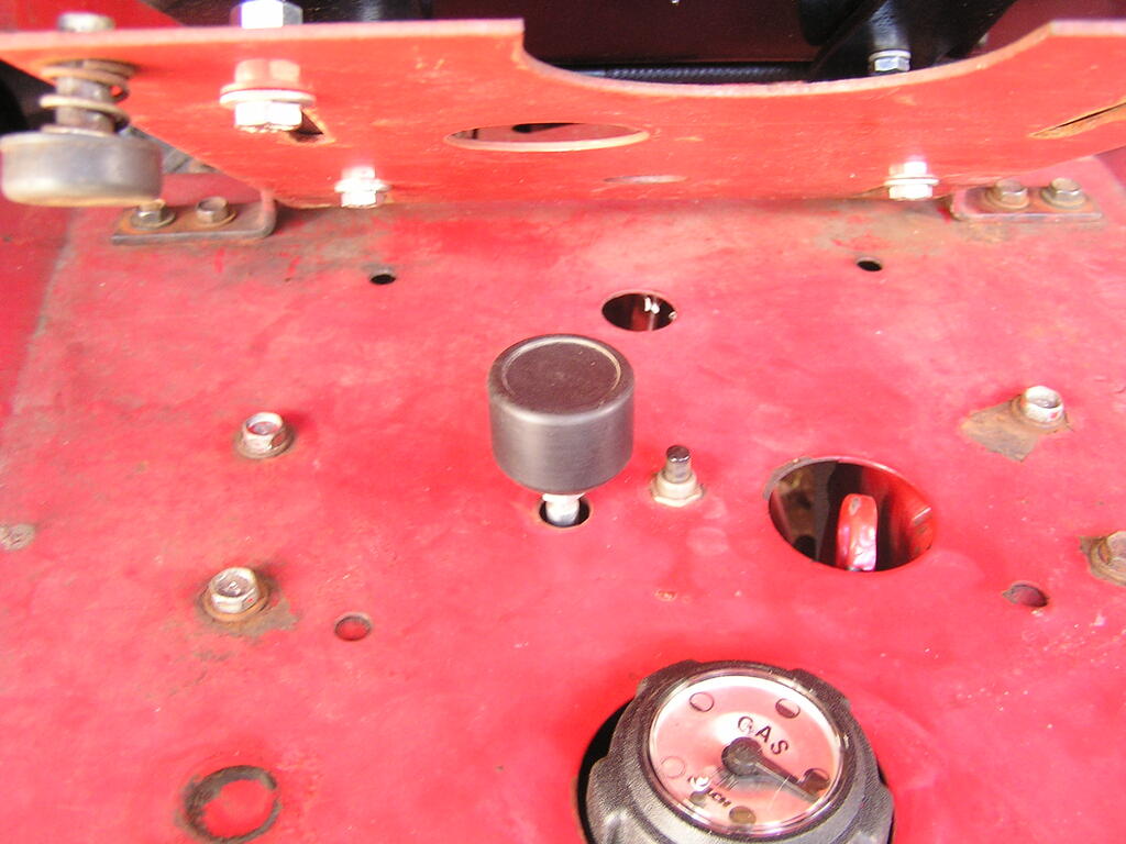

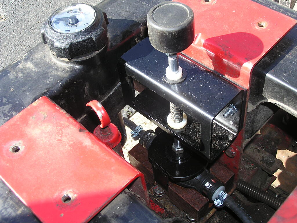

ri702bill 11,254 #10 Posted July 24, 2025 (edited) As I mentioned earlier, I added a Marine primer Bulb on the C81. I got ambitious and mounted it under the seat pan with a spring loaded rod & knob under the seat. Had all the materials in house, why not..... Edited July 24, 2025 by ri702bill 1 3 3 Share this post Link to post Share on other sites

ri702bill 11,254 #15 Posted July 24, 2025 Nope - purposely designed not to hit the underside of the seat. As @Handy Don said, flip up the seat, give it a couple of pushes, lower the seat, start it up. I did this to "protect" the fuel line & primer. Seen way too may installed out in the open just a-waitin' to get snagged on something.... 1 Share this post Link to post Share on other sites
