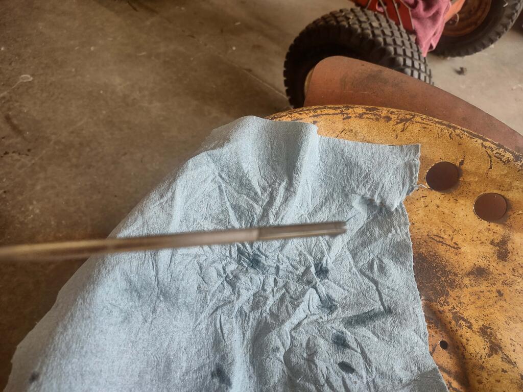

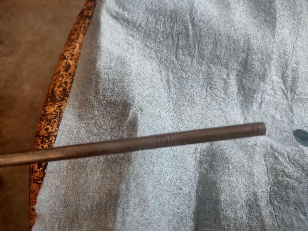

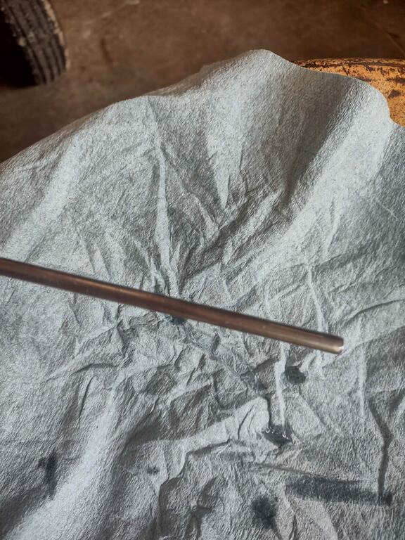

Achto 32,816 #1 Posted July 20, 2025 (edited) Was doing some oil changes today and was getting frustrated trying to read the new oil on the dip stick. I'm sure that others have had this issue as well so I thought that I would share my cure for this. First off a picture of what I am talking about. The picture below shows the dip stick right after I pulled it out of the engine. Hard to see but yes there is oil on it. The solution that I came up with was to sand blast the end of the dip stick. This made the oil level very easy to see. Next question, would this still improve things after the dip stick has been saturated in oil ??? The answer is, YES. Even after the dip stick has been saturated it is still easier to read. Hope this may be of some value to those of you out there. Edited July 20, 2025 by Achto 4 8 Share this post Link to post Share on other sites
