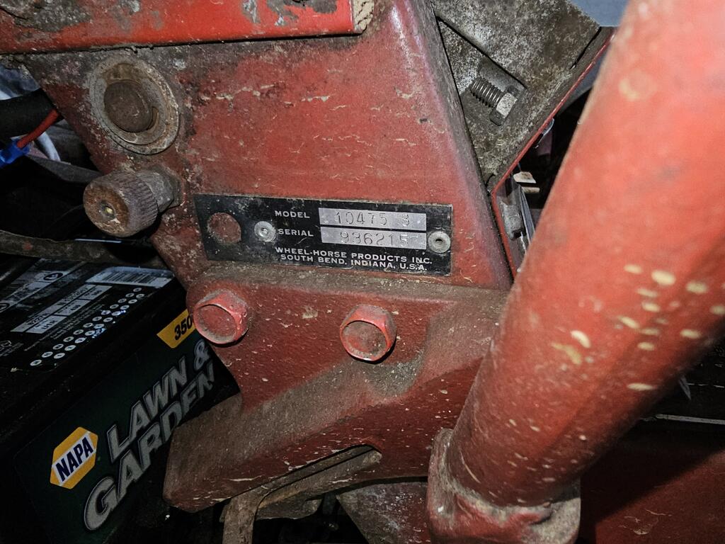

baymee 3 #1 Posted July 20, 2025 I am working on the model in the title. The pedal moves over a safety switch that appears to be a ball bearing which depresses and activates the safety switch. Anyone know availability and part number for that switch? Unrelated to electrical, and I may have to post in another section, I can't figure out how to freewheel this thing. I can't find any data tag to further ID this tractor. Share this post Link to post Share on other sites

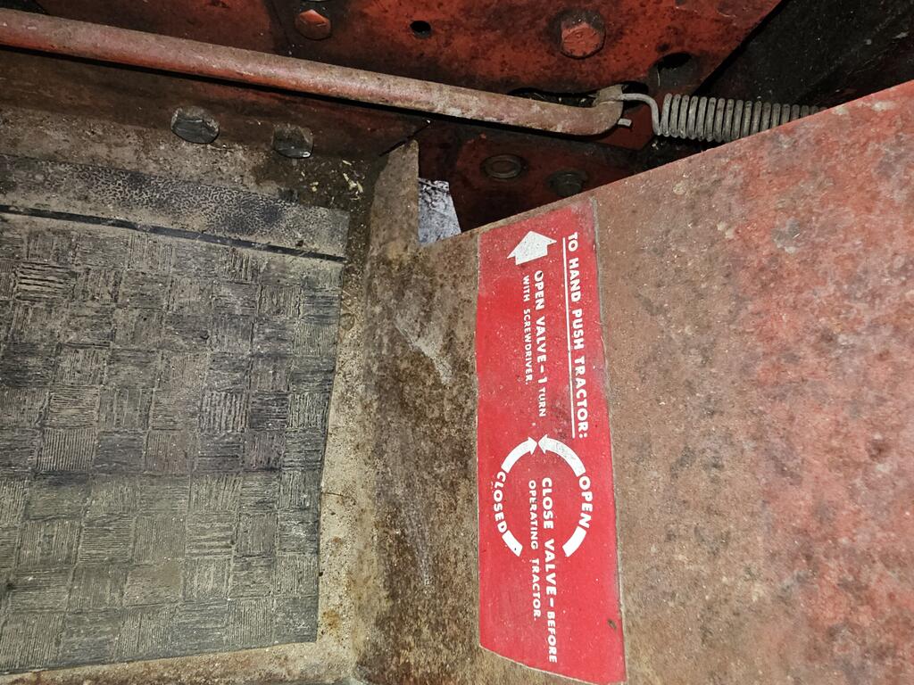

Ed Kennell 46,794 #2 Posted July 20, 2025 (edited) to the The ID plate should be below the console plate. If it is an automatic hydro transmission, it may be a 1972 Charger 10. The tow valve may be a TEE handled valve under the seat. Turn the valve 1/4 turn to be able to push the tractor. Edited July 20, 2025 by Ed Kennell Share this post Link to post Share on other sites

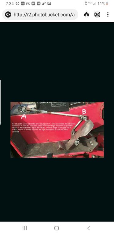

pfrederi 20,992 #5 Posted July 20, 2025 (edited) !/2 turn Long end to front as in picture drive ...aimed back tow Edited July 20, 2025 by pfrederi 2 Share this post Link to post Share on other sites

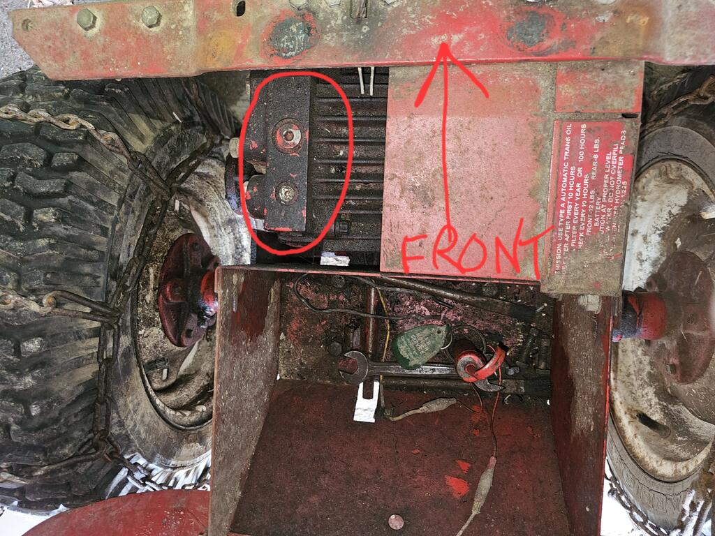

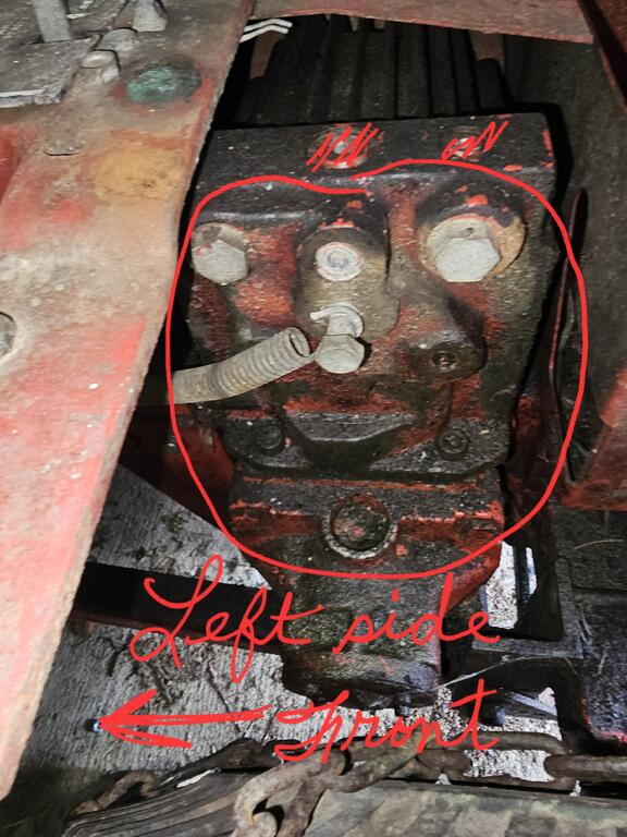

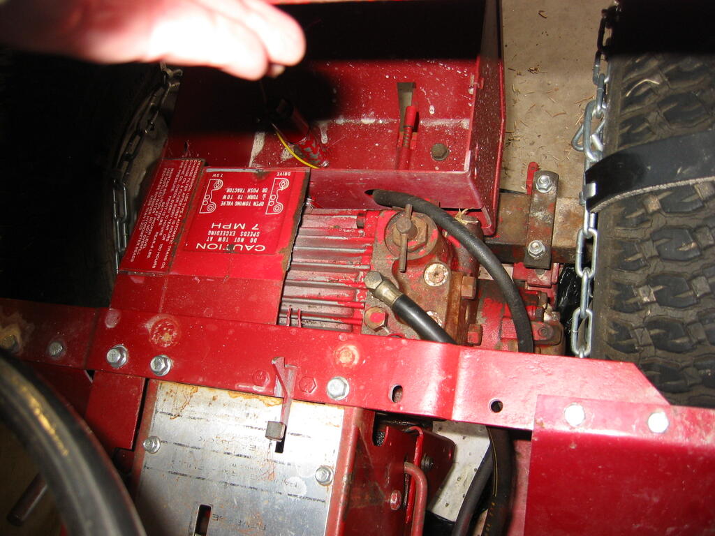

baymee 3 #6 Posted July 20, 2025 (edited) Top view. Two ports. Tried both. Side view. Tried them Data plate Sticker. I looked everywhere. There is no screwdriver hole in there. BTW. The tire pressures are up. Chains don't help. It goes one foot easy, the gets hard Edited July 20, 2025 by baymee Clarity Share this post Link to post Share on other sites
wallfish 20,380 #7 Posted July 20, 2025 Model Year Description Type Engine Model HP Drive Model 1-0475 1973 Lawn & Garden Tractor 10 HP Automatic Kohler K241S-46636D 10 Sundstrand 90-1136 Share this post Link to post Share on other sites

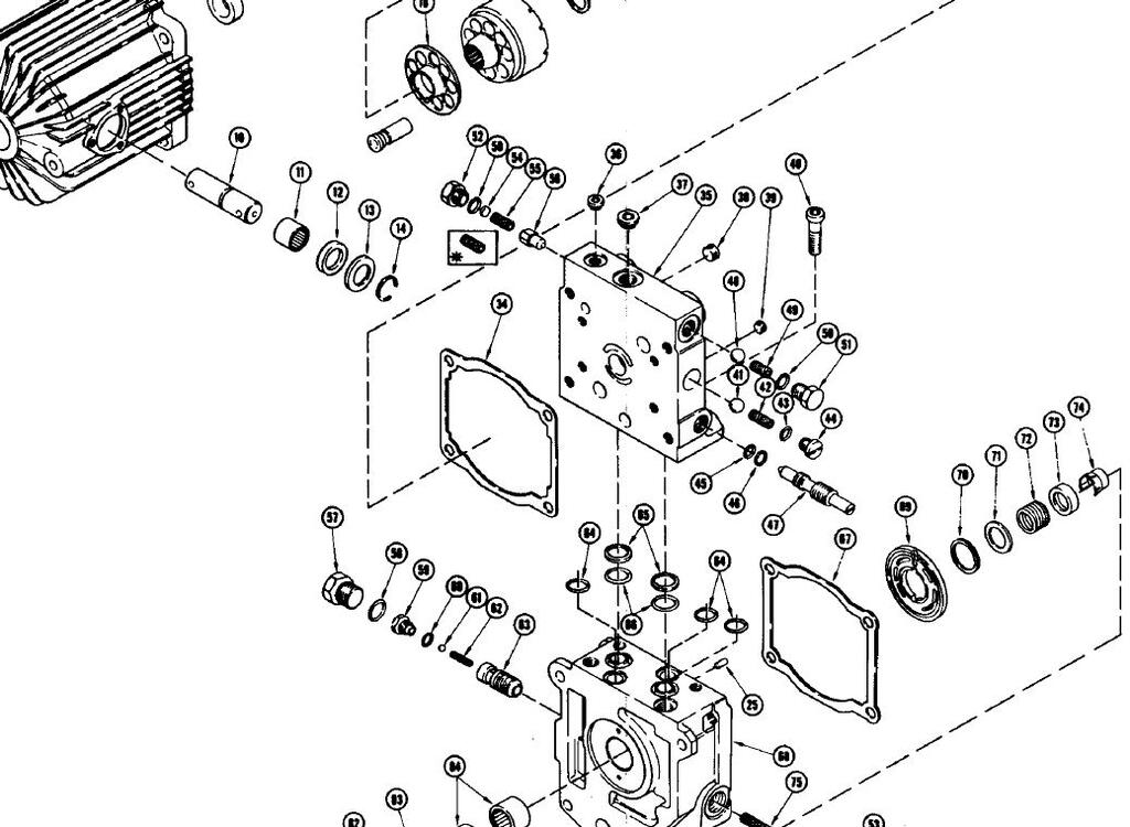

pfrederi 20,992 #8 Posted July 20, 2025 (edited) You have piston to piston Hydro. Tow valve is on the front of the pump. Just shaft with slot in the end for a screw driver. (#47) Edited July 20, 2025 by pfrederi 1 Share this post Link to post Share on other sites

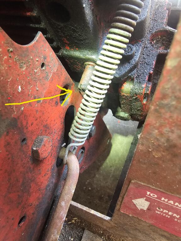

baymee 3 #9 Posted July 26, 2025 Wow was that relief screw in a hidden place and right in front of your eyes. The clutch pedal spring completely hides it. The clutch has to be held down to see it and to even get a screwdriver on it. You can barely see the screwdriver slot. As far as the ball detent switch, the ball doesn't get depressed enough to activate it. I thought I could shim it but then there isn't enough clearance for the pedal to pass by. A new one on order. Share this post Link to post Share on other sites
Ed Kennell 46,794 #10 Posted July 26, 2025 27 minutes ago, baymee said: The clutch pedal spring That does not look like a factory spring location. 3 Share this post Link to post Share on other sites

pfrederi 20,992 #16 Posted July 27, 2025 22 hours ago, Ed Kennell said: That does not look like a factory spring location. It is not, someone got really frustrated trying to install spring #1230 inside the hood stand and went an easier way 1 Share this post Link to post Share on other sites

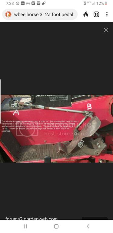

baymee 3 #17 Posted July 27, 2025 The owner went on to mowing heavenly pastures now. Regarding the Eaton transmission in my 312A....I bought it sometime in the late 90s. I live on a gentle mountain side and am constantly going up or down. The trans started fading when warm, to the point where it wouldn't move. I switched to 30W motor oil. That worked for awhile, then 50W, then 90W and finally 135W. Each worked for awhile. Then it cost me $800 for a new one. Put the old one in my barn. By the way, I have quite a few spare body parts for that 312 in my barn. Never will need them. Then I got sick of always moving the joystick because of the up/down terrain. And so i fabbed a foot pedal mechanism which is absolutely fabulous. 2 Share this post Link to post Share on other sites
