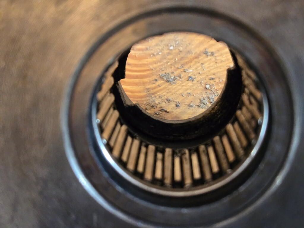

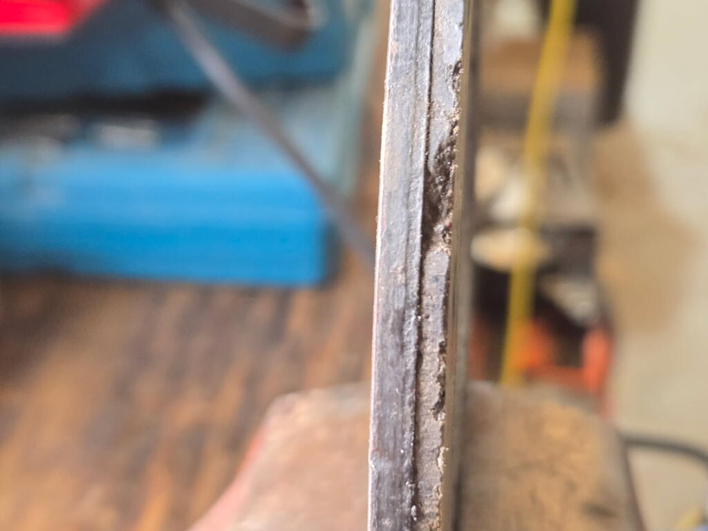

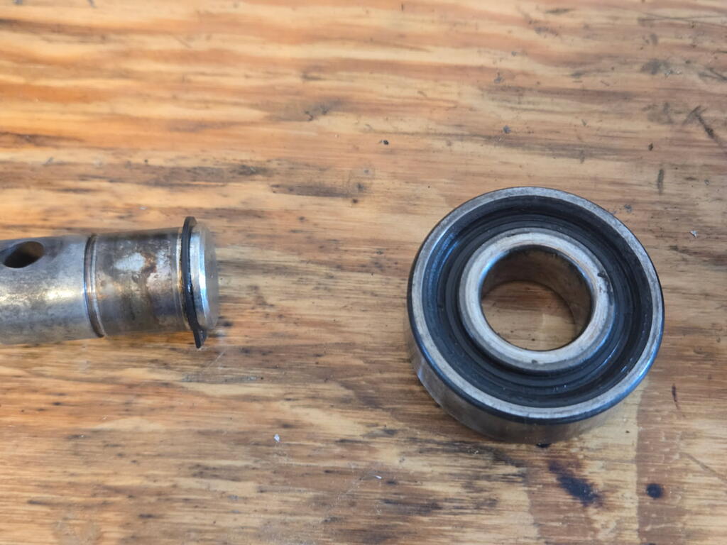

graywolf1939 29 #12 Posted July 20, 2025 I disassembled the PTO this morning and I noticed that the Clutch friction plate surface was in bad shape, only 3/32" thickness remained. I also noticed that the Seal (part number 6663) was missing; lost during disassembly a year ago for engine rebuild and never noticed during reassembly. All the other parts and bearings were in very good conditions, check the photos included in this reply. I will be ordering the missing seal 6663 and the Clutch Plate & Friction part number 103817 today. Share this post Link to post Share on other sites
