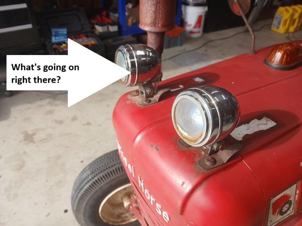

702854boy 398 #3 Posted July 19, 2025 I'm not sure what model we have. We just acquired an 854 yesterday morning and it has headlights on it but we don't know how to change the bulb or what type of bulb it takes. I'll try to get a photo of the assembly later. Share this post Link to post Share on other sites
702854boy 398 #4 Posted July 19, 2025 Here's the photo Share this post Link to post Share on other sites
rmaynard 16,771 #5 Posted July 19, 2025 I don't think they are a Wheel Horse part. 1 Share this post Link to post Share on other sites
wallfish 18,855 #6 Posted July 19, 2025 56 minutes ago, 702854boy said: Here's the photo Definitely not a WH part. Someone added them to the hood. The front opens up. Either a band holding them on, they're clipped on or they unscrew. 2 Share this post Link to post Share on other sites
702854boy 398 #7 Posted July 19, 2025 (edited) 20 minutes ago, wallfish said: The front opens up. Either a band holding them on, they're clipped on or they unscrew. I don't see a band around the circumference, i tried getting a small screw driver behind the seem to see if they were put together that way but I didn't have a small enough screw driver and I've tried twisting them to see if that's how they are held on but they don't budge or I just don't have a strong enough grip. Edited July 19, 2025 by 702854boy Share this post Link to post Share on other sites

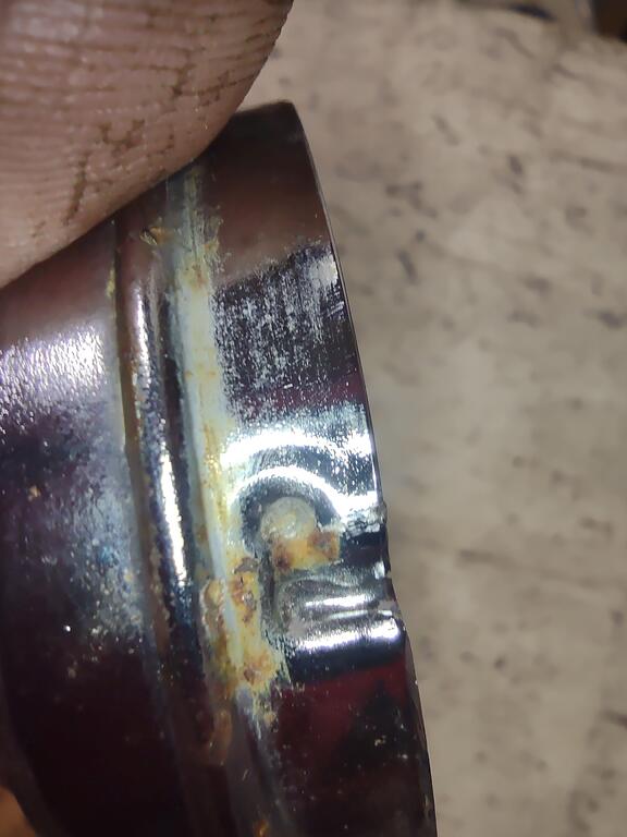

wallfish 18,855 #8 Posted July 19, 2025 (edited) Cant' tell from the pic but, Edited July 19, 2025 by wallfish 1 Share this post Link to post Share on other sites
702854boy 398 #9 Posted July 20, 2025 47 minutes ago, wallfish said: Cant' tell from the pic but, I think that's just reflection and oxidation on the chrome. Share this post Link to post Share on other sites

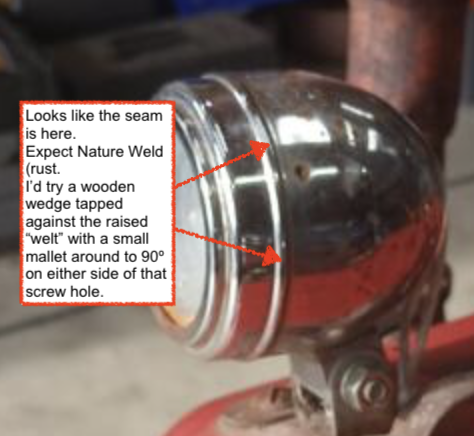

Handy Don 15,608 #10 Posted July 20, 2025 (edited) I’m withdrawing the suggestion of starting with the wood block -- see later posts that add important information. Edited July 20, 2025 by Handy Don 1 Share this post Link to post Share on other sites
squonk 45,062 #11 Posted July 20, 2025 8 hours ago, Handy Don said: That hole may indeed been where a screw held it together and it is indeed rusted stuck. Share this post Link to post Share on other sites

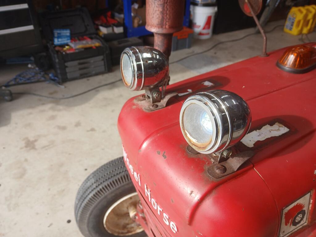

Achto 30,450 #12 Posted July 20, 2025 (edited) 11 hours ago, Handy Don said: I have a similar set of these lights on my Rat Rod. They are aftermarket motorcycle lights. Those dimples on the side are there for the cam lock on the ring. Check on the bottom side of the light for a screw. Don't remember, I may have installed a screw on mine to ensure that it would stay together. If it has one then remove the screw. You will then need to twist the front ring counter clock wise to remove it. This should be the style bulb that you are looking for. I used the LEDs on mine because I'm not running a charging system. https://www.menards.com/main/electrical/light-bulbs/specialty-light-bulbs/sylvania-reg-mr16-gu5-3-led-light-bulb/79129/p-1463764712040-c-642874317706876.htm?exp=false They are also available in halogen, I don't think that they are any brighter than the LEDs though. https://www.menards.com/main/electrical/light-bulbs/specialty-light-bulbs/feit-electric-reg-mr11-g4-halogen-light-bulb/bpq10mr11/p-1444430398199-c-642874317706876.htm The bulbs that I posted above should be available at your local hardware store. They are intended for 12v home lighting, so I would check in the home lighting section. Edited July 20, 2025 by Achto 2 Share this post Link to post Share on other sites
702854boy 398 #13 Posted July 20, 2025 I just went out and looked and there is not a screw on the bottom and I tried twisting the front ring off but the darn thing just won't budge. 1 Share this post Link to post Share on other sites
Achto 30,450 #14 Posted July 20, 2025 (edited) 2 hours ago, 702854boy said: I tried twisting the front ring off but the darn thing just won't budge. The ring does not twist very far. The dimples that you see on the out side form 3 small pins on the inside. These 3 pins fit into the grooves on the front ring for a cam-lock fit. I removed one of my rings so that you could see what goes on inside. Try soaking the ring down with some penetrating fluid and let it set for a while. Maybe it will work it's way in and help loosen things up. Edited July 20, 2025 by Achto 2 Share this post Link to post Share on other sites
Handy Don 15,608 #15 Posted July 20, 2025 (edited) 3 hours ago, Achto said: Try soaking the ring down with some penetrating fluid and let it set for a while. Maybe it will work it's way in and help loosen things up. Thanks for making that clear, @Achto! Also, @ebinmaine alway reminds us that if lefty-loosey isn’t working right a way, a little righty-tighty might be needed! Edited July 20, 2025 by Handy Don 2 Share this post Link to post Share on other sites
