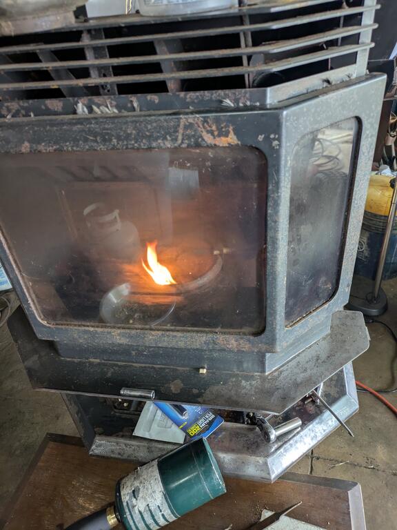

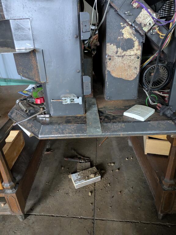

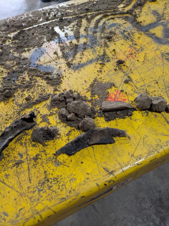

   I took a shop vac and added air to the burn pot and it went nuclear. That determined  either a weak exhaust fan or leaks that interfered with enough combustion air. Next I cleaned out the intake by jacking up the 300 pound stove and as you can see solid caked ash came out. I still have to replace the feed motor and check the connection fan,but progress is being made
   My Englander is just so much more simple. The air supply pushed through the fire pot and continues through the stove.At least now this thing by will hold a fire.I know the fire is not much, but the fire pit has to be full to keep the air doing it's jobl Once the red coals are built maybe the thing will put out some real heat.
    All that dirt you see came from the air intake with no chance this stove, a Quadrafire 1200 could hold and build a flame.
