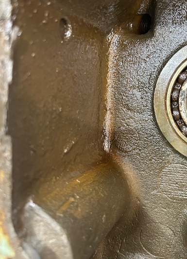

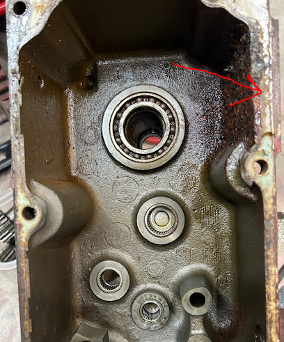

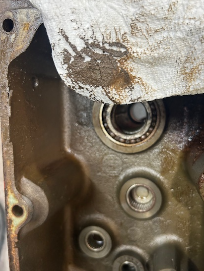

JoeM 10,269 #1 Posted July 16, 2025 Dug into the 8 speed with the hi lo shifter issue. Drained it and added 2 quarts of diesel. Ran it for 30 minutes up on stands. Drained it and removed the trans and opened it up. I scoped the case and of course can not see the top but what I seen looked pretty good. Looks like the flush loosed up some rust, and now there is a film of rusty residue all through the transmission. Made me wonder if it may have been better to just change the oil and leave the rust in place? IDK I don't think multiple flushes would have made much difference. Another note, I see the water was not coming in from the shifter but from under the seat mounting plate. I figure the gasket was not making up in that area and water that built up around the dipstick tube found it's way into the case. 1 Share this post Link to post Share on other sites
ri702bill 13,068 #2 Posted July 16, 2025 Joe - that bearing looks a mite rough.... does it and its cousin spin freely with no crunchy feel?? That rusted area at the top can be filled with either oil resistant RTV or good old Permatex #2 non-hardening gasket goo. 3 Share this post Link to post Share on other sites
ebinmaine 80,741 #3 Posted July 16, 2025 How long had this transmission set without being used? A friend and I have discussed similar questions about truck axles. Same general situation. Their thought was the ONLY right thing to do is dismantle and clean out and rebuild. I can see the logic there. Rust + bearings = bad 3 Share this post Link to post Share on other sites

JoeM 10,269 #5 Posted July 16, 2025 10 minutes ago, ri702bill said: that bearing looks a mite rough Yep needs replaced. Plus the outer one will need done too. this started as being stuck in low range. the gearoil that was in the case was not to bad looking. I don't know if it was changed before I got the machine. (machine was picked up at the big show, I have no history) When I ran the machine the transmission shifted good and was quiet. Turning the axle by hand it was real smooth. No indication of bad bearings or rust problem. 16 minutes ago, ebinmaine said: right thing to do is dismantle and clean out and rebuild I am thinking the same. If there has been water in the case and the oil is rusty, taking apart clean and repair is the best way to go. The handful of these cases I have taken apart have some rust on the inside top of the case. It is a shame the cases are not coated inside like the hydro cases. I know these are splash lubed and the lube must not fling up to the top of the case to keep it coated. Makes you think 10w-30 would sling better give coating to the case to help with the rust. The gearing really doesn't need extreme pressure lube as there is nothing special in these cases, pretty straight forward. The hydro cases use the same gear types and last a long time on motor oils. Just thinking out loud. 1 Share this post Link to post Share on other sites

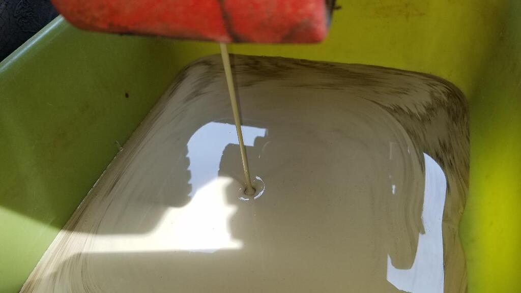

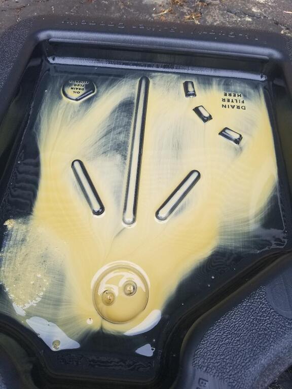

Brockport Bill 2,478 #7 Posted July 17, 2025 rescued an abandoned C165-8 tractor with gear tranny that had sat outside for few years and had bad shift boot - - took me 3 kerosene flushes before i finally got clear waste pan fluid -- then put in the new gear oil -- Not sure what the inside of tranny looked like before or after flushes -- but at least the last drips or flush finally was clear -- here is what some of the first two flushes looked like -- ugh !! 2 Share this post Link to post Share on other sites
kpinnc 18,969 #8 Posted July 17, 2025 8 hours ago, JoeM said: The handful of these cases I have taken apart have some rust on the inside top of the case. It is a shame the cases are not coated inside like the hydro cases. I agree with that. It always surprised me how much rust in the top of the case would show up even when no other water intrusion was evident. Of course the condensation issues down here in the south are always a challenge. Seems like a good coat of rust inhibiting paint would definitely help out on these. I don't recall what the paint was called that hydros always have in them, but the manual calls for thier use. Wonder if the stuff is even still available? 1 Share this post Link to post Share on other sites
