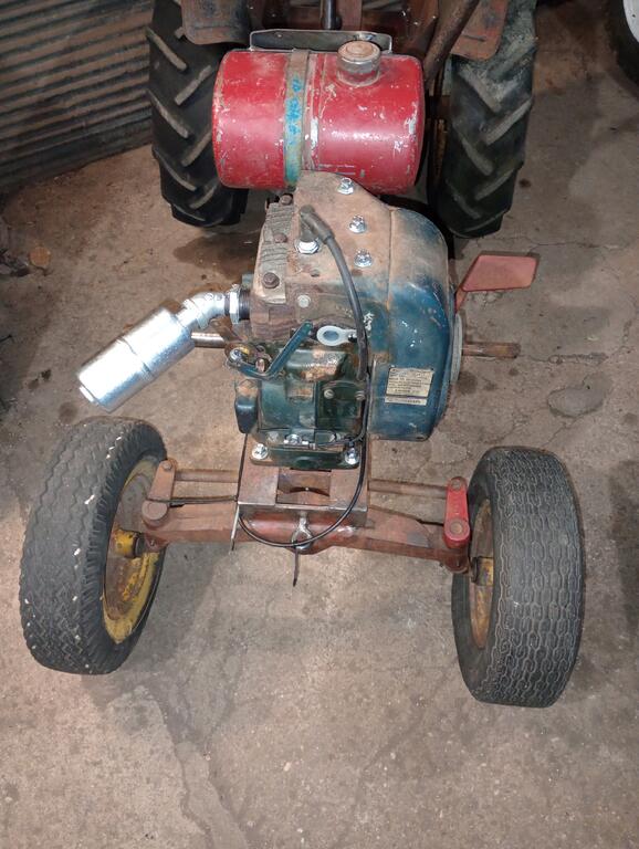

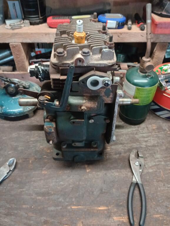

Chrishar 1,054 #26 Posted July 20, 2025 Working on fixing and cleaning the motor its not the right motor but it will work for right now it's a 8hp not a 7hp 1 1 Share this post Link to post Share on other sites
rjg854 13,360 #27 Posted July 21, 2025 8 or 7 still the same block just a different bore. 2 Share this post Link to post Share on other sites
kpinnc 18,967 #28 Posted July 21, 2025 4 hours ago, Chrishar said: Working on fixing and cleaning the motor its not the right motor but it will work for right now it's a 8hp not a 7hp No one will ever know the difference. Share this post Link to post Share on other sites

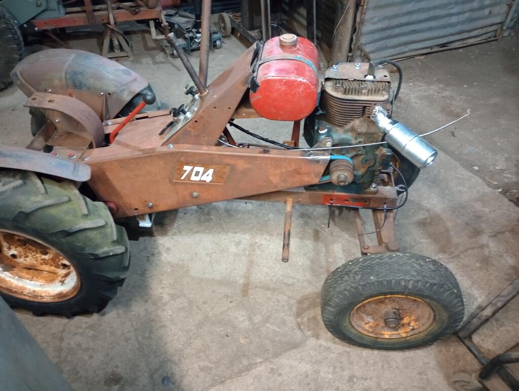

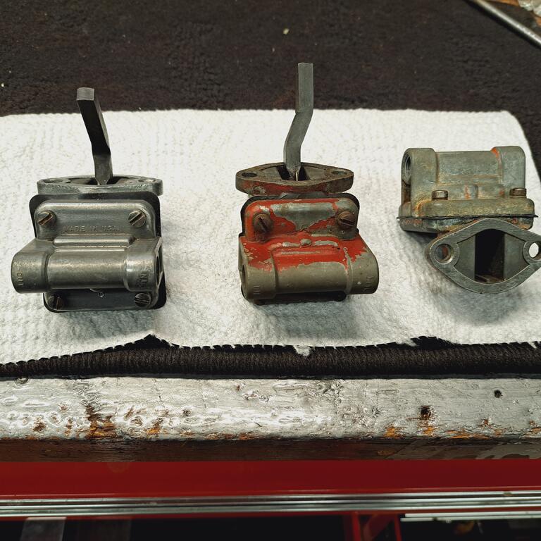

Chrishar 1,054 #29 Posted July 23, 2025 Work a little on the 704 got the motor bolted on and some other stuff put on too have a question does it used a fuel pump on the motor or not 1 Share this post Link to post Share on other sites
kpinnc 18,967 #30 Posted July 23, 2025 6 minutes ago, Chrishar said: question does it used a fuel pump on the motor or not Even though the fuel tank is mounted pretty high, a fuel pump of some type works best. It will keep the fuel supply consistent in the least. Kohler mechanical pumps are pretty good. You can't go wrong with the correct OEM pump for that engine. Electric pumps are good if you get a high quality version, but the hard part is finding a decent one with the correct pressure. 1 or 2 psi works best, and too much pressure can force fuel into the crankcase which will destroy the engine. Share this post Link to post Share on other sites
Chrishar 1,054 #31 Posted July 23, 2025 Thanks for the information Share this post Link to post Share on other sites
Chrishar 1,054 #32 Posted July 23, 2025 Drive belt and guard and engine pulley are done I put a temporary 704 sticker on for now 5 Share this post Link to post Share on other sites
WHX?? 58,143 #33 Posted July 23, 2025 (edited) 8 hours ago, Chrishar said: does it used a fuel pump on the motor OEM depends on the the spec. If a service motor probably not. One was to use the pump off the old motor. Wouldn't hurt to have one but most likely would need a vacuum style or the type with the offset lever. Edited July 23, 2025 by WHX?? 3 Share this post Link to post Share on other sites
Handy Don 17,474 #34 Posted July 23, 2025 On the round hoods, the tank is just about even with the carb. On my ’68 LR with a Tecumseh, there was no fuel pump so once the fuel level got to about ¼ tank, going up a decent pitch would starve the engine–my signal to refill the tank! 1 Share this post Link to post Share on other sites
squonk 48,126 #35 Posted July 24, 2025 On 7/23/2025 at 10:45 AM, Handy Don said: On the round hoods, the tank is just about even with the carb. On my ’68 LR with a Tecumseh, there was no fuel pump so once the fuel level got to about ¼ tank, going up a decent pitch would starve the engine–my signal to refill the tank! Yup. My 704 had a bad pump and about a 1/4 tank it would quit. 1 Share this post Link to post Share on other sites

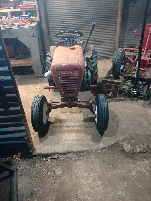

Chrishar 1,054 #36 Posted August 4, 2025 Got it running and driving today and it did really good I'm glad I save it from a graveyard will put more pictures when I put new shoes on it tomorrow night 2 1 2 Share this post Link to post Share on other sites

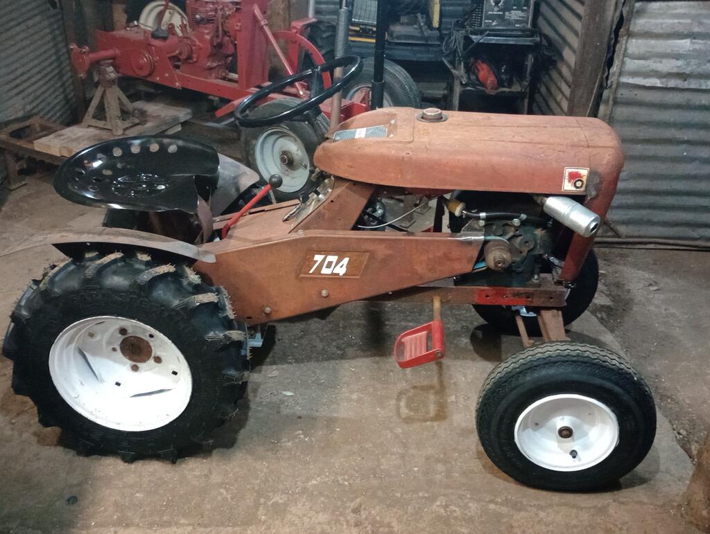

Chrishar 1,054 #37 Posted August 6, 2025 704 is back from its grave with new shoes it runs and drives good thanks for following me on this project will put some pictures of it when I paint it this winter 1 7 Share this post Link to post Share on other sites
rjg854 13,360 #38 Posted August 6, 2025 Paint it That looks perfect the way it is, after all it is a survivor, buff that out and give it a clear coat. 1 Share this post Link to post Share on other sites
Pullstart 71,256 #39 Posted August 7, 2025 @Chrishar it’s looking great? I’m vote for no fuel pump needed. Putting Putt my 502 has run for 12 years with no fuel pump and no fuel issues. Share this post Link to post Share on other sites
953 nut 69,341 #40 Posted August 7, 2025 On 8/5/2025 at 11:18 PM, Chrishar said: thanks for following me on this project will put some pictures of it when I paint it It's only original once, don't even clear coat it, just celebrate the patina. 1 Share this post Link to post Share on other sites
