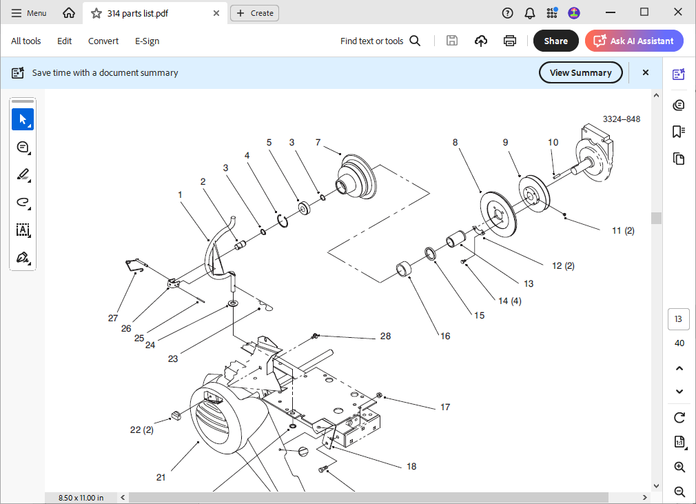

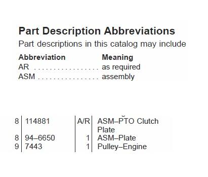

terc 24 #5 Posted July 15, 2025 (edited) Edited July 15, 2025 by terc item # 9 is listed as the asm plate which I need to remove to replace the crankshaft seal Share this post Link to post Share on other sites

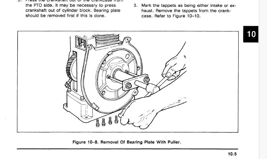

oliver2-44 11,212 #9 Posted July 15, 2025 8 hours ago, pfrederi said: Crank Seal maybe bearing plate??? Manuals can be helpful Just an FYI, if you are replacing the seal on the flywheel side, the aluminum bearing plate does not need to be removed. 7 hours ago, terc said: As mentioned, if you have removed 13 and 8 you can put some heat on the pulley. Check the set screw holes and make sure there was not a 2nd set screw in each hole. Also, you will break that pulley if you are just using a 3 jaw puller. Go to your local auto supply and borrow a bearing separator and puller. Share this post Link to post Share on other sites
8ntruck 8,601 #10 Posted July 16, 2025 @terc - are you trying to remove the part in the upper right hand corner of the diagram that looks like it is labeled as 3324-848? That is technically not part of the PTO clutch. I think it is a crank seal retainer. Anyhow, the PTO clutch plate #8 and drive pulley #9 will need to come off. As @oliver2-44 points out above, make sure the set screws are out of the pulley. There might be 2 set screws in each of the tapped holes, and there might be 2 set screw holes in the hub of the pulley. The pulley might be 'glued' onto the crankshaft with rust. Pennetrating oil, heat, and a puller are going to be your friends in this project. If I remember correctly, the drive pulley is a casting. Direct hammer blows on the pulley can create undesirable results. I've never been this deep into this side of a K series. I would expect that the seal retainer plate has a gasket that might stick it to the block after the bolts are removed. A putty knife and careful prying will probably break it loose from the block. Good luck. Share this post Link to post Share on other sites

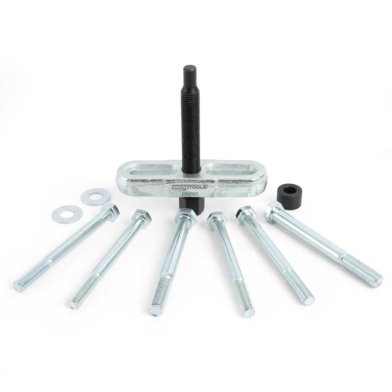

kpinnc 17,149 #11 Posted July 16, 2025 (edited) I would not use a 2 or 3 jaw puller. That pulley is cast iron and will break if a puller is used on the thin outer parts. You can use a steering wheel puller and thread it into two of the 1/4x20 holes on the face of the pulley. It's likely a good idea to fully remove the setscrews and squirt a very good penetrating oil (Kroil is the best I've ever used) for a day or so. Also as has been said a little heat won't hurt. After you remove the PTO inner race (part 13 on the diagram), clean the exposed PTO shaft with some light sandpaper. It'll make pulley removal easier as well. Do not strike the pulley or crankshaft, or flywheel. Ever. On reinstallation, a blob of anti-sieze on the keyway and PTO shaft will help any future removals. Edited July 16, 2025 by kpinnc 4 Share this post Link to post Share on other sites

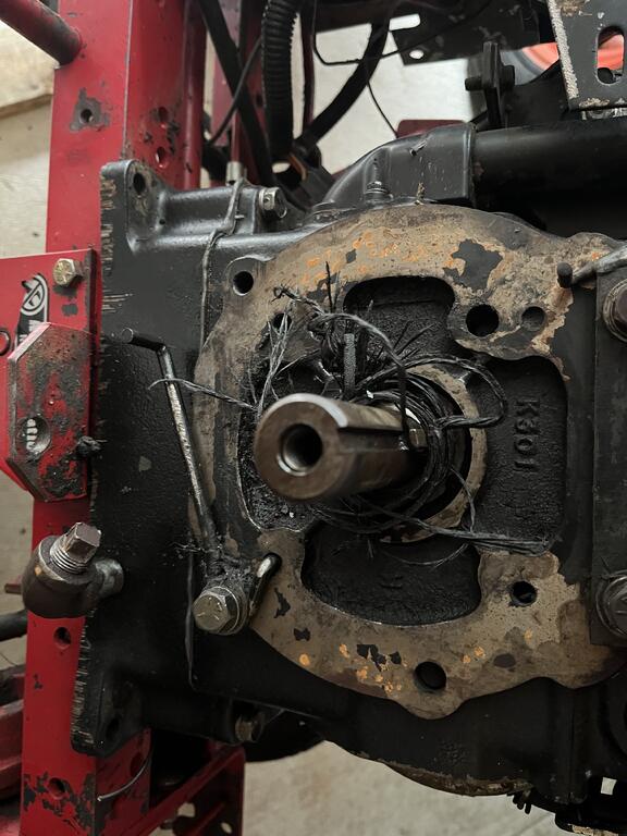

terc 24 #12 Posted July 16, 2025 Thanks for all of the replies to my problem, I am glad to report that the PTO clutch plate was removed after soaking it with Free All fluid. There was not enough room behind the plate, so I could not use a bearing separator. I used a modified center bolt in the end of the crankshaft to center my 3 jaw puller. The previous owner was correct in saying not to run this engine, here is what I found. I can say that I have never seen a seal that destroyed. Any ideas as to what may have caused this?? 1 Share this post Link to post Share on other sites
8ntruck 8,601 #13 Posted July 16, 2025 I don't think that is the seal. Looks more like bailing twine to me. Probably was trash laying on the ground and one of the belts snatched it up and fed it onto the crank shaft. Happened in the blink of an eye. Had a similar mess in one of my mowing decks many, many years ago. 2 1 Share this post Link to post Share on other sites
kpinnc 17,149 #14 Posted July 16, 2025 15 minutes ago, 8ntruck said: I don't think that is the seal. Looks more like bailing twine to me. Probably was trash laying on the ground and one of the belts snatched it up and fed it onto the crank shaft. Happened in the blink of an eye. Definitely not the seal. 2 Share this post Link to post Share on other sites
lynnmor 8,623 #15 Posted July 16, 2025 Could be the remains of a shredded belt. 1 1 Share this post Link to post Share on other sites
terc 24 #16 Posted July 16, 2025 thanks for the input, however someone was there before me because the crankshaft seal is completely gone. Share this post Link to post Share on other sites
