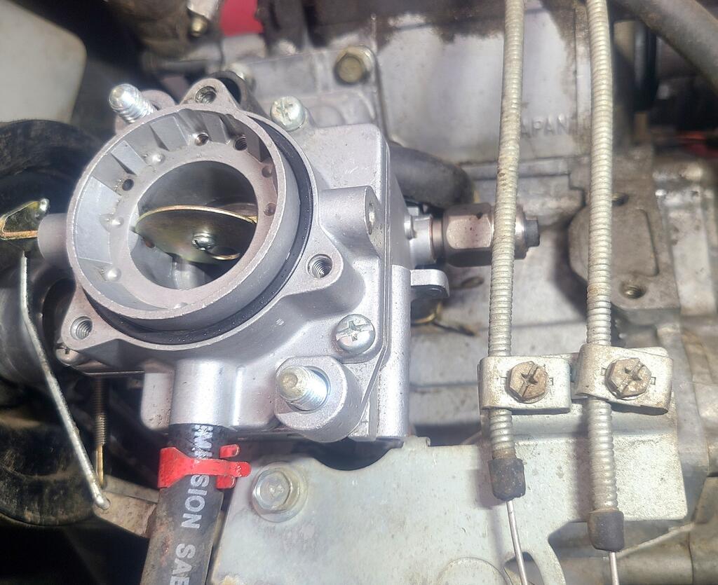

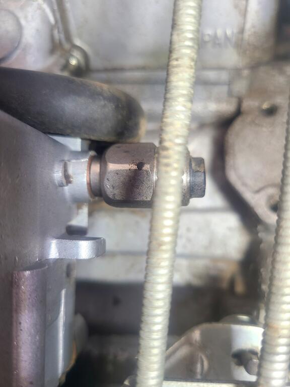

Shuboxlover 490 #1 Posted July 13, 2025 I was helping dad mow the other day with his 520Lxi...was mowing right along then all of a sudden it just died and wouldn't start again, machine only has 565 hrs on it. I got it to my shop and did some trouble shooting, it has spark and is getting fuel to the carb (disconnected the fuel line going into the carb and the fuel pump is working) It will run for a second or two if I put a little fuel down the carb but then dies. I don't know a TON about the engines in these but I started to take things apart and noticed this....am I correct to think that this is a solenoid? and is there supposed to be a wire going into it? Any help would be GREATLY appreciated!!! Thank you all Tyson Share this post Link to post Share on other sites
gwest_ca-(File Mod) 12,505 #2 Posted July 14, 2025 The wire going from the tractor to the engine connector is yellow for the fuel solenoid. It is also wired to the ignition module. The wire colors engine side of the connector are unknown. Most likely 6 wires in the engine connector. Color diagram here Share this post Link to post Share on other sites
Shuboxlover 490 #3 Posted July 14, 2025 Thanks....can the wire be reattached or is the solenoid done? Share this post Link to post Share on other sites
gwest_ca-(File Mod) 12,505 #4 Posted July 14, 2025 I would try it even if one had to try and solder a wire to what is left of the terminal. Have never had one out but have read that you can remove the solenoid and cut the valve off to get you going. 1 Share this post Link to post Share on other sites
Handy Don 17,546 #5 Posted July 14, 2025 10 minutes ago, gwest_ca said: I would try it even if one had to try and solder a wire to what is left of the terminal. Have never had one out but have read that you can remove the solenoid and cut the valve off to get you going. The solenoid valve is there to shut off drawing fuel into the carb throat (NOT the bowl) as soon as the engine is turned off. It’s there to reduce emissions. Needs power to open! 1 Share this post Link to post Share on other sites

Handy Don 17,546 #10 Posted July 14, 2025 1 hour ago, Shuboxlover said: Can I just remove it and plug it? Please post a picture of it when you have it out Share this post Link to post Share on other sites

Handy Don 17,546 #13 Posted July 15, 2025 Is this the valve? If so, plugging it doesn’t seem like it’d work. Here the fuel flows through the threaded end. Share this post Link to post Share on other sites
