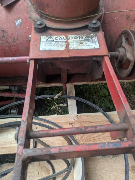

FarmallFarmer09 31 #26 Posted July 13, 2025 Doesent have the bar under it Share this post Link to post Share on other sites

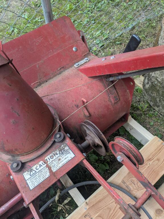

FarmallFarmer09 31 #27 Posted July 13, 2025 Also noticed this cord doesent look original Share this post Link to post Share on other sites

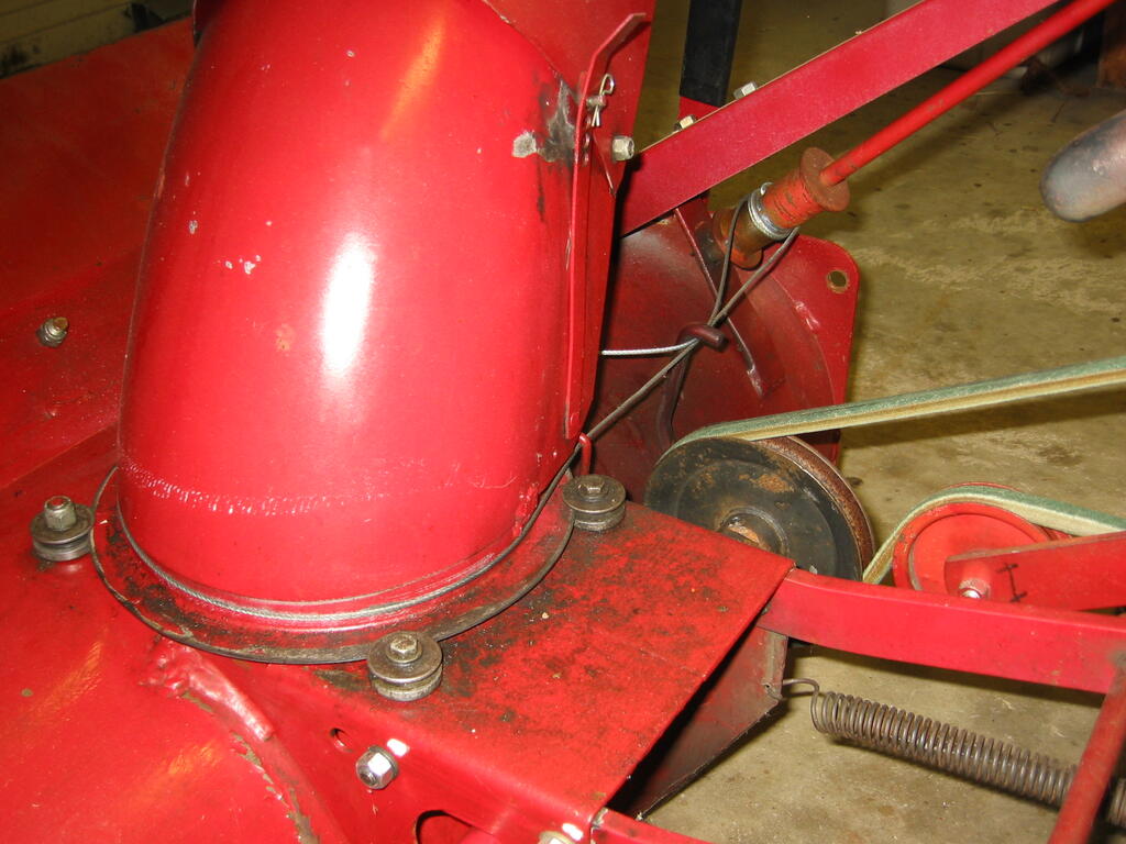

gwest_ca-(File Mod) 12,557 #28 Posted July 13, 2025 That is called the lift tube and what we call a flag is connected to the attachment lift. It forces the tube forward which causes the snowthrower to lift. In that poor picture above the tube is upside down where it connects to the snowthrower. They even published a service bulletin making owners aware that the tube was shown installed incorrectly. Share this post Link to post Share on other sites
FarmallFarmer09 31 #29 Posted July 13, 2025 6 minutes ago, gwest_ca said: That is called the lift tube and what we call a flag is connected to the attachment lift. It forces the tube forward which causes the snowthrower to lift. In that poor picture above the tube is upside down where it connects to the snowthrower. They even published a service bulletin making owners aware that the tube was shown installed incorrectly. okay. Ill try to find one. Share this post Link to post Share on other sites
pfrederi 21,342 #30 Posted July 14, 2025 The thin cable to turn the shoot is factory. The Thin rod that turns it make this an older Blower. Later ones had a thicker rod. Share this post Link to post Share on other sites
