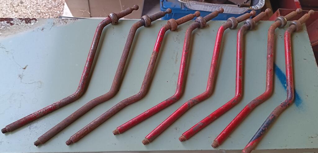

ebinmaine 81,282 #2 Posted July 12, 2025 6 hours ago, Axehund said: appears I have a broken roll pin that holds the donut to the stick. I’m sure I could source a pin but I’m wondering it I could take it out, clean and line it up and weld it in place. Is the donut weldable steel? It looks like it probably is but I don’t have it out yet. Anyone weld one? Not sure if it could be..... I've seen a few welded ones so I'd say give it a go. If nothing else I have about half this assortment left!! 1 Share this post Link to post Share on other sites

wallfish 20,744 #7 Posted July 13, 2025 Yes, they can be welded. 2 or 3 of them in the pic EB posted are welded. You could also find a new roll pin at just about any hardware store or online 2 Share this post Link to post Share on other sites
ebinmaine 81,282 #8 Posted July 13, 2025 9 minutes ago, wallfish said: Yes, they can be welded. 2 or 3 of them in the pic EB posted are welded. You could also find a new roll pin at just about any hardware store or online I've seen quite a few over the years. I wonder if welding was commonplace at one point. Share this post Link to post Share on other sites
