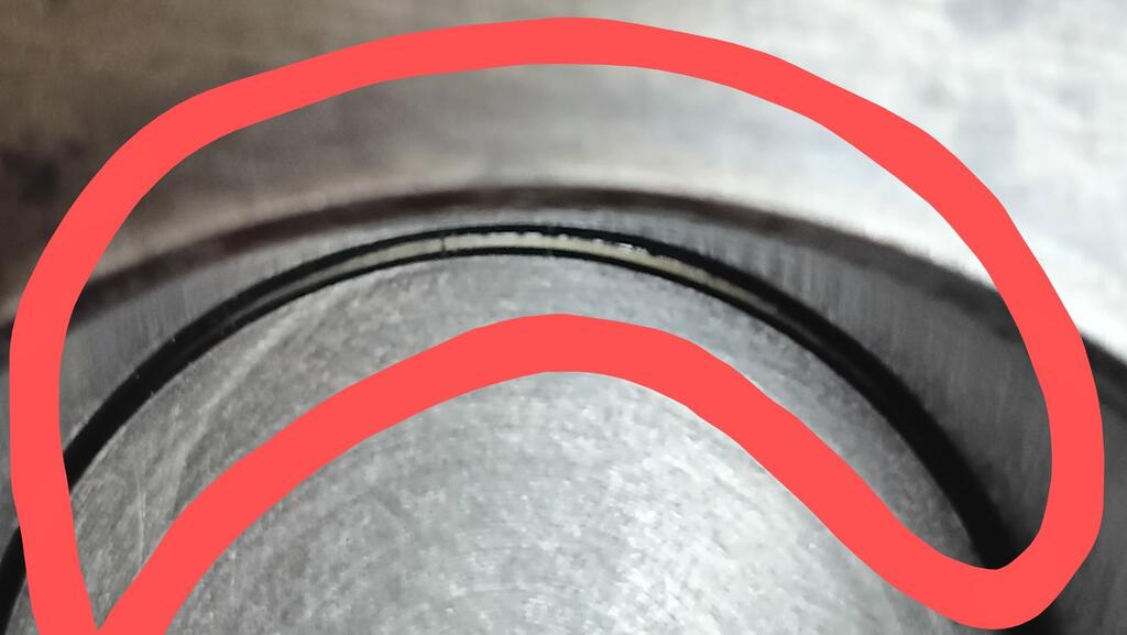

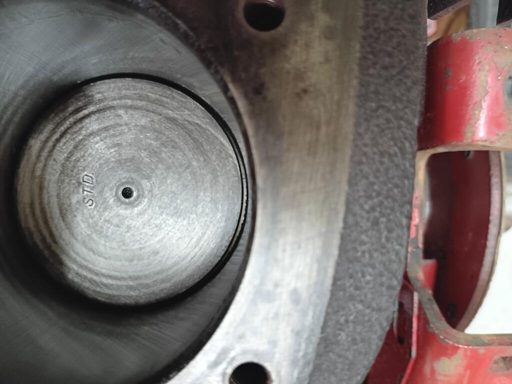

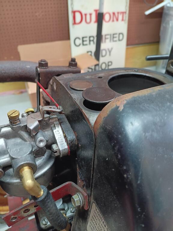

ebinmaine 80,279 #8 Posted July 12, 2025 16 hours ago, squonk said: Pull the head. Sounds like a bad valve 14 hours ago, ri702bill said: Looks like a new carb That's one of my rebuilds. 6 minutes ago, JoeM said: Looks like your going in EB! Got it apart this morning. The intake valve isn't moving. This one won't be fixed for now. The cylinder bore is badly worn and seriously out of taper top to bottom. 1 3 Share this post Link to post Share on other sites

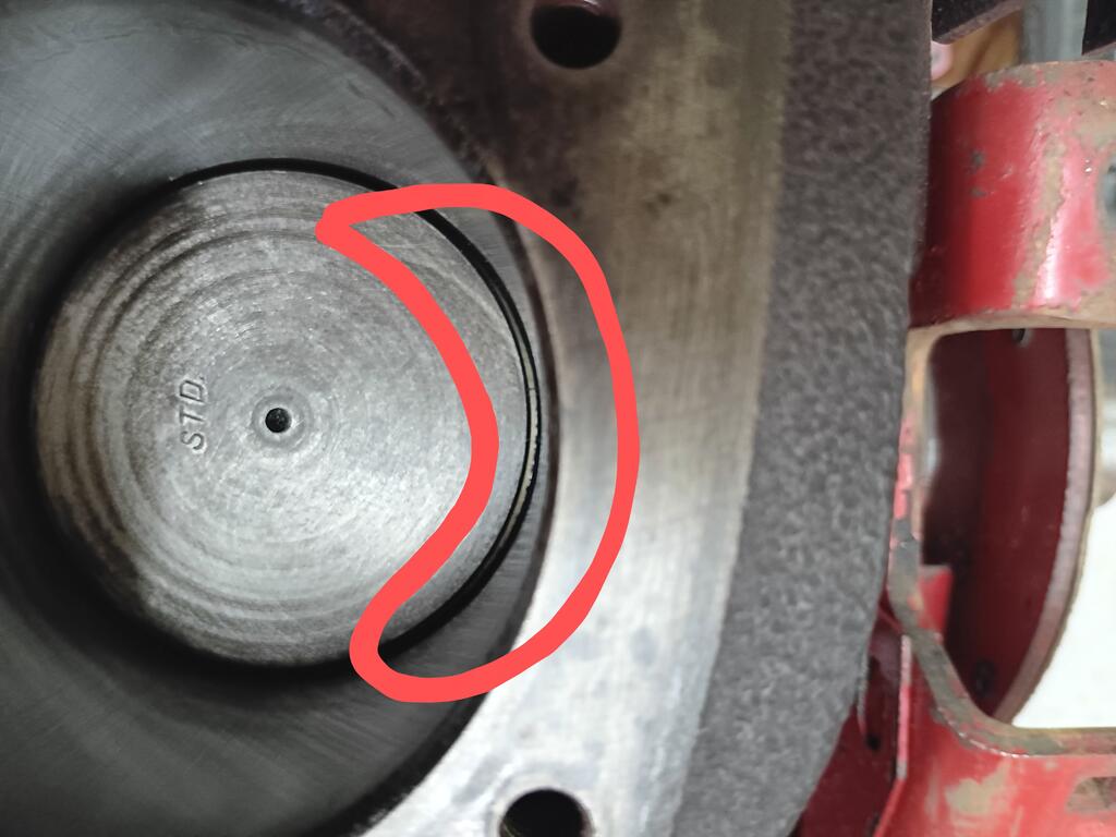

kpinnc 18,884 #10 Posted July 12, 2025 Well it's a standard bore at least. You got room to get it back to round hopefully. 4 Share this post Link to post Share on other sites

ebinmaine 80,279 #12 Posted July 12, 2025 1 hour ago, squonk said: What tractor is that on? It's a B80. Replacement engine of course. 45 minutes ago, ri702bill said: it may be freed up rather easliy It's not stuck. The valve lifts right out. I'd say the keepers have come un-keepered. Share this post Link to post Share on other sites

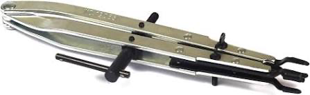

Handy Don 17,316 #17 Posted July 12, 2025 (edited) On the advice of an “old hand” small engine guy, I invested in a “Briggs”-style valve spring compressor. Worked like a champ on the K181. It adjusts to different diameters independently for top (spring only), and bottom (keeper). The “compressor” screw is very fine-threaded so it takes a bunch of turns to compress the spring, but it gives a very handy “handle” when removing or inserting the spring/keeper. The grip is enough to tilt the compressed spring/keeper so it aligns with the valve stem so you can remove or insert the valve easily. Edited July 13, 2025 by Handy Don 1 Share this post Link to post Share on other sites
squonk 47,887 #18 Posted July 12, 2025 I use the "C" clamp style. Keeps the valve against the seat. Then a dab of grease on the keeper groove of the valve and on the keeper. A pencil magnet and a tiny straight blade screwdriver. I also have the block on the bench and tilted so gravity assists on getting the keeper in place. 2 Share this post Link to post Share on other sites
