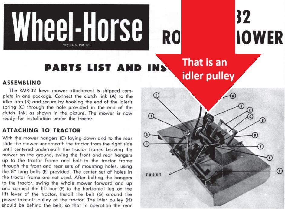

wpenton 4 #4 Posted July 11, 2025 That parts list above is showing a 2 groove pulley(#27). Mine takes a flat idler pulley as far as I can determine. I believe it is part # 1602. 1 Share this post Link to post Share on other sites
wpenton 4 #6 Posted July 11, 2025 That is the one I'm missing. That's the one I need a diameter for Share this post Link to post Share on other sites
