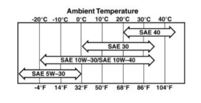

lynnmor 8,939 #27 Posted July 14, 2025 7 minutes ago, DeltaNu1142 said: I didn't set out to do it, but I ended up changing the oil... 1.9 qts Valvoline 5W-30 full synthetic & a WIX 51394XP filter. The oil was low... it came out looking OK, if a little thin. No shiny stuff. I rode around a bit and that seems to have been the cause of my temperature problems. Your engine is to have SAE 30, 10W-30 or 10W-40 oil. I wouldn't run the 5W stuff. Share this post Link to post Share on other sites
DeltaNu1142 28 #28 Posted July 14, 2025 1 minute ago, lynnmor said: Your engine is to have SAE 30, 10W-30 or 10W-40 oil. I wouldn't run the 5W stuff. Ah, you're right. I'm looking right at the chart. I wrote it down wrong earlier and put it in my maintenance log as 5W. I'll change it out next chance I get. Share this post Link to post Share on other sites
lynnmor 8,939 #29 Posted July 14, 2025 5 minutes ago, DeltaNu1142 said: Ah, you're right. I'm looking right at the chart. I wrote it down wrong earlier and put it in my maintenance log as 5W. I'll change it out next chance I get. If you won't be working it hard, not a problem. Of course an early oil change to clean up from the PO is a good thing. 1 Share this post Link to post Share on other sites
