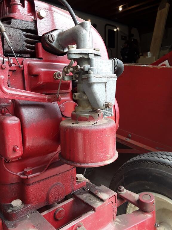

Teddy da Bear62 172 #1 Posted July 10, 2025 The 633 has reached its new home! New owner was wondering if there was a part or 2 missing? It has K141 Kohler with tillotson downdraft carb. Instructions for changing oil include how much oil to add for air filter? Don't think there is a container for oil, for air filter. Can someone show me a clear photo of the end of a 633 w/tillotson carb?? 1 Share this post Link to post Share on other sites
oliver2-44 11,767 #2 Posted July 11, 2025 Those "oil in air cleaner" instructions may have been a mistake, copied over from some models that used oil bath air cleaners. The Tillotson Carbs air cleaner definitely does not use any oil. P.S. Those Tillotson downdraft carbs are getting a little uncommon and are a worth more $$ than a Kohler or Tecumseh carb. Share this post Link to post Share on other sites

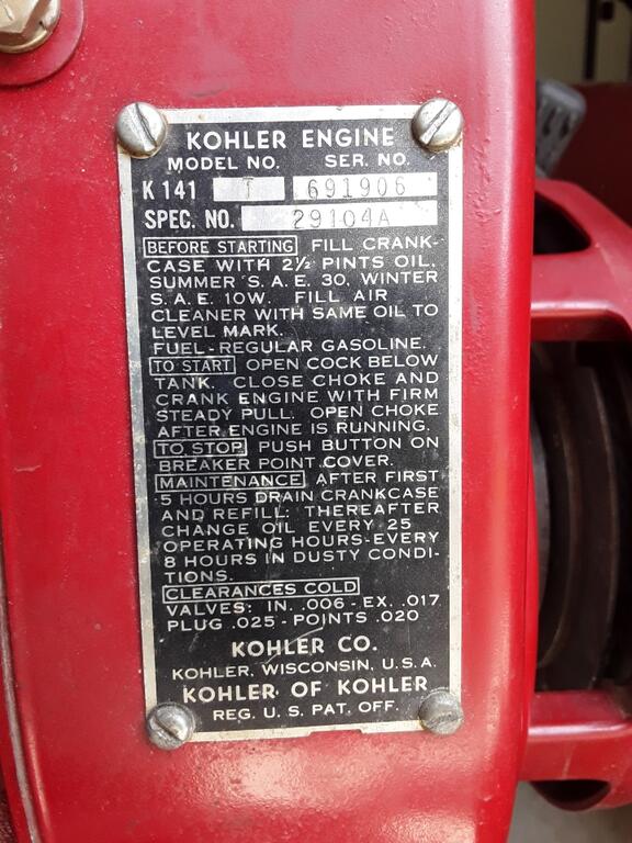

Teddy da Bear62 172 #3 Posted July 11, 2025 I appreciate the clarity. Those instructions are printed right on a plate on the engine. I'll see if I can put a photo up. Share this post Link to post Share on other sites
Teddy da Bear62 172 #4 Posted July 11, 2025 (edited) Here is the plate on the engine. Did wheel horse actually put these giant screws on here? Or would they have pop riveted it Are the air filters available? And if so do you have a part number? Edited July 11, 2025 by Teddy da Bear62 Share this post Link to post Share on other sites
lynnmor 9,049 #5 Posted July 11, 2025 Looks like an updraft to me. 1 Share this post Link to post Share on other sites
