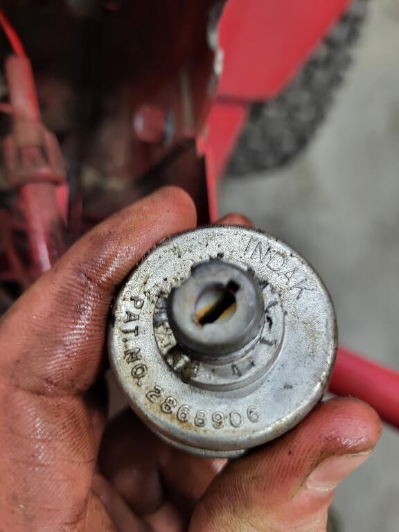

lynnmor 8,565 #3 Posted July 8, 2025 Is the number 2868906 just the patent number by chance? Here is the Indak website, perhaps you can come up with the correct number if you know the function of each terminal and how they connect internally. 2 Share this post Link to post Share on other sites

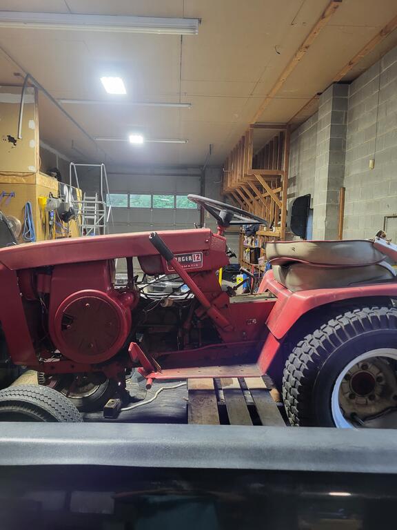

pfrederi 19,797 #4 Posted July 8, 2025 Kohler and WH used 3 different ignition systems on late 60 early 70 Tractors. It is important to know hat ignition system is currently on your tractor (as some original systems failed and were replaced by other types. Pleas post a picture of the front of your engine 3 Share this post Link to post Share on other sites
Domenic 13 #5 Posted July 8, 2025 29 minutes ago, ebinmaine said: I believe that's one you wanna make SURE you get right. Does the tractor still have the original ignition system? Yes 1 Share this post Link to post Share on other sites

Domenic 13 #7 Posted July 8, 2025 22 minutes ago, lynnmor said: Is the number 2868906 just the patent number by chance? Here is the Indak website, perhaps you can come up with the correct number if you know the function of each terminal and how they connect internally. Its the part number 1 Share this post Link to post Share on other sites

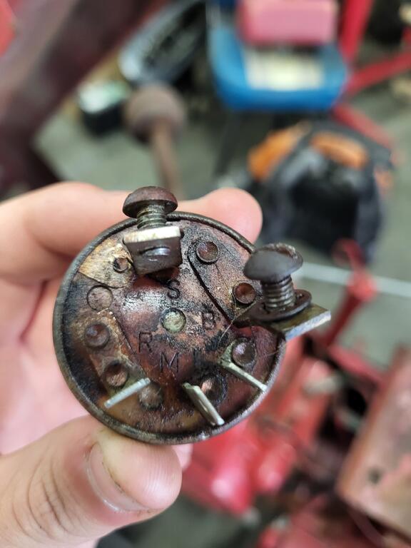

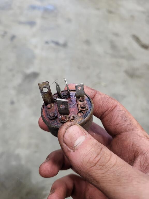

rjg854 12,834 #8 Posted July 8, 2025 That's the patent #. What are the initials on the lugs, that my help narrow it down. 2 Share this post Link to post Share on other sites
ebinmaine 77,082 #9 Posted July 8, 2025 That appears to be the original ignition system. The coil is visible on the front of the engine. 1 1 Share this post Link to post Share on other sites
rjg854 12,834 #10 Posted July 8, 2025 I'm thinking it's a magneto system. 1 Share this post Link to post Share on other sites
squonk 45,379 #11 Posted July 9, 2025 Kohler Breakerless ign. There is a trigger under the shroud and extra wires from the stator that connect to it. 3 Share this post Link to post Share on other sites

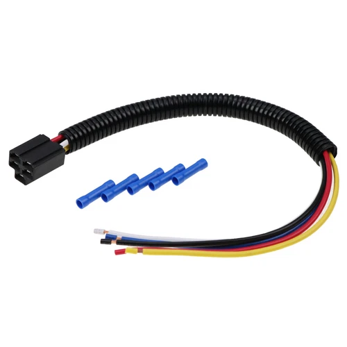

953 nut 63,984 #13 Posted July 9, 2025 Unfortunately the type of switch you are looking for is nearly imposable to find. It has a pair of 60 amp contacts to operate the starter rather than using a solenoid. My suggestion would be to buy a 103 991 ignition switch and a solenoid. The solenoid can be mounter on the engine and then two larger wires presently going to the old ignition switch would be moved to the two large solenoid terminals. A new fuse protected # 14 gauge wire would be added from the battery + to the ignition switch "B" terminal. An ignition switch pigtail as pictured below would make the job easier. The attached drawing will come in handy for this conversion. 2 2 Share this post Link to post Share on other sites
pfrederi 19,797 #14 Posted July 9, 2025 Make sure what ever switch you get that it has an "M" terminal not an"I" terminal;. The wrong switch will destroy your breakerless ignition system,!! 2 Share this post Link to post Share on other sites
Domenic 13 #15 Posted July 9, 2025 13 hours ago, rjg854 said: That's the patent #. What are the initials on the lugs, that my help narrow it down. Share this post Link to post Share on other sites
rjg854 12,834 #16 Posted July 9, 2025 Follow @953 nut's post and you'll be fine. 2 Share this post Link to post Share on other sites
