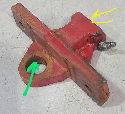

squonk 48,126 #6 Posted July 9, 2025 And this hole near the grease fitting will wallow out. 2 Share this post Link to post Share on other sites

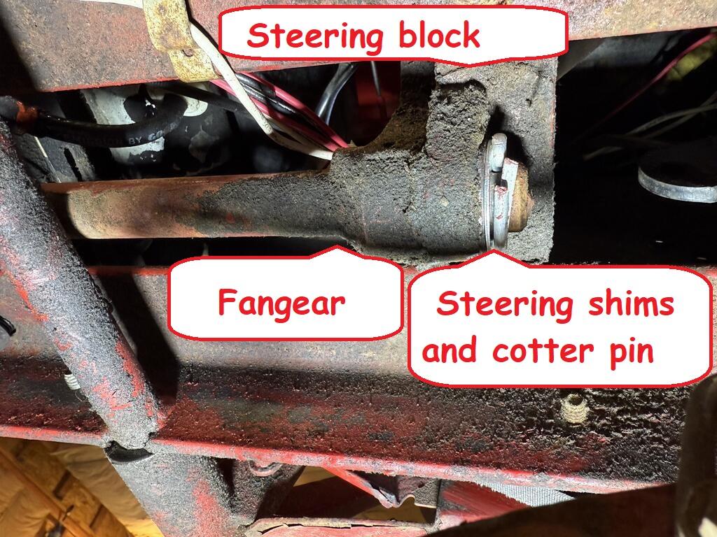

953 nut 69,341 #8 Posted July 9, 2025 If all of the upper steering shaft fittings and the steering block are in good order then shims on the lower steering shaft will pull the fan gear closer to the pinion. 6 1 Share this post Link to post Share on other sites
