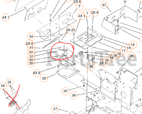

JoeM 10,269 #5 Posted July 8, 2025 If you look down along the shift lever, there is a micro that is engaged by the rod when in reverse. The whisker on the switch might need tweaked a bit so the rod trips the switch. I belive one of the relays with the x is what is engaged by the key switch. and those are under the shift plate toward the front. Share this post Link to post Share on other sites
gwest_ca-(File Mod) 12,488 #6 Posted July 8, 2025 Module is item 15 on this page if you are looking for it https://www.partstree.com/models/73450-315-8-toro-garden-tractor-sn-250000001-250999999-2005/hoodstand-electrical-mounting-assembly-21/ Share this post Link to post Share on other sites
