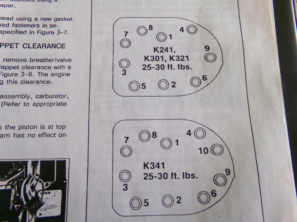

Teddy da Bear62 172 #1 Posted July 6, 2025 Today's project begins. I have one of my GT-14's, the oil pan gasket/seal is leaking badly. I wanted to order a new one. However, after looking for Kohler engine label? There is none! Likely a foil sticker that got removed? My question is...... How can I tell if I have the original 14hp Kohler, or 12hp, or 16hp just by looking at it? Is the oil pan gasket the same for most all these size engines?? Share this post Link to post Share on other sites
Ed Kennell 47,552 #2 Posted July 6, 2025 Extra head bolt on the 16. 3 Share this post Link to post Share on other sites
squonk 48,207 #3 Posted July 6, 2025 The deep std. big block oil pans most Wh's use takes the same gasket. Kohler # 235057 1 1 Share this post Link to post Share on other sites
