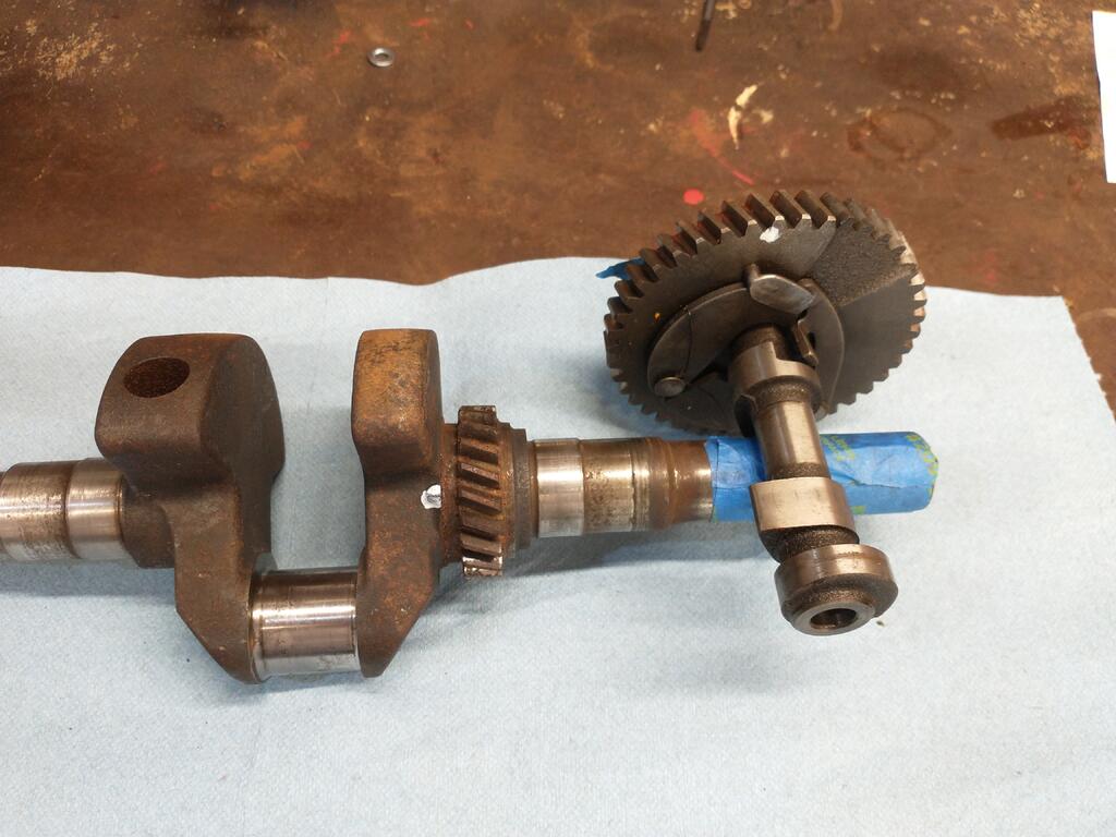

squonk 44,604 #4 Posted July 6 This is on a small block 8 but the marks should be the same. Look for a raised edge in the crankshaft and a dot on the camshaft. Line them up. Share this post Link to post Share on other sites
953 nut 62,143 #5 Posted July 6 2 hours ago, Scott from ontario said: Good morning everyone I’m confused on the timing is there a video available on putting the motor back together? Follow along on the assembly section of this post made by @prondzy, it is a small block but the process is the same. 1 Share this post Link to post Share on other sites
