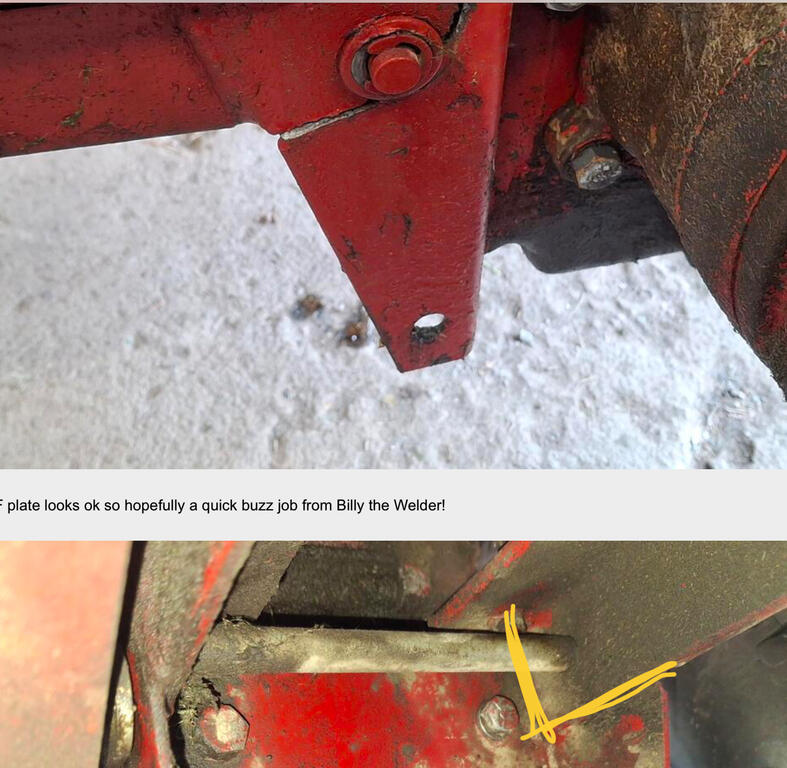

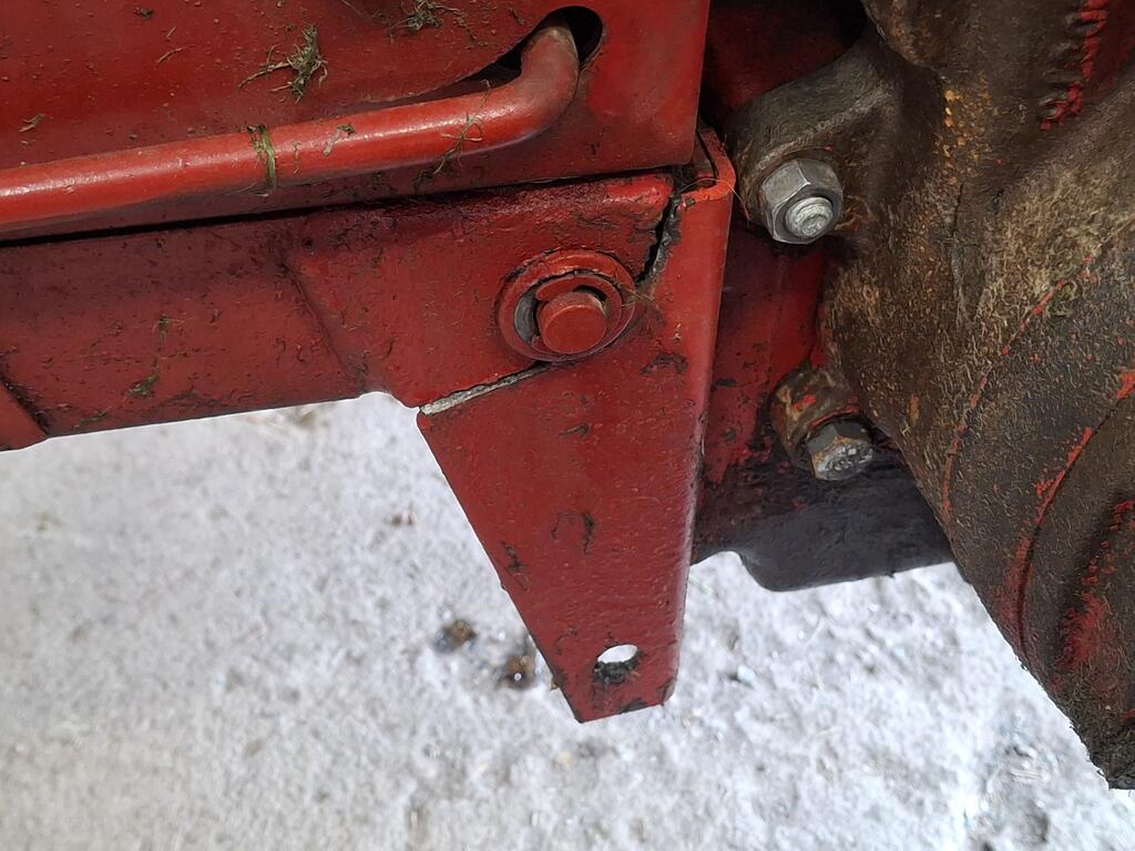

Bought an 875 from a friend months ago. He got it from his neighbor.  Hauled fire wood  most of it's life. When I got it I noticed a little flex when the park pawl is engaged.  Expected to find a cracked F plate or loose/ missing trans mounting bolts. Looked it all over and couldn't see anything.
Was out mowing today and it felt like the seat got loose. Got off and nope the seat was tight..Got back on and my top half went one way and the bottom half went the other way.  Looked down and found this!
The F plate looks ok so hopefully a quick buzz job from Billy the Welder!

ri702bill
It looks like it has a nervous switch!
I've seen the F plates cracked out before, but not like that.

kpinnc
How the heck does that happen? :blink:
On an 8 horsepower hydro?

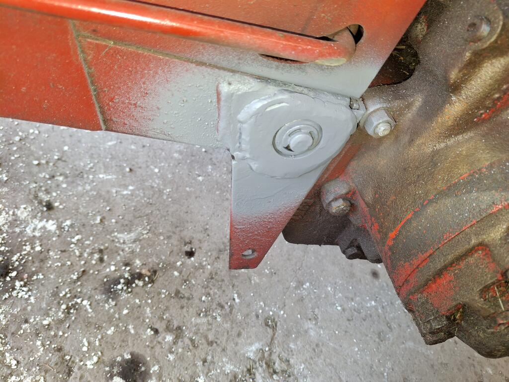

squonk
Got it on the trailer with a vise grip holding it together. Going to the welder tomorrow.

squonk
Now some paint and good for another 55. Shifting seems less jumpy too! :greetings-clappingyellow:

Pullstart
This kind of tells me that any time I get the chance to weld the inside of this joint (yellow lines), I should.  It’s wild how much stress is in that spot, but how the inside is not welded.  It’s like adding a double shear tab to a drag link.  That’s always way more stable!
