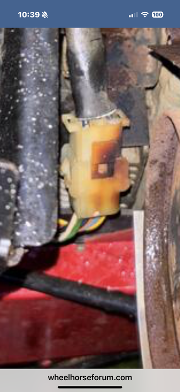

TonyToro Jr. 2,502 #28 Posted July 4, 2025 6 hours ago, Sparky said: Your 9 pin connector looks like it’s toasted. That’ll need to be added to your list of things to address. Thanks Mike. From what I heard there no good. I looked inside and it looked ok but will probably be replace. Share this post Link to post Share on other sites
TonyToro Jr. 2,502 #29 Posted July 4, 2025 Looking at the pictures more. I’ve noticed some 520s have an oil filter. Where is it? Share this post Link to post Share on other sites

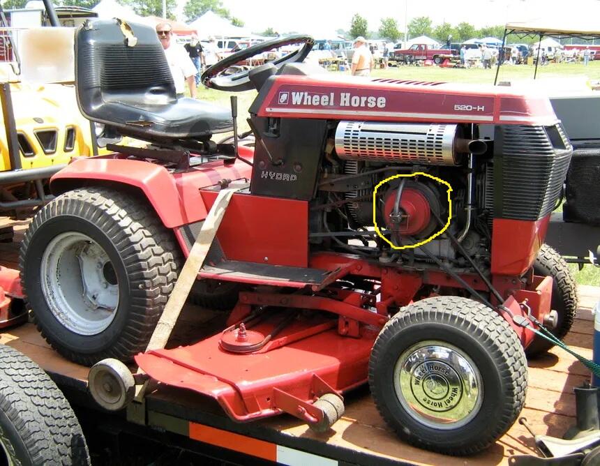

peter lena 9,930 #30 Posted July 4, 2025 @ tony toro jr , opportunity on the deck ? middle of lift frame to deck ? in addition to bearing lubrication change over , have added a flat idler pulley to back side of spindle belt , just pushing toward front of deck , drill a hole in deck for mounting , that long UNSUPPORTED BELT BOUNCE , goes away , also reduces , that additional vibration effect on related bearings . have that set up on 3 decks , no noise or bearing whine , realise the rest of deck is rough , maybe a clean out and lubrication / hot sun soaking ? you have a ton of things to do , but the deck is part of it , would also think about a relocation of that 9 pin , near some cooler air flow . wish you the best on recovery , pete 1 Share this post Link to post Share on other sites

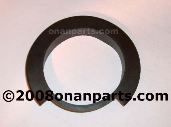

lynnmor 8,875 #31 Posted July 4, 2025 29 minutes ago, TonyToro Jr. said: Looking at the pictures more. I’ve noticed some 520s have an oil filter. Where is it? On the left rear of the engine. Be sure to buy the proper filter that is long enough and fits the rubber gasket well. Most likely that gasket is missing or rotted. Share this post Link to post Share on other sites
Chaz54 100 #32 Posted July 4, 2025 10 hours ago, TonyToro Jr. said: How could you tell? Just with the model number or changes with the tractor? I could tell by the shift lever without even looking at the model number. 1 Share this post Link to post Share on other sites
TonyToro Jr. 2,502 #33 Posted July 4, 2025 11 minutes ago, lynnmor said: On the left rear of the engine. Be sure to buy the proper filter that is long enough and fits the rubber gasket well. Most likely that gasket is missing or rotted. Found it thanks! Share this post Link to post Share on other sites
lynnmor 8,875 #34 Posted July 4, 2025 (edited) 5 minutes ago, TonyToro Jr. said: Found it thanks! Told you the gasket would be missing, don't run without it because 30% of the cooling air is lost there. People complain about valve seat issues with this engine but continue to abuse them. I run only Onan 122-0800 or Fleetguard LF3339 oil filters. I see that the current filter is too short. Edited July 4, 2025 by lynnmor 1 1 Share this post Link to post Share on other sites

Handy Don 16,907 #38 Posted July 7, 2025 (edited) I’m sure you’ve read threads about the Onans and how to avoid trouble. They MUST be looked after! Airflow is critical so a good clean out under the tins and among the fins, especially the rear cylinder, should be considered regular maintenance. If there isn’t already a foam rubber gasket in place around the oil filter sealing it to the tin, get one ASAP. If you must run it in the meantime, firmly tape over the hole -- I’ve seen estimates that 30% of the cooling air is lost without the gasket. Enjoy! Edited July 7, 2025 by Handy Don 1 Share this post Link to post Share on other sites
TonyToro Jr. 2,502 #39 Posted July 7, 2025 27 minutes ago, Handy Don said: I’m sure you’ve read threads about the Onans and how to avoid trouble. They MUST be looked after! Airflow is critical so a good clean out under the tins and among the fins, especially the rear cylinder, should be considered regular maintenance. If there isn’t already a foam rubber gasket in place around the oil filter sealing it to the tin, get one ASAP. If you must run it in the meantime, firmly tape over the hole -- I’ve seen estimates that 30% of the cooling air is lost without the gasket. Enjoy! Yup it’s missing the rubber gasket. I plan on pulling all the tins off the engine and tractor and giving it a good bath. Share this post Link to post Share on other sites

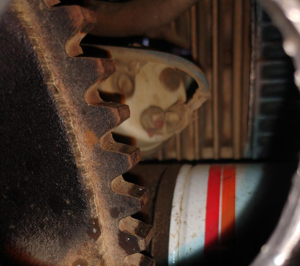

kpinnc 18,714 #41 Posted July 8, 2025 (edited) Just a suggestion here as well: An Onan engine requires a bit more work to get the shroud off to inspect the cooling fins- as you already know. I think this is one of the main reasons these engines overheat and loose the valve seats: Very few people take the time to remove the shroud and regularly inspect the fins. Another is the Wheel Horse drive belt guard- but there are dozens of examples of how to get around that. What I did was to cheat a bit on fin inspection. I used a 1 inch hole saw and bought some snap in plugs the same diameter to make an inspection port. You can use your phone or if you really wanna go big get a borescope. Either way, this allows you to verify the fins are clear on that dreaded rear cylinder. You can also get a spray nozzle in there if they need cleaning. Never spray a hot engine though... A strong P220 is an awesome engine. Keep those fins clean, and the maintenance up and it will easily last 3000+ hours. Edited July 8, 2025 by kpinnc 2 Share this post Link to post Share on other sites

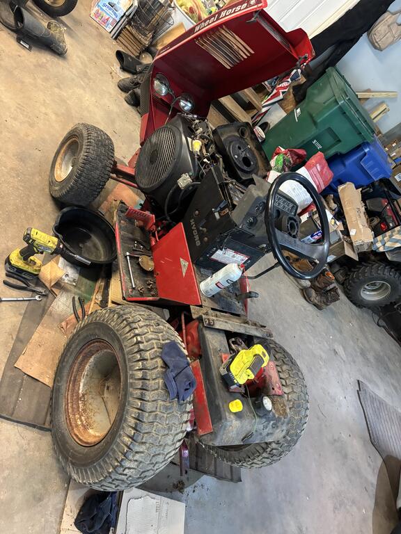

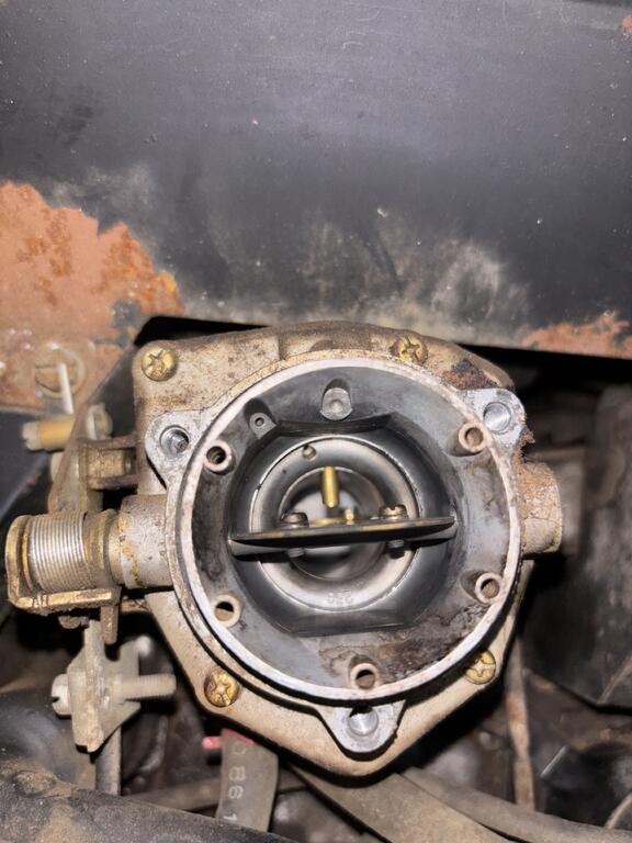

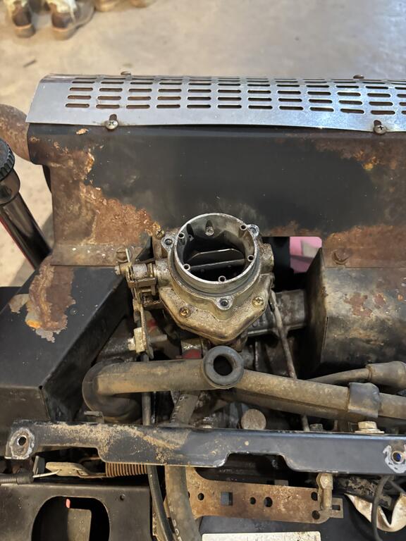

TonyToro Jr. 2,502 #44 Posted July 20, 2025 Finally got around to start digging into this beast. Replaced the fuel filter and fuel line. Also drained out the old fuel/sludge that smelt terrible. Then we had a miniature success! We got it to kinda run on its own with some carb clean. The fuel pump is barely pumping so we are going to get a new one of those and a carb rebuild kit. Parts will be here tommorow too! 2 Share this post Link to post Share on other sites

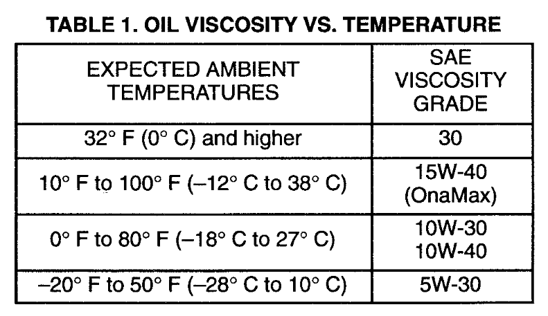

kpinnc 18,714 #48 Posted July 21, 2025 (edited) 2 hours ago, TonyToro Jr. said: Any specific brand for oil? Something with high zinc like the Kawasaki stuff? I prefer oil with zinc additives, if for no other reason that most automotive oils have such things removed now for emissions rules. I don't follow the manuals as gospel on these engines, only because they were written 30 or more years ago before some of the improvements in SOME of today's oil. That being said, the concept of thicker oils in higher temps absolutely makes sense to me, and it gets bleeping hot here in NC summer (those who live here know it can run from February to November ). The folks up north have cold weather concerns that typically do not happen here. Of course the manual is a good place to start any time maintenance questions come up. Most small engine manufacturers now carry oil specifically for air cooled engines, since most wear additives have been removed from automotive oils. The only automotive grade oil I would use in these engines today would be Rotella. I run brand specific in my Vanguards otherwise for the correct zinc additive levels. Edited July 21, 2025 by kpinnc 1 Share this post Link to post Share on other sites
lynnmor 8,875 #49 Posted July 21, 2025 11 hours ago, TonyToro Jr. said: Any specific brand for oil? Something with high zinc like the Kawasaki stuff? I use Kohler 30 or 10w-30, Kinetix is also made for small engines. All engine oils contain zinc but it has been reduced in recent years. API SN and SP is something I would avoid and that is just about any oil made for cars. 1 1 Share this post Link to post Share on other sites
