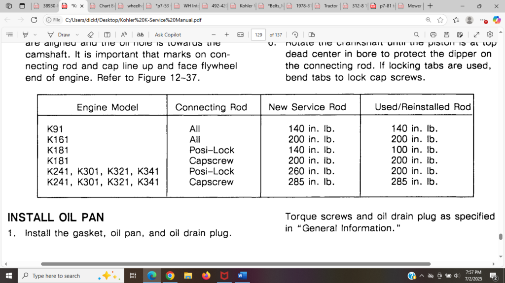

Donleecampbell 6 #1 Posted July 2, 2025 (edited) Ok I replaced the rod piston , rings in my m12 kohler. The service manual stated 200 inch pounds for the old rod which i was installing. i bought a torque wrench for inch pounds previously but never used it until now. it feels way to light, lol. im used to more torque i guess. is that normal for small engines? i removed the balance gears also. I was going to leave them cause other than smoking and low power the engine ran smooth. but i wiggled them and almost passed out, lol. they were crazy wobbly. Edited July 2, 2025 by Donleecampbell 3 Share this post Link to post Share on other sites
adsm08 5,186 #2 Posted July 3, 2025 That's about 16.5 ft lbs, not a lot of torque, but even bigger engines don't go super nuts on rod caps. A 5.0L is 28 ft lb plus some degrees. 2 Share this post Link to post Share on other sites

953 nut 69,724 #6 Posted July 3, 2025 11 hours ago, Donleecampbell said: Ok I replaced the rod piston , rings in my m12 kohler. The service manual stated 200 inch pounds for the old rod which i was installing. i bought a torque wrench for inch pounds previously but never used it until now. it feels way to light, lol. im used to more torque i guess. is that normal for small engines? i removed the balance gears also. I was going to leave them cause other than smoking and low power the engine ran smooth. but i wiggled them and almost passed out, lol. they were crazy wobbly. That is what the service manual calls for. Good catch on the grenade gears. 3 Share this post Link to post Share on other sites
