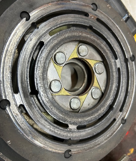

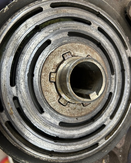

JoeM 9,977 #32 Posted July 4, 2025 22 hours ago, pfrederi said: Electric PTO are steel Reference pics, this one that came off of a 800 hr plus machine. No history. It wouldn't consistently start the blades, just squeal. Looking at the mechanics of this thing, It is kind of odd. Just not two flat surfaces going together. The center of the finger section is very flexible. The magnetic field pulls and the center would touch first and continue outward to the edge. The three circles have ridges that mate up the the slotted areas of stationary disc, (tongue and groove). These areas get worn the outer raised ring will rub grove in the opposing disk at the rivets. The rivet grove determines if the game is over. I figure many banzai starts! 1 Share this post Link to post Share on other sites
