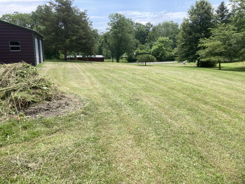

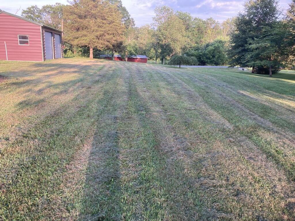

"Manic-Mechanic" 1,485 #1 Posted June 29, 2025 (edited) I have been running this unit as a mulching mower as it has mulching blades. However, it keeps trying to discharge under the left side? Plus, seems the spindles are sitting lower than I like. The skids are barely above ground by an inch and height wheels are maxed out? See the clumps I must deal with now. However, after checking this out, I no longer think this is a mulching mower and will remove the left side cover? Edited June 30, 2025 by "Manic-Mechanic" 1 Share this post Link to post Share on other sites
Pullstart 70,681 #2 Posted June 30, 2025 Is it level? It looks like maybe one side is scalping and the other is not. *I am not a mower expert by any means* 1 Share this post Link to post Share on other sites
"Manic-Mechanic" 1,485 #3 Posted June 30, 2025 1 hour ago, Pullstart said: Is it level? It looks like maybe one side is scalping and the other is not. *I am not a mower expert by any means* Yes, it is level. I just tweaked it thoroughly. Gonna pull that left shield off here today. 2 Share this post Link to post Share on other sites
Pullstart 70,681 #4 Posted June 30, 2025 19 minutes ago, "Manic-Mechanic" said: Yes, it is level. I just tweaked it thoroughly. Gonna pull that left shield off here today. ok, I see the windrows looked like scalping to me. Doh! 1 1 Share this post Link to post Share on other sites
"Manic-Mechanic" 1,485 #5 Posted June 30, 2025 42 minutes ago, Pullstart said: ok, I see the windrows looked like scalping to me. Doh! I lost whenever it comes to actually “mowing”! After a lifetime of running tractors think I’d be a bit more knowledgeable 1 1 Share this post Link to post Share on other sites
"Manic-Mechanic" 1,485 #6 Posted June 30, 2025 I opened up the left side and made second pass, huge difference! Not mulching set up! 1 Share this post Link to post Share on other sites

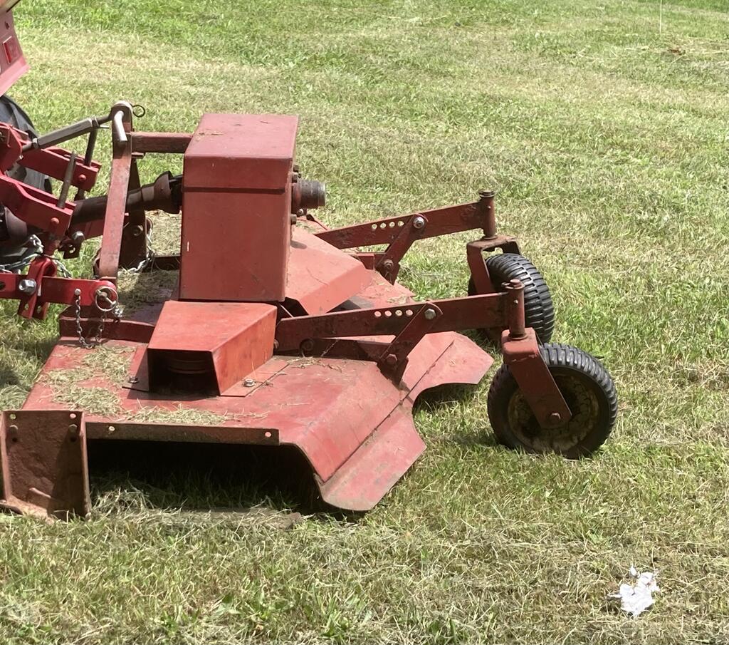

Handy Don 16,942 #7 Posted June 30, 2025 I’m really puzzled by the gauge wheel height adjusters. It seems like that mower would be cutting very, very low at a lower settings? Also, to my eye, the front is much lower than the back, On a hard, smooth, level surface you can use a blade height gauge to check. 1 Share this post Link to post Share on other sites
Stepney 2,356 #8 Posted June 30, 2025 I have a fairly similar 74" mower built by Douglas and that thing also cuts almost unusably low. Maxed out I can get about 3 1/4" at the blades. I'm not sure if all trailing mowers are like that or what .. I usually just level it the best I can with the 3pt arms, chain the arms up to something solid on my Ford, and let it go. The wheels act more like scalp wheels. It also had a cover and was miserable with it in place. Even with the cover removed it still spits a lot of grass out the center. I've never got it to work 'quite right'. Only want about 1/4" or so of forward lean on the blades, hard to get a 3pt mower really lined up right, especially with only two wheels like that one. 1 Share this post Link to post Share on other sites
"Manic-Mechanic" 1,485 #9 Posted June 30, 2025 1 hour ago, Handy Don said: I’m really puzzled by the gauge wheel height adjusters. It seems like that mower would be cutting very, very low at a lower settings? Also, to my eye, the front is much lower than the back, On a hard, smooth, level surface you can use a blade height gauge to check. Yeah, this is a cat 0 tractor but this set up isn't working out, I even changed the arms on the 3-pt over to that of 18 Auto. Also, there is no more height adjustments on the gauge wheels, can only go lower, which make no sense! I wrestled with the height control and support chains cannot get this sit as it should. I removed the mower from the tractor and returned the factory 3-pt arms back onto the unit. 1 Share this post Link to post Share on other sites
"Manic-Mechanic" 1,485 #10 Posted June 30, 2025 24 minutes ago, Stepney said: I have a fairly similar 74" mower built by Douglas and that thing also cuts almost unusably low. Maxed out I can get about 3 1/4" at the blades. I'm not sure if all trailing mowers are like that or what .. I usually just level it the best I can with the 3pt arms, chain the arms up to something solid on my Ford, and let it go. The wheels act more like scalp wheels. It also had a cover and was miserable with it in place. Even with the cover removed it still spits a lot of grass out the center. I've never got it to work 'quite right'. Only want about 1/4" or so of forward lean on the blades, hard to get a 3pt mower really lined up right, especially with only two wheels like that one. As I said to Don, I removed the mower, it is beyond my comprehension. Nothing in the manuals has addressed this issue. The other members that run them have yet to share their secrets. This was second attempt on the 1650, best keep it to the 18 Auto in the future. I wanted to make use of it, cost me a fortune and it just sits in my shop! 1 Share this post Link to post Share on other sites
Handy Don 16,942 #11 Posted June 30, 2025 (edited) Definitely something odd about the gauge wheel height adjusters. It seems the wheel caster shafts would always be at an angle and never vertical. Hmmm. I’m wondering what the inboard mounting point for the arms is like. Are the arms inverted? Maybe there is another (higher up) mounting hole for the inboard end? Are the arms from a different deck? Edited June 30, 2025 by Handy Don 1 Share this post Link to post Share on other sites
"Manic-Mechanic" 1,485 #12 Posted June 30, 2025 1 minute ago, Handy Don said: Definitely something odd about the gauge wheel height adjusters. I’m wondering what the inboard mounting point for the arms is like. Are the arms inverted? Maybe there is another (higher up) mounting hole for the inboard end? Are the arms from a different deck? No other mounting locations and the arms are factory. I just looked at the manual for the 5th time and it is as it was designed. Makes no sense to have all those extra lower settings which would turn this thing into a tiller! Now on the 18 Auto the hitch is up higher, and the mower sits more level but those adjustments are wacky. 2 Share this post Link to post Share on other sites
