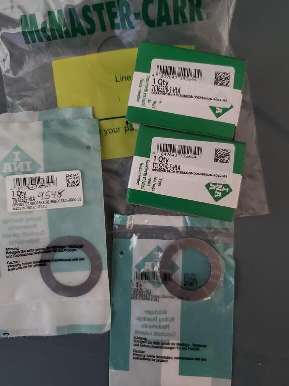

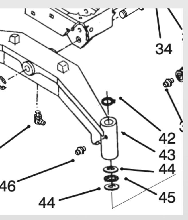

ebinmaine 74,945 #1 Posted June 29 Where can we get the thrust bearings, washers and top lock ring/snap rings for a 520 splayed forward front axle? Item numbers 44, 45, and 42 below. @Handy Don @lynnmor 1 Share this post Link to post Share on other sites
Thor27 846 #2 Posted June 29 (edited) Mcmaster-carr Edited June 29 by Thor27 2 1 Share this post Link to post Share on other sites

ebinmaine 74,945 #4 Posted June 29 10 minutes ago, Thor27 said: Mcmaster-carr I have some coming. Thanks! 9 minutes ago, rmaynard said: Let me check. I used to sell them. I might have a set hiding somewhere. Bob if you have a set left to sell I'll take em. I have three of these axles to recondition. Share this post Link to post Share on other sites

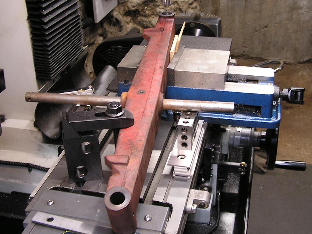

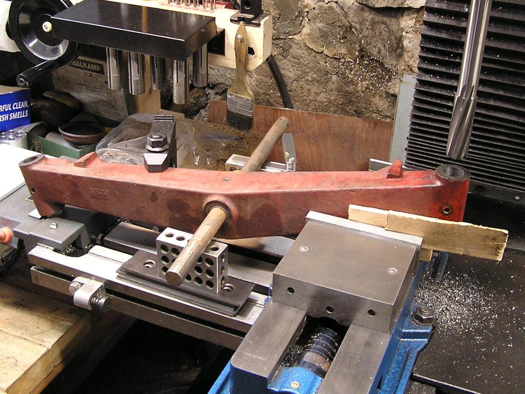

ri702bill 10,264 #6 Posted June 29 11 minutes ago, ebinmaine said: I have three of these axles to recondition. Eric - how are the axle bores?? They tend to get egg shaped - top pattern is opposite of bottom. Are the spindle shafts well worn?? They can be welded up and cut to work. I have done several axles where I drill & ream the bores for bronze bushings, and the center pivot as well. 1 3 Share this post Link to post Share on other sites
ebinmaine 74,945 #7 Posted June 29 33 minutes ago, ri702bill said: Eric - how are the axle bores?? They tend to get egg shaped - top pattern is opposite of bottom. Are the spindle shafts well worn?? They can be welded up and cut to work. I have done several axles where I drill & ream the bores for bronze bushings, and the center pivot as well. The spindles have some wear. Nothing major. The axle bores I haven't checked yet. Ran outta energy... We did one ream & bushings install. Maybe two? I have the tool and bushings for the center bore. I'd have to get a larger reamer if the side bores are bad. Share this post Link to post Share on other sites
