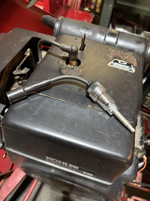

Sparky-(Admin) 24,544 #6 Posted June 29, 2025 Or get one of these from Harbor Frieght..in line spark checker. 2 Share this post Link to post Share on other sites

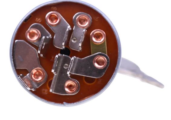

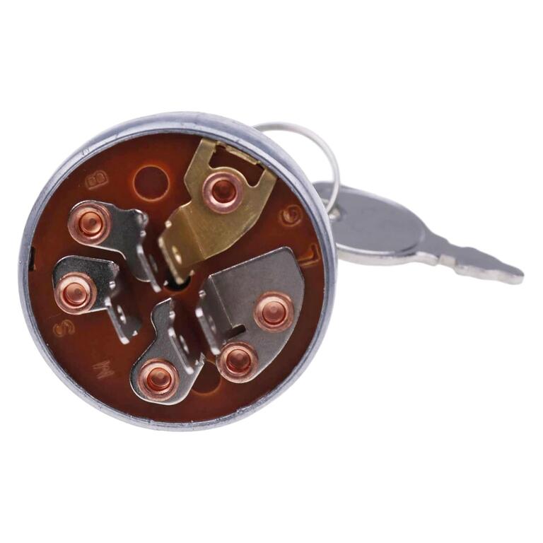

Jaybo 8 #10 Posted June 30, 2025 Good morning. I didn't know that starter fluid was that bad. I will use an alternative that was recommend. I sat in the seat, pushed in the clutch, pushed in on the brake, using the new plug, and still no spark. I am pretty sure that the PTO handle was disengaged as well. I will try to verify that again this AM. The tractor did start and run but that was early last year (2024). It has been stored in the barn until about 4 weeks ago, it has been sitting in the elements. I replaced the starter switch a few days ago. I used this (Stens 430-512 Starter Switch Replaces Toro 103990 Power King 03-2028 AYP 2683R Lesco 050102) from amazon. https://www.amazon.com/dp/B0015MJWAG?ref=ppx_yo2ov_dt_b_fed_asin_title I have noticed that there is a wire with a terminal on the end, but I dont see where it goes. I will try to get a pic of that. Share this post Link to post Share on other sites
pfrederi 19,797 #11 Posted June 30, 2025 14 minutes ago, Jaybo said: Good morning. I didn't know that starter fluid was that bad. I will use an alternative that was recommend. I sat in the seat, pushed in the clutch, pushed in on the brake, using the new plug, and still no spark. I am pretty sure that the PTO handle was disengaged as well. I will try to verify that again this AM. The tractor did start and run but that was early last year (2024). It has been stored in the barn until about 4 weeks ago, it has been sitting in the elements. I replaced the starter switch a few days ago. I used this (Stens 430-512 Starter Switch Replaces Toro 103990 Power King 03-2028 AYP 2683R Lesco 050102) from amazon. https://www.amazon.com/dp/B0015MJWAG?ref=ppx_yo2ov_dt_b_fed_asin_title I have noticed that there is a wire with a terminal on the end, but I dont see where it goes. I will try to get a pic of that. YOU have the wrong ignition switch. It is for a K series battery points ignition. If you used it on your magnum yo may have destroyed the magneto. You need a switch with an "M" terminal not an "I" 1 Share this post Link to post Share on other sites
jsp_333 286 #12 Posted June 30, 2025 16 hours ago, Sparky said: Or get one of these from Harbor Frieght..in line spark checker. Didn't know that even existed. THX. Just ordered one. 1 Share this post Link to post Share on other sites
Jaybo 8 #13 Posted June 30, 2025 Dang, OK. I hope it isnt ruined. Will this switch work? From amazon https://www.amazon.com/dp/B0015MJWAG?ref=ppx_yo2ov_dt_b_fed_asin_title 1 Share this post Link to post Share on other sites
Jaybo 8 #14 Posted June 30, 2025 4 hours ago, pfrederi said: YOU have the wrong ignition switch. It is for a K series battery points ignition. If you used it on your magnum yo may have destroyed the magneto. You need a switch with an "M" terminal not an "I" Dang, ok I hope it isnt ruined. Will this one work? From Amazon. https://www.amazon.com/dp/B0015MJWAG?ref=ppx_yo2ov_dt_b_fed_asin_title 1 Share this post Link to post Share on other sites

Jaybo 8 #16 Posted June 30, 2025 (edited) Or is this perhaps the right key switch? I found a reference to that part number in this link: https://www.amazon.com/TCINDRR-Ignition-Compatible-103991-111215/dp/B0CZ95XCRV/ref=sr_1_3?crid=39ESQ6GEET8R9&dib=eyJ2IjoiMSJ9.FsR7gU3NGzAdp3v53KW0yOF8KP2YJa83tjyjTwYHJd7yQqCcxyP4iDRWV3ib6SBRwUt0YXYxUG5dp4ljhK8YwsuD0tJvgGEpePdNjyo58tyZWlciUa-OYecuoBIC1RDIV4oIK1sNraSvUIxXVoXDts3YR6PoS8BCfhpezqPtxc5sHHpECWM9BqKVvwj2b6P142MRnnuPWzwFlSum6WOteW_n7A1d2kz9qK1tgpzbYT8.ChWOcMyaOai1gJtFWgrC92fnc_AZjOgu4V8Tl94unFg&dib_tag=se&keywords=103991+ignition+switch&qid=1751305294&sprefix=103991%2Caps%2C138&sr=8-3 Edited June 30, 2025 by Jaybo 1 Share this post Link to post Share on other sites
gwest_ca-(File Mod) 11,981 #17 Posted June 30, 2025 The 6th wire to the side is for a ground to make sure the body of the switch is grounded. 103991 is the correct switch. As you have seen they all look alike but inside they function differently. 1 Share this post Link to post Share on other sites
953 nut 63,984 #18 Posted June 30, 2025 6 hours ago, Jaybo said: Dang, ok I hope it isnt ruined. Unfortunately the magneto was most likely harmed. Here is information from a post I did a few years ago. I wish the manufacturers would have made the configuration on these switches different enough that insolents like this couldn't happen. Garry @gwest_ca, I had never taken the time to place the two switching layouts side by side. Very interesting to a wiring geek like me. I took your information and carried it out to see what would happen if a 103991 (Magneto) switch was placed in a Battery Ignition tractor. With the exception of a frustrated person wondering why nothin works the outcome would be rather harmless. In the OFF position the R and A terminals would be connected Ground, no big deal. In the RUN position the I, A and R terminals would be connected, nothing would happen but no harm would come of it. In the START position the S an I terminals would be connected, once again nothing would happen but no harm would come of it. On the other hand, if this situation were turned around and the 102990 (Battery Ignition) switch were placed in a Magneto tractor things get a bit more interesting and a whole lot more expensive. In the OFF position none of the terminals are connected and all is well. In the RUN position the B, R, A and M terminals are connected and magic smoke will be released from the Magneto. In the START position the B, A, S and M terminals will be connected and the engine will turn over but there will be no spark because the magneto already is toast. Share this post Link to post Share on other sites
