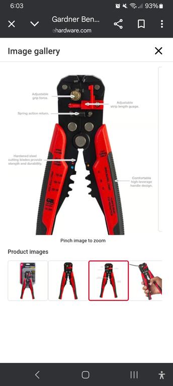

ebinmaine 77,082 #2 Posted June 28, 2025 Thanks for giving me a "mention" here. Not knowing your own skills with wiring and given that someone else may read this, several things come to mind. USE PROPER PPE. Safety eye protection is a must when cutting wire. Period. 1. Buy or borrow a good pair of medium to heavy duty wire crimpers. See pics. The inexpensive thin ones with a single stamped piece of metal for each arm can be ..... challenging... to use. I tend to bend them. 2. Use them correctly and in the right spots. I have several brands of this type. They all work fine. Some grip better. Some fit my hand better. I don't gravitate to or shy away from any. Here's a great video showing proper usage: The above two things will save you time now AND later having done the job once and right. 3. Get good FULL COPPER wiring. CCA - Copper Clad Aluminum - is NOT RECOMMENDED for outdoor use because the copper and aluminum will corrode. 4. IMHO, Always use heat shrink tubing. Always. Get the type with sealant in it if possible. When the tubing is shrunk over the wire end it offers both a mechanical fastening insurance policy and a corrosion resistance that are both absolutely needed on an exterior usage working machine. 5. Use wire protection. Wire loom, vinyl or rubber coated clamps etc will be good to keep the wiring harness from damage. 5A. Use Dielectric Grease. 6. We bring up GROUNDS fairly often. These are DC circuits. Direct Current. No ground equals no direct equals no circuit. Make GOOD ground circuits. Make SEVERAL ground circuits. I personally prefer to make a separate ground wire for every circuit. 7. Wire COLOR is important. Ground is black, possibly brown. Power/hot main circuit is red. Secondary power circuits are whatever color is handy and practical. NEVER use black or brown for any powered circuit. NEVER. I change the battery cables from both factory black to red & black. 5 hours ago, 8ntruck said: I'm planning on powering the pump directly from the rectifier terminal. This sound like a good idea? I personally prefer a switch in a fuel pump circuit. That way when you shut down for long term setting you can turn off the pump and let the machine empty the carb bowl. 3 Share this post Link to post Share on other sites
