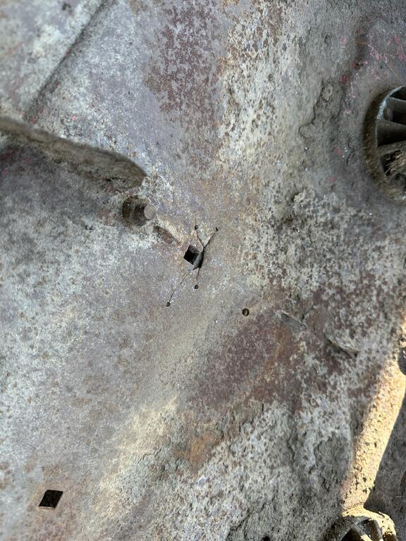

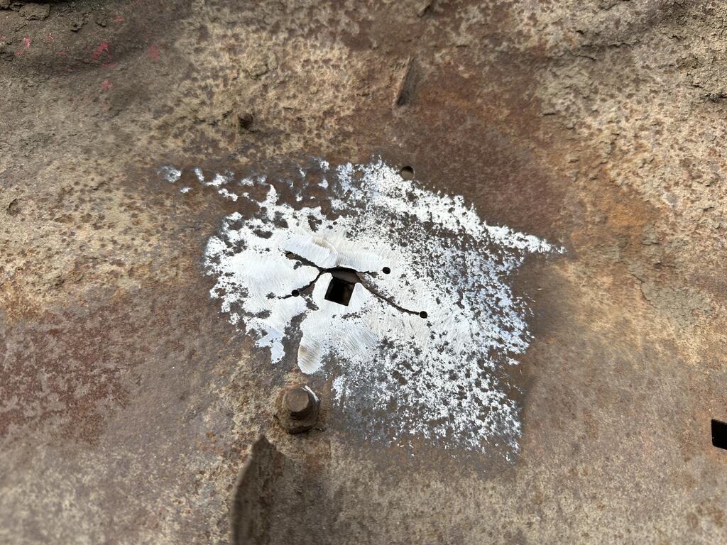

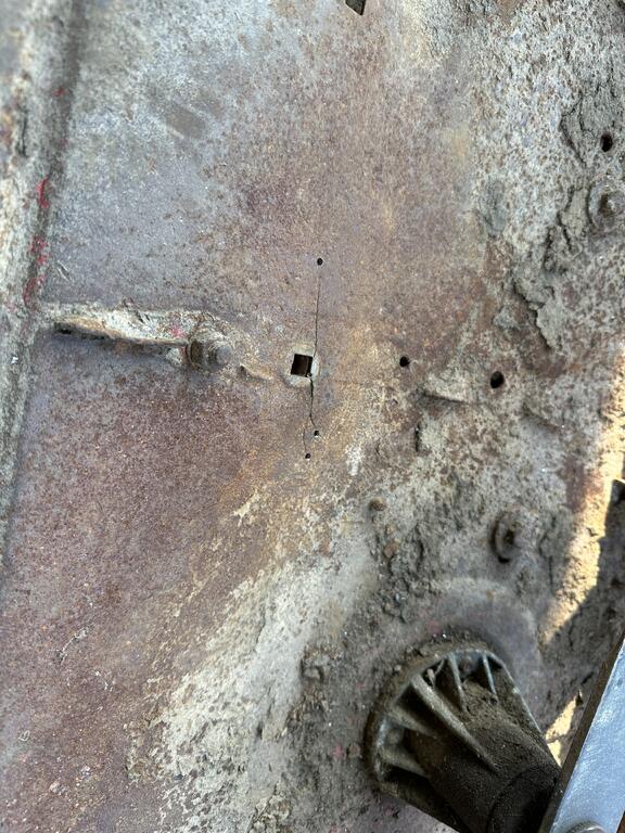

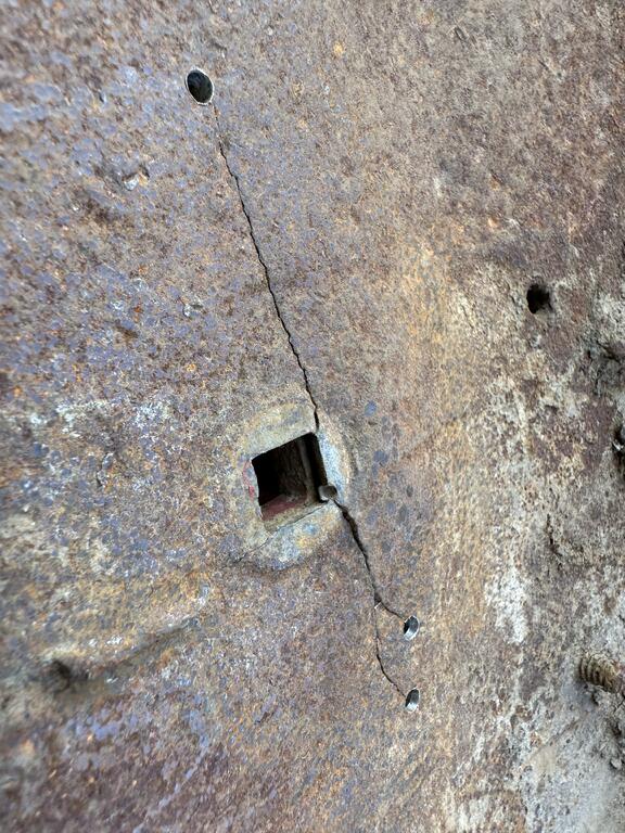

Pullstart 71,359 #1 Posted June 27, 2025 I listed this good n straight 42” deck for sale on the Big Show buy/sell/trade thread and received no bites. It did have some cracks, so I decided to clean it up a bit today. I found a new set of blades on a beat up old deck, and gave them a little touch up on the belt sander. After popping them on, I busted out an 1/8” drill bit and a drill and popped some holes in the end of the cracks. 3 Share this post Link to post Share on other sites

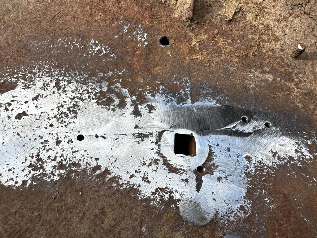

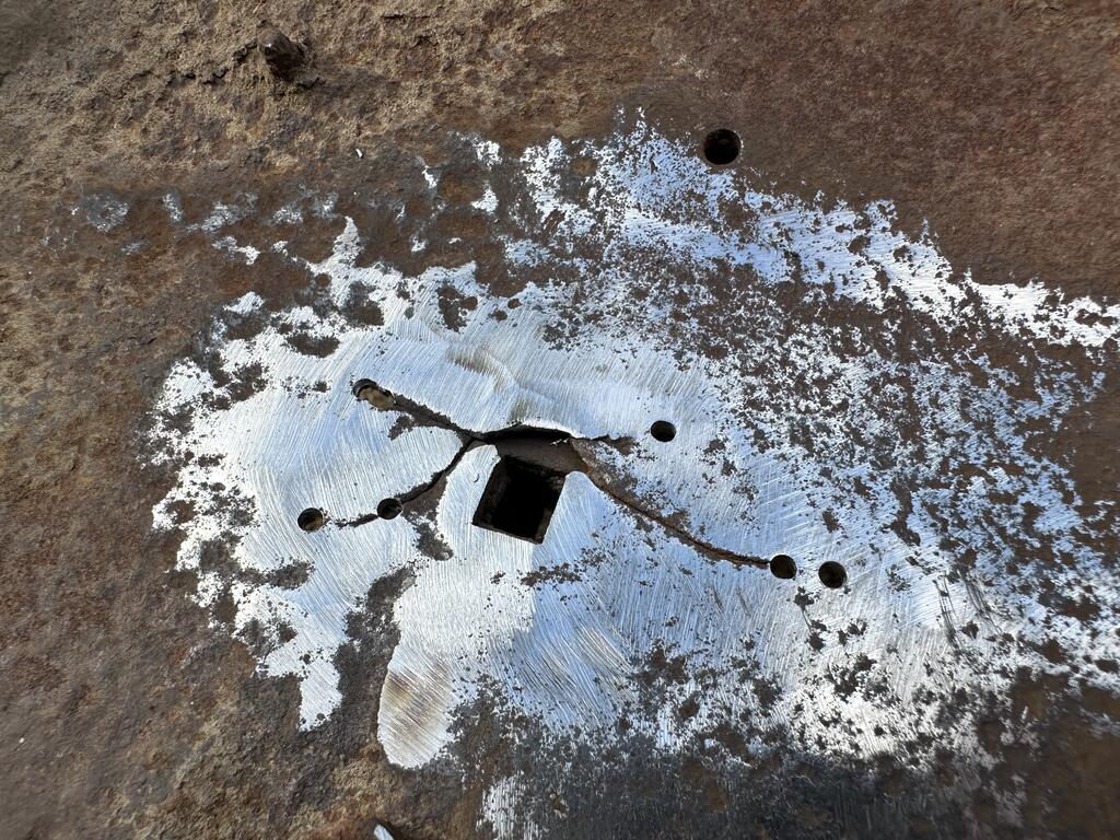

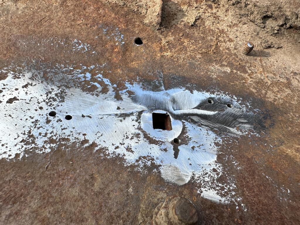

Pullstart 71,359 #2 Posted June 27, 2025 I busted out the flap wheel on the 4-1/2” disc grinder, and cleaned the areas. Lo and behold, I found longer cracks. More holes drilled fixed them from spreading! 4 Share this post Link to post Share on other sites

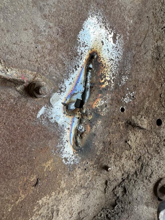

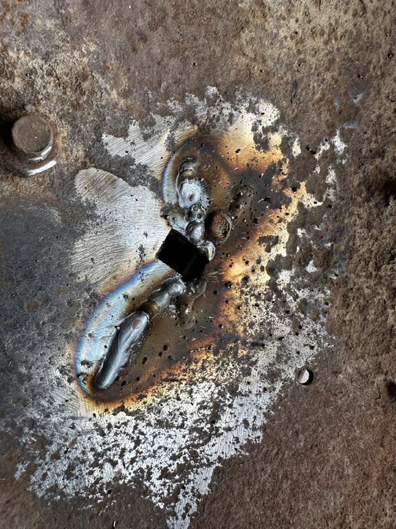

Pullstart 71,359 #3 Posted June 27, 2025 I beat on the areas. Bit with my ball peen hammer, and got it as flat as reasonably possible. I welded up the cracks, then ground the beads smooth again. 4 Share this post Link to post Share on other sites

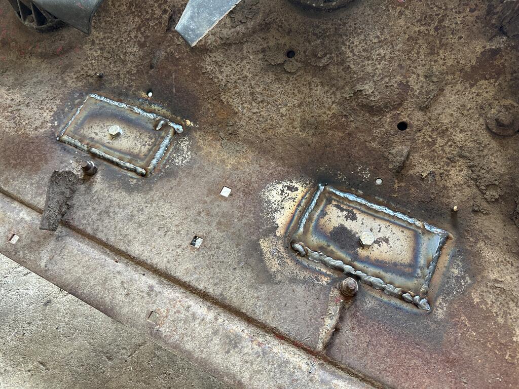

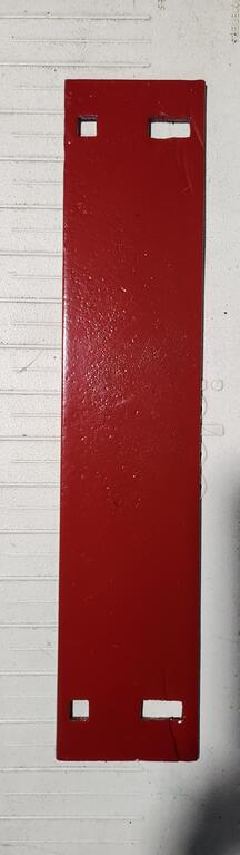

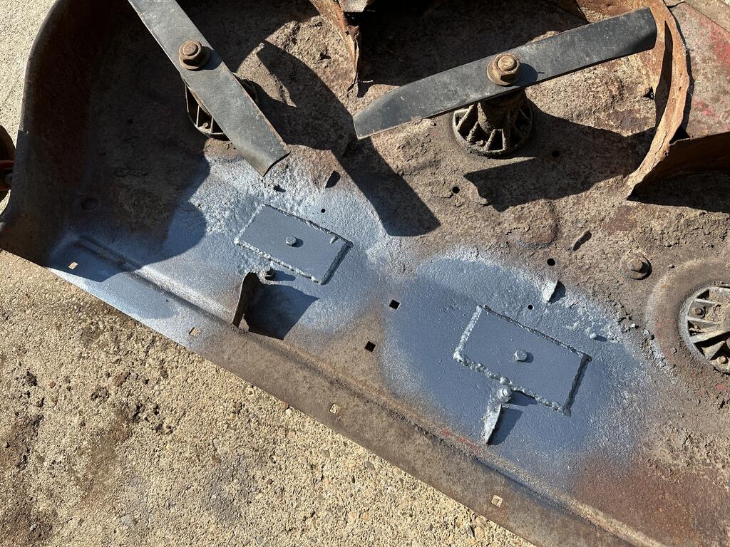

Pullstart 71,359 #4 Posted June 27, 2025 Knowing the area was prone to more cracks, I decided to add some support. I free hand cut some 1/8” plate, drilled a hole in the center of each one, and bolted it down. I then burned ‘em in! A little marine paint because the was the first not-clogged nozzle I found, and it’s ready to flip, grease and mount! 2 4 Share this post Link to post Share on other sites

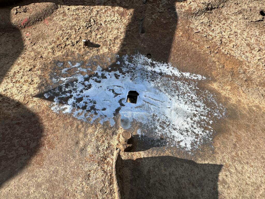

Pullstart 71,359 #5 Posted June 27, 2025 Unfortunately, the stirrups on my new “1445” hit the deck hanger arms. I’ll have to swap the front deck carrier onto that machine, and put this deck on the B-121! 2 1 Share this post Link to post Share on other sites

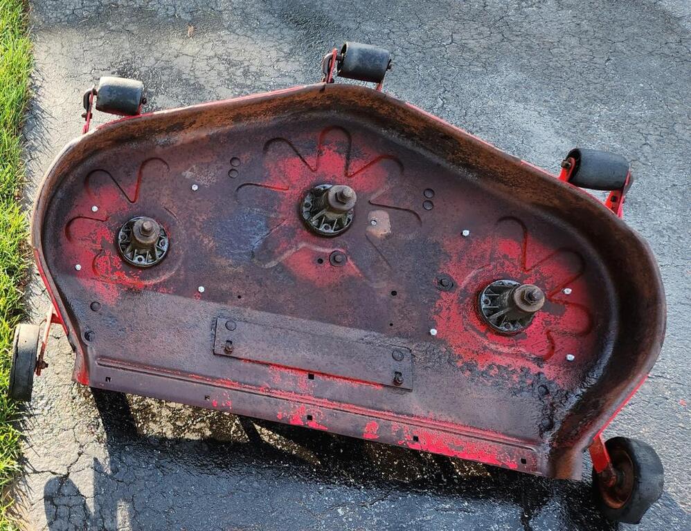

Brockport Bill 2,479 #6 Posted June 27, 2025 nice rescue --- great to see these decks saved !!! I harvested a 42 rd reinforcement plate from another damaged 42 and then transferred to a better shell i did a more complete rehab on 3 4 1 Share this post Link to post Share on other sites
Achto 32,842 #7 Posted June 27, 2025 59 minutes ago, Pullstart said: Unfortunately, the stirrups on my new “1445” hit the deck hanger arms. I’ll have to swap the front deck carrier onto that machine, and put this deck on the B-121! Or turn your stirrups so they are flat. 2 1 Share this post Link to post Share on other sites
Pullstart 71,359 #8 Posted June 27, 2025 I don’t have a ton of experience with decks, but that would make sense to have @Brockport Bill! 1 Share this post Link to post Share on other sites
Brockport Bill 2,479 #9 Posted June 27, 2025 apparently some 42 rd's had the underneath plate and others did not ? Maybe someone else knows if wh added them in later years -- but for me, i had a damaged deck i was scrapping so i just transferred the plate from it to the deck i was rehabbing -- it would seem to make sense if people have a 42 rd without the reinforcement plate to get a piece of steel plate and drill the necessary holes in it and install as a preventative strategy to avoid future cracks from stress on the shells where the lift carriage assembly bolts come through?? It's a shame these decks have the same weakness flaws with common problems. 2 Share this post Link to post Share on other sites

lynnmor 9,050 #13 Posted June 27, 2025 3 hours ago, Brockport Bill said: apparently some 42 rd's had the underneath plate and others did not ? Maybe someone else knows if wh added them in later years -- but for me, i had a damaged deck i was scrapping so i just transferred the plate from it to the deck i was rehabbing -- it would seem to make sense if people have a 42 rd without the reinforcement plate to get a piece of steel plate and drill the necessary holes in it and install as a preventative strategy to avoid future cracks from stress on the shells where the lift carriage assembly bolts come through?? It's a shame these decks have the same weakness flaws with common problems. I bought a new 42" RD in 1991 and it has the plate. There are a number of variations of the 42" RD; Recycler, some have baffles, some are completely open. Some have a heavy round bar around the bottom and others have little reinforcement of the bottom edge. 2 Share this post Link to post Share on other sites
