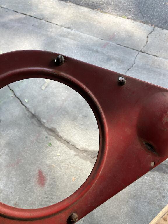

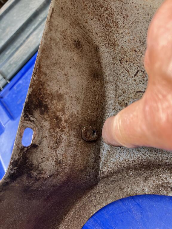

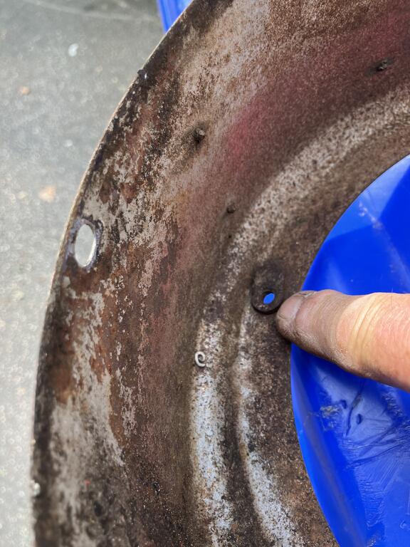

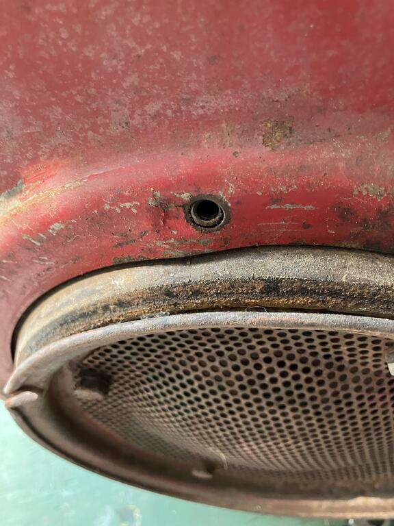

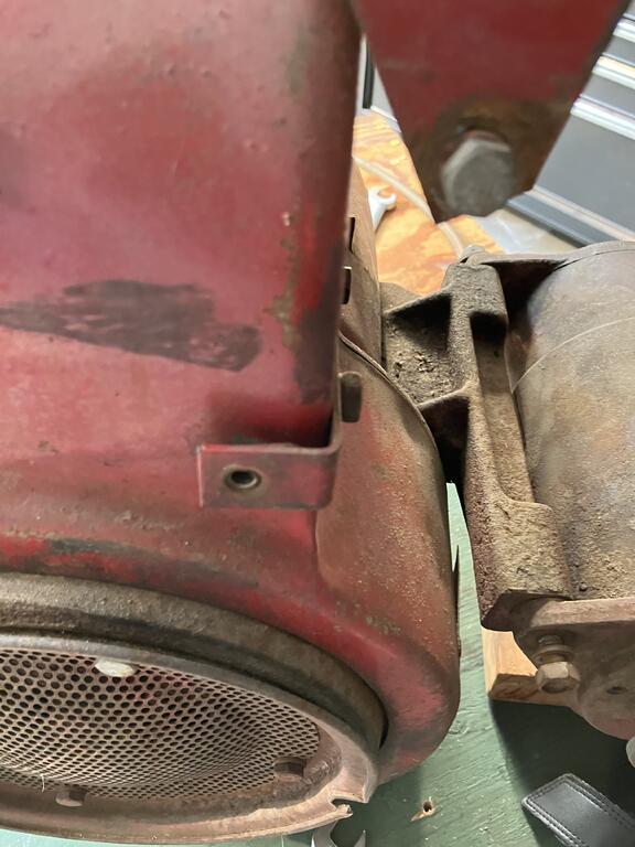

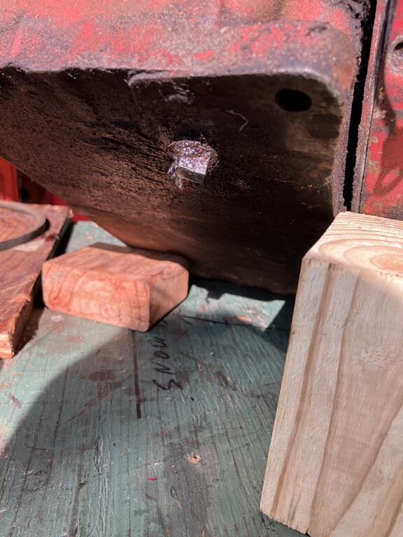

Retired Wrencher 6,993 #1 Posted June 23, 2025 (edited) I have this start/Gen K241 that is different than any other 241 I ever had or seen. Buy the picks I hope someone can tell me if this was made for a Wheel Horse? In the 1st pick the drain is underneath the block? The belt guard hold downs. Last the inside of the belt guard. Do you think this is the first year of the 241? O was this made for another manufacturer . Also where the bottom bolts are there is no tap and die on the bearing plate by the flywheel. Edited June 23, 2025 by Retired Wrencher 2 Share this post Link to post Share on other sites
squonk 48,207 #2 Posted June 23, 2025 953/1054 engine. Extra holes in the belt guard and the oil drain is on the bottom. 3 2 Share this post Link to post Share on other sites
WHX?? 58,290 #3 Posted June 23, 2025 Yep fer sure the belt guard is 953. 1 1 Share this post Link to post Share on other sites

squonk 48,207 #8 Posted June 23, 2025 The 953 was technically 9 3/4 HP. I replaced the engine in mine with a rebuilt K321 long block from richmondred. Ironically it came with the same oil pan with the drain in the bottom. Share this post Link to post Share on other sites
953 nut 69,724 #9 Posted June 23, 2025 The 953 engine had a different carburetor and cylinder head part number from the 1054. The base pans would be the same and if desired the block could be bolted up to other oil pans. Share this post Link to post Share on other sites

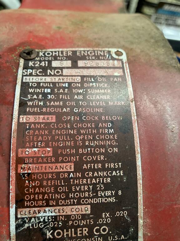

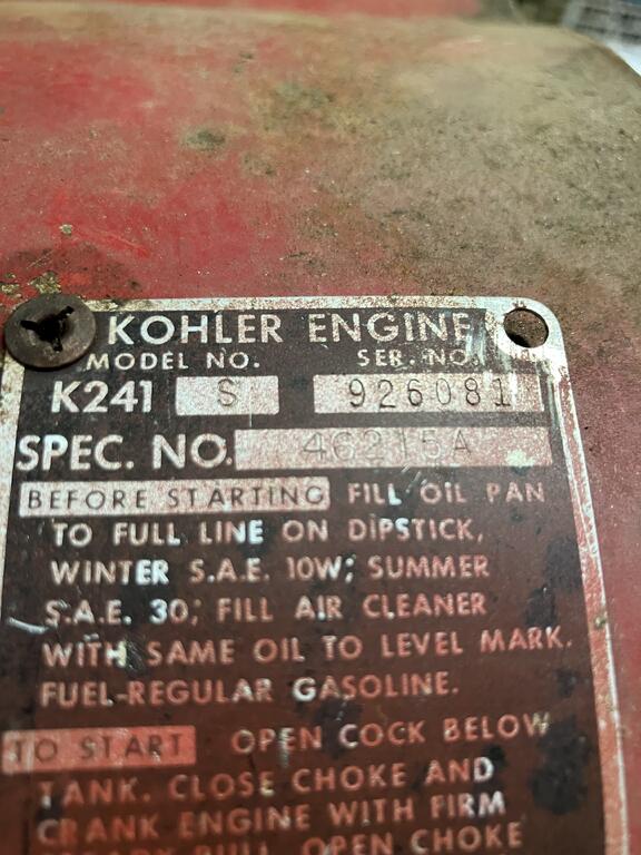

WHX?? 58,290 #10 Posted June 23, 2025 1 hour ago, Retired Wrencher said: So Mike and WHX is this 1964? 63 or 64... if you have a name plate pic we can narrow it down. 2 Share this post Link to post Share on other sites
Retired Wrencher 6,993 #11 Posted June 24, 2025 16 hours ago, squonk said: The 953 was technically 9 3/4 HP. I replaced the engine in mine with a rebuilt K321 long block from richmondred. Ironically it came with the same oil pan with the drain in the bottom. Good info there Mike. Thanks for the reply. Share this post Link to post Share on other sites
Retired Wrencher 6,993 #12 Posted June 24, 2025 15 hours ago, WHX?? said: 63 or 64... if you have a name plate pic we can narrow it down. Jim I can take a picture today and post it. It does have a 241 decal on the fan shroud. 1 Share this post Link to post Share on other sites
Retired Wrencher 6,993 #13 Posted June 24, 2025 Jim here is the name plate. Share this post Link to post Share on other sites
squonk 48,207 #14 Posted June 24, 2025 That shroud# is for 64 1 Share this post Link to post Share on other sites
WHX?? 58,290 #15 Posted June 25, 2025 So good chance it's a motor off a 1054. Share this post Link to post Share on other sites
