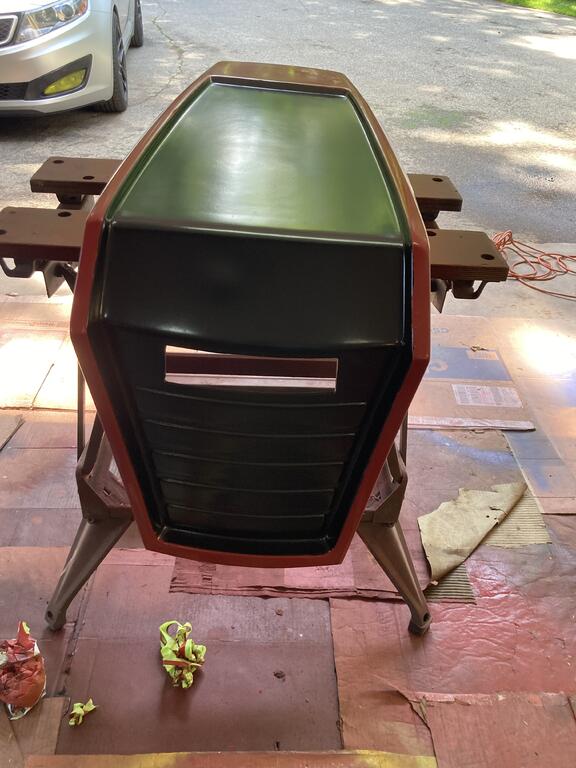

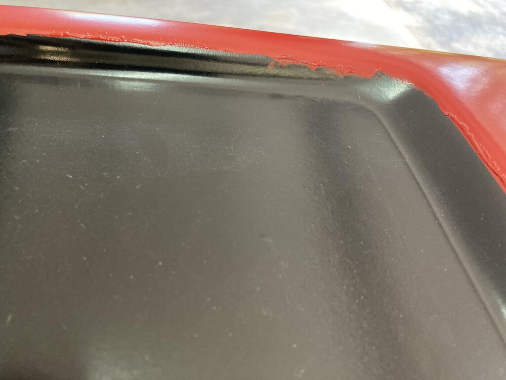

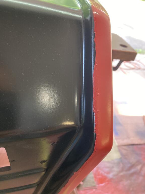

TonyToro Jr. 2,523 #1 Posted June 22, 2025 So as many of you know I’m in the finishing stages of restoring my C-161 twin. We are now onto the last 3 steps and 1 of those is painting the hood. We painted the black and it turned out great. Then we taped off all the black parts of the hooded and put the line where the red and black meets. We painted the red and it turned out pretty good. We used Rust Oluem Regal Red spray cans. Then we cleared the red with Rust Oluem crystal clear, clear coat. We let it sit for about 5 minutes then disaster struck. On one side of the red and black the paint and clear both just came out with the tape like slime and wrecked the edge. The other side turned out ok. Then since we know we gotta re-do it we just put it out into the sun to back on. Then after about 4 hours in the sun we noticed weird white spots and some strips of it all over the hood. We are thinking the reason everything happen was becuase of the clear coat. Looking for some opinions on how you guys paint your black hoods. Thanks! 4 Share this post Link to post Share on other sites
MainelyWheelhorse 3,008 #2 Posted June 23, 2025 @TonyToro Jr. You could fix your tape line issue with tape and a nail polish applicator with pint cans of the Rustoleum paint you used. I use that method for if i get a scratch or chip on my tractors. The clear turning white sounds environmental, Almost like it got too hot. It's especially odd since the paint didn't have issues except for the taped lines. I'd look at the directions again as I've heard Rustoleum takes a while to dry and harden up regardless of temperature. These are just some observations, one of the more seasoned painter members may be able to give you more info. 1 Share this post Link to post Share on other sites
kpinnc 18,851 #3 Posted June 23, 2025 (edited) I've been following this thread and I noticed you painted the black first. I thought you were gonna teach me something new, because I've heard "Always paint the darker color last". Not sure if it matters or not honestly. But one thing I believe that I see is that you didn't scuff those black edges where the red would touch before painting. The rustoleum clear is actually pretty good stuff, but like most clear it shrinks a little. Since it's formulated specifically for rustoleum paint, the directions say spray withing 15 mins of base coat, or otherwise wait 24 hours. So two things stand out from your previous post that make me wonder: 1. As I already said, you didn't scuff the edges of the black to provide some hook up of the red coat. 2. The only time I've seen rustoleum clear have a whitish look to it is when it is applied way too thick. I've done it myself, and it doesn't have any more luster when it's applied in a single thick coat. It actually tends to cloud up and attack the previous layer. It's meant to dry fast. When it can't, the solvents in it can harm the previous coat. Several light coats is still the way to go here. One more mention- between the red and black meeting point, or any other time you (very) lightly scuff (1500-2000 grit works great) a finish, wait 24 hours before painting over it. Scuffing provides a surface to grip, but it also opens pores in the coat and they have to cure again before applying anything over it. Painted 6 months ago? Makes no difference. @TonyToro Jr. I posted this in a hurry and I hope it doesn't sound critical. I've been impressed by your work on this for a while. I also am not a great painter. What little I know I learned from a great professional painter before he retired, and only a few of his lessons apply because I have no paint booth nor do I regularly use high end finishes. Most of my stuff is on the rattle can level at best. That being said, three points do tend to apply to anything: prep is everything, sand between coats, never apply new paint over anything that hasn't had time to cure. The list goes on... Your hood can be saved. It's happened to all of us. Happened to me a couple months ago. The finish seems to be where things bite back, and it's just part of the process. But it's also part of the challenge. And hard work may not always pay well, but somebody always recognizes it. We all recognize how hard you've worked here! Keep at it! Edited June 23, 2025 by kpinnc 3 1 Share this post Link to post Share on other sites
RED-Z06 2,718 #4 Posted June 23, 2025 Every time ive tried to use clear i ended up stripping back bare and starting over, Even using high end clears with reducer and hardener that the manufacturer says is okay with the base coat. I get wrinkles, cloudiness, discoloration, its too much work to have to restrip fresh paint and primer to do it twice. 1 Share this post Link to post Share on other sites
ri702bill 12,694 #5 Posted June 23, 2025 8 hours ago, TonyToro Jr. said: We let it sit for about 5 minutes then disaster struck. On one side of the red and black the paint and clear both just came out with the tape like slime and wrecked the edge. You probably did not wait long enough, or pulled the tape in the wrong direction. Next time, check to see if the paint is dry enough by placing a fingertip on the painted tape. If you get paint on your finger, it is still too wet..... Pull the tape back almost 180 degrees flat to the surface and slightly away from the fresh painted edge. I see you used masking tape, not the blue painter's tape. The solvents in enamel can disolve the glue in masking tape at the edge, allowing the paint to migrate slightly under. When you remove the tape, you are now pulling paint and tape glue..... One trick is to use a sharp razor or X-acto knife to score the painted edge at the tape and painted panel before removal. Not for the fainthearted..... 2 Share this post Link to post Share on other sites
SylvanLakeWH 31,994 #6 Posted June 23, 2025 I never use clear coat so can't comment on that. I always do the black first. Not sure it matters - I'm No expert. It almost looks like the tape wasn't sealed tightly where there creeping occurred... I use only painters tape and peel back away from new paint as noted above be... Sand the edge and try touch up first... You're doing a GREAT job!!! Keep at it!!! 1 Share this post Link to post Share on other sites
squonk 47,731 #7 Posted June 23, 2025 Enamels take longer to dry. I have great success with Rustoleum spray cans and clear. But, in a 2 color application like this I would have either. Sprayed one color and let it sit for a few weeks at least then used top quality paint release tape. Then spray the other color and cleared everything. Or. Like I did on Marvin. Use an automotive base coat /clearcoat system that is designed for quick drying and masking for quicker production work. 1 1 Share this post Link to post Share on other sites
TonyToro Jr. 2,523 #8 Posted June 23, 2025 6 hours ago, RED-Z06 said: Every time ive tried to use clear i ended up stripping back bare and starting over, Even using high end clears with reducer and hardener that the manufacturer says is okay with the base coat. I get wrinkles, cloudiness, discoloration, it’s too much work to have to restrip fresh paint and primer to do it twice. That is pretty much everything that happened to the hood. Next time I don’t think we are going to clear coat. Thanks! Share this post Link to post Share on other sites
TonyToro Jr. 2,523 #9 Posted June 23, 2025 8 hours ago, kpinnc said: I've been following this thread and I noticed you painted the black first. I thought you were gonna teach me something new, because I've heard "Always paint the darker color last". Not sure if it matters or not honestly. But one thing I believe that I see is that you didn't scuff those black edges where the red would touch before painting. The rustoleum clear is actually pretty good stuff, but like most clear it shrinks a little. Since it's formulated specifically for rustoleum paint, the directions say spray withing 15 mins of base coat, or otherwise wait 24 hours. So two things stand out from your previous post that make me wonder: 1. As I already said, you didn't scuff the edges of the black to provide some hook up of the red coat. 2. The only time I've seen rustoleum clear have a whitish look to it is when it is applied way too thick. I've done it myself, and it doesn't have any more luster when it's applied in a single thick coat. It actually tends to cloud up and attack the previous layer. It's meant to dry fast. When it can't, the solvents in it can harm the previous coat. Several light coats is still the way to go here. One more mention- between the red and black meeting point, or any other time you (very) lightly scuff (1500-2000 grit works great) a finish, wait 24 hours before painting over it. Scuffing provides a surface to grip, but it also opens pores in the coat and they have to cure again before applying anything over it. Painted 6 months ago? Makes no difference. @TonyToro Jr. I posted this in a hurry and I hope it doesn't sound critical. I've been impressed by your work on this for a while. I also am not a great painter. What little I know I learned from a great professional painter before he retired, and only a few of his lessons apply because I have no paint booth nor do I regularly use high end finishes. Most of my stuff is on the rattle can level at best. That being said, three points do tend to apply to anything: prep is everything, sand between coats, never apply new paint over anything that hasn't had time to cure. The list goes on... Your hood can be saved. It's happened to all of us. Happened to me a couple months ago. The finish seems to be where things bite back, and it's just part of the process. But it's also part of the challenge. And hard work may not always pay well, but somebody always recognizes it. We all recognize how hard you've worked here! Keep at it! Doesn’t sound critical at all. Thanks for the info! 1 Share this post Link to post Share on other sites

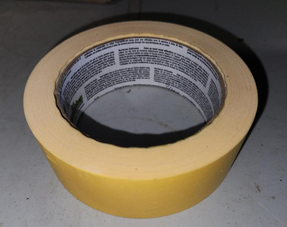

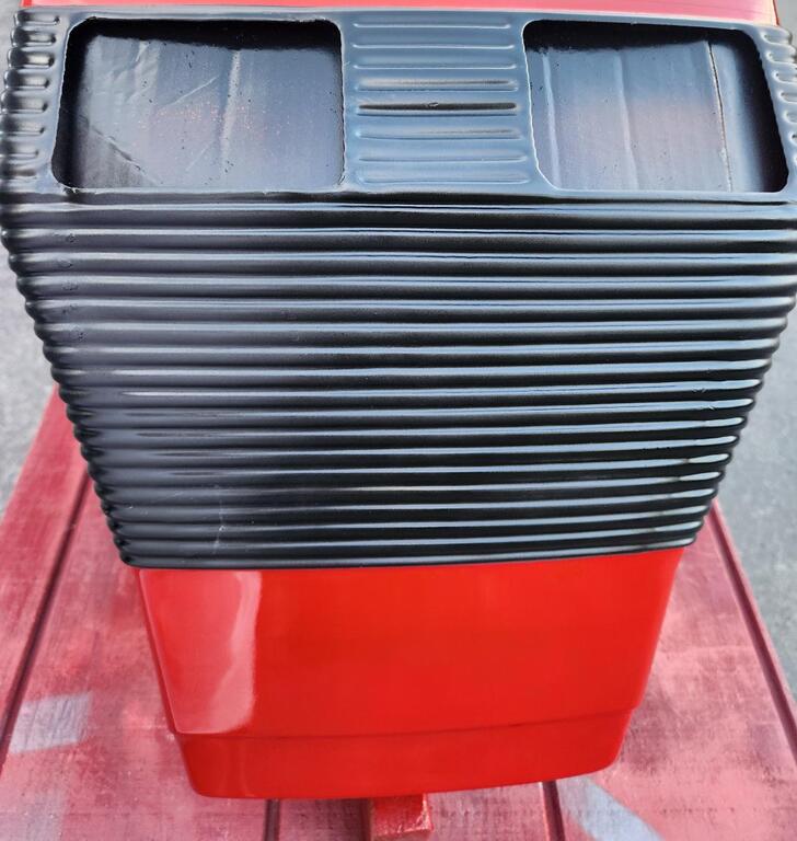

Brockport Bill 2,448 #12 Posted June 23, 2025 i am 100 percent an amateur paint guy -- not a real restore guy like some of the awesome restored tractors seen here on RSq -- but i have used some rattle cans to rehab a few machines and attachments -- here is photo of a painters tape product i found that is for what they call "Delicate surface"-- I was able to apply tape on a 1 prior day painted surface that has not "hardened" for days, weeks, or months, No bleeding ---------- that helped me with border line for 2 paints on a 416 grill of black to red --- also did a c175 hood -- black border to red -- been able to get a pretty clean dividing line !!!!!!!!!!! Suggest to experiment with FrogTape to see what works for you???????? 2 Share this post Link to post Share on other sites
