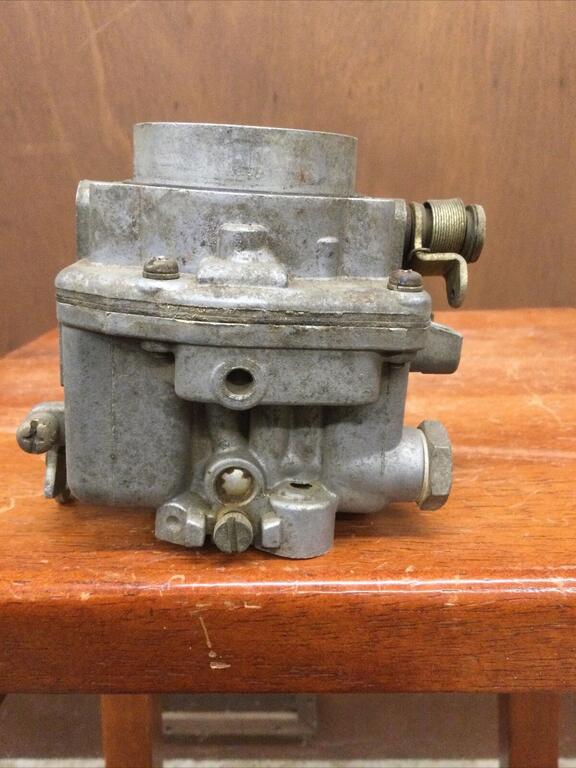

There is a welsh plug just above the idle mixture screw on the muffler side of the carburetor, check if it might have fallen out.  Yes, it is hard to see but a flashlight can help.  I wouldn't run it if the plug is out due to dust getting in.  One more trick is to go full throttle and then push the choke full on for a second in an effort to clear debris.

This is what you are looking for:
