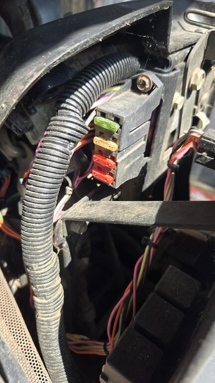

groffster99 7 #3 Posted July 3, 2025 (edited) Thanks gwest. I appreciate the help. sorry, I was away with work. Got back late last night. I'll look that over tonight. edit: I just went out and looked. I get no sound or vibrations from the fuel solenoid on the bottom side of the carb. I also check the fuse that I know of and it was good (I only know of the fuse box behind the dash on the right side. holds 4 fuses, a 30, a 25 and two smaller ones. picture attached). Is there a second fuse panel that I might need to check? I'll have to find the diode on the rectifier circuit and check that. Are the diodes replaceable or do you have to get a new harness or something like that? Is there a way to bypass the solenoid, remove it or alter it so I can validate my issue? Or do you have to purchase a new carb for that? Edited July 3, 2025 by groffster99 Share this post Link to post Share on other sites
