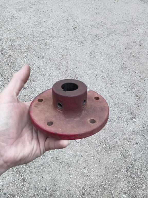

oliver2-44 11,036 #3 Posted June 18 On you axle hubs and shafts are the keys and key ways good and square or are the wallowed out. If still quaternary get new cupped point locking bolts. The cup on these looses sharpness and doesn’t bite in as good. Also On later models WH added a 2nd cup point locking bolt 90 degrees from the 1st one. Many of us drill and tap a 2nd one in our old hubs. Share this post Link to post Share on other sites

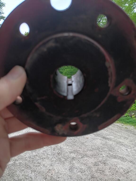

ebinmaine 75,366 #4 Posted June 18 5 hours ago, oliver2-44 said: are the keys and key ways good and square or are the wallowed out Here's a couple pics of a good square keyway and the double set screw holes. Carefully check your hubs, axles, keys, and REPLACE your set screws. 7 hours ago, hebeegeebe said: can't keep either wheel on the axle for long on my hilly terrain I live on the side of a mountain and we haul very heavy loads. My hubs don't move once they're set TWICE after installation. 7 hours ago, hebeegeebe said: was banging on that wheel Please do not do this. The axles have a keeper ring that can be damaged. 7 hours ago, hebeegeebe said: damaged the little rubber "tee" fitting for the gas line where it leaves the tank. A suggestion on remedying that would be quite helpful. Replacement part #'s or a fix it idea? The rubber grommet and that fuel valve are readily available from many sources. I do NOT recommend using cheap parts. Good quality replacement pieces are available from Aircraft Spruce Company. I can get you links later today if it would help. While you're in the fuel system you need to replace ALL of the fuel line with good modern rubber lines. Consider adding a primer bulb as well. Share this post Link to post Share on other sites
ri702bill 10,442 #5 Posted June 18 (edited) 6 hours ago, oliver2-44 said: Many of us drill and tap a 2nd one in our old hubs. I do just that on any I have that came with only one bolt over the keyway. McMaster Carr has the correct cup point square head set screws. As @ebinmaine and I will tell you, it is imperative that the set screws be properly torqued, not just snuggged up & a tad beyond. It is now part of my semi annual ritual of swapping winter / summer tires. Do check out A-Z Tractors in the Vendor section. They sell a custom machined Taper-Lok design repair hub. Not exactly cheap, but easily installed & removed.... and no more set screws to deal with. Edited June 18 by ri702bill 1 Share this post Link to post Share on other sites

Lee1977 7,439 #7 Posted June 18 (edited) Once a set of hubs get worn and loose there isn't a way to fix them. The taper lock hubs from A-Z Tractor will fix the problem. I replaced both of mine with the taper lock on my Raider . Edited June 18 by Lee1977 2 Share this post Link to post Share on other sites

mrc 1,010 #10 Posted June 19 gwest, i have installed 2-3 of these hubs. never removed one yet. however, if you look at the pic provided by Lee1977 you will see 6 allen head bolts. 3 are long and 3 are short. if memory serves me correct you put the long screws in the short holes and the hub becomes its own puller. hopefully someone can explain it better to you. regards mike Share this post Link to post Share on other sites
