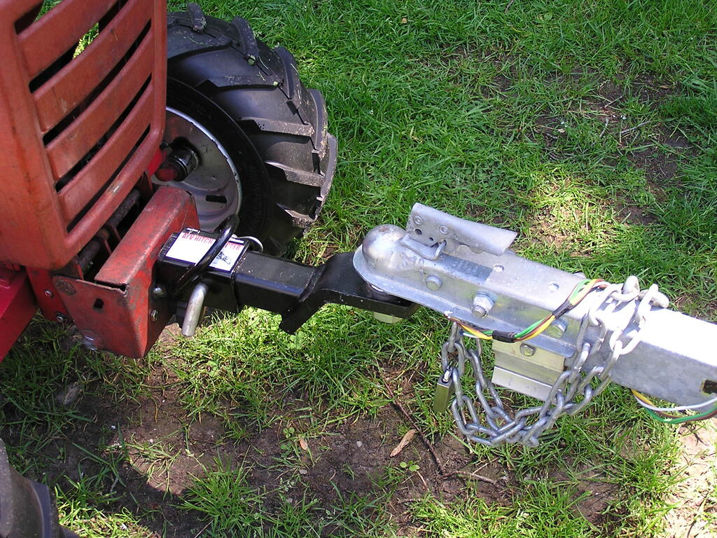

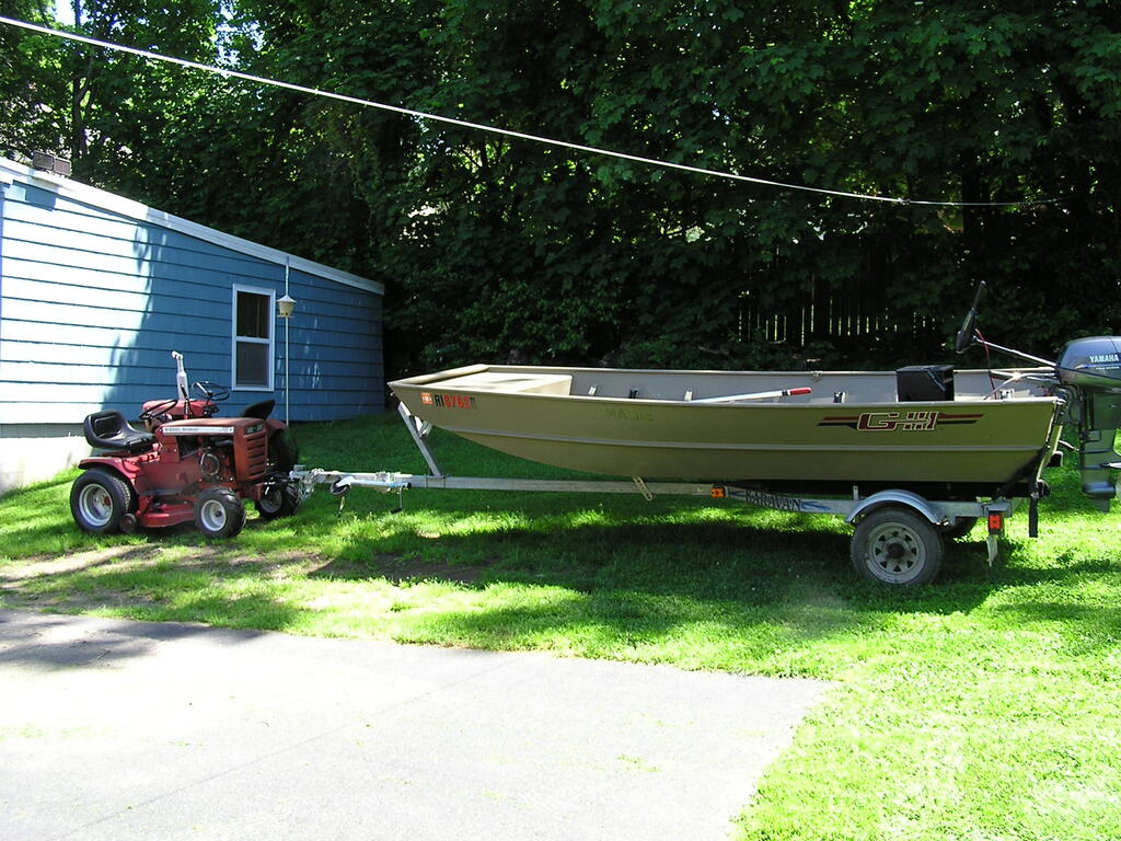

ri702bill 12,802 #2 Posted June 17, 2025 Mike - I for one find it way easier to move trailers with a front mounted hitch. I use it on the C81; made it out of an old mule drive idler and a HFT ATV hitch that cost 11 bucks... Problem solved (unless he has a Round Hood without the Tach-a-matic) 2 3 Share this post Link to post Share on other sites

ri702bill 12,802 #6 Posted June 17, 2025 1 hour ago, mrc said: i agree with you bill that a front mount hitch might be better for moving trailers. with the added tongue weight up front is it hard to steer? i will discuss this option with the young man. thank you mike I hardly notice the difference in the steering effort. But - I usually just pull the trailer out in a straight line, cut the grass in that area with the 854 and push the trailer straight back. There are times I have moved it onto the driveway - steers well. And - I am terrible backing up a trailer with a short wheelbase tractor using the rear hitch!! 1 1 Share this post Link to post Share on other sites

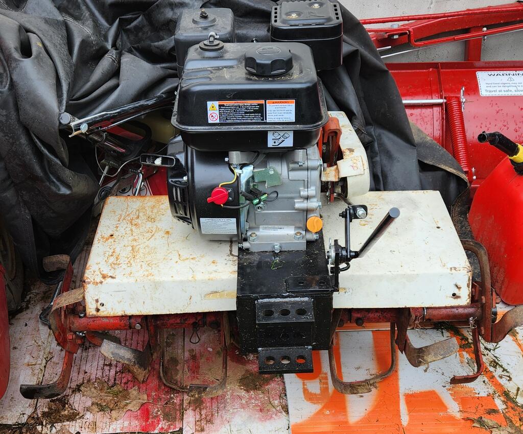

Goldnboy 1,147 #9 Posted June 17, 2025 (edited) You can use a non wheelhorse tiller with sleeve hitch and leave the drawbar on too. Sears made them at one time and was a attachment for Wheelhorse I believe at one point. Here is what I use. Edited June 17, 2025 by Goldnboy 1 Share this post Link to post Share on other sites
