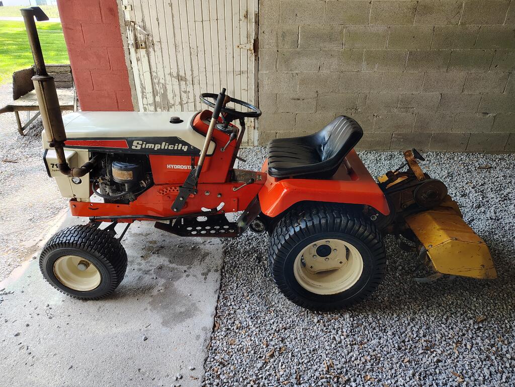

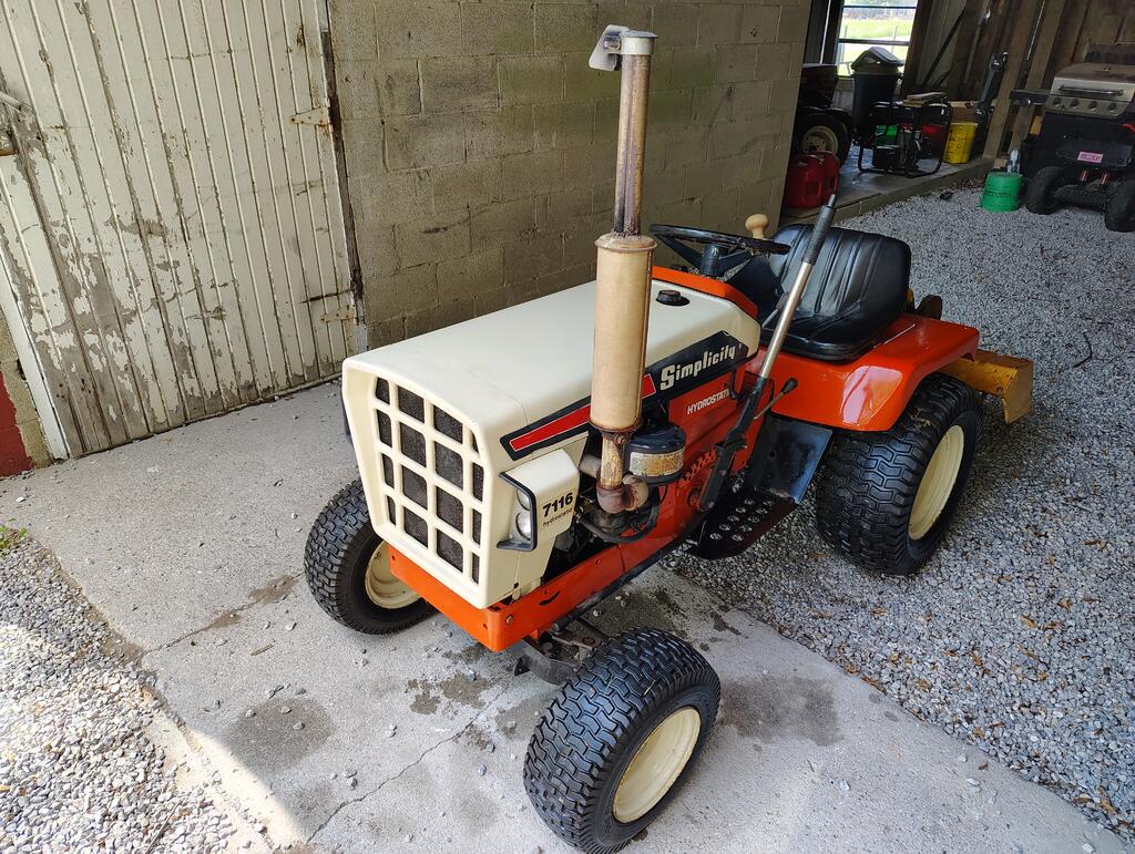

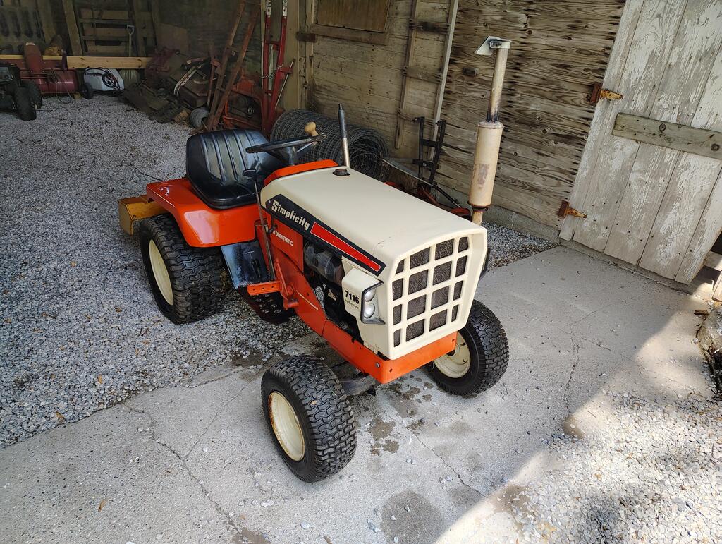

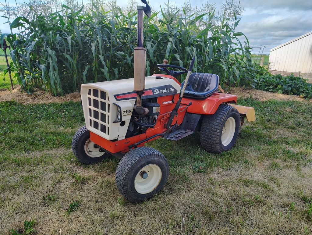

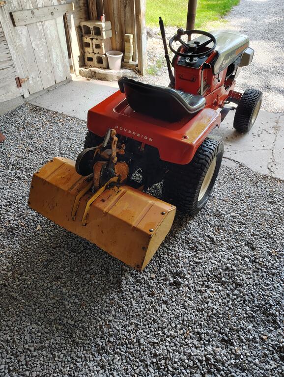

AlexR 3,083 #1 Posted June 16, 2025 (edited) Here is the new to me 1975 Simplicity 7016 I did some trading with my neighbor. It was his Dad's who passed away last year who was our neighbor as well, that we were pretty close to for the amount of time we lived here. So it has some sentimental value as well. Especially for his son who lives there now, knowing it's being taken care and close by. It has the tiller, a front blade, and a deck which probably to far gone to save. Also some wheel weights I did wash it before the photos. The sticker is not right I did check the model number on the tractor and it is a 7016. I did check the bevel gearbox and it doesn't have to much slop it's still within acceptable range. After checking this tractor out I can really appreciate the simplicity of the Wheelhorse tractors (pun not intended haha) That said I do love the look of the tractor with this particular hood and the light pods on the side. Edited June 16, 2025 by AlexR 4 5 Share this post Link to post Share on other sites
ebinmaine 80,464 #2 Posted June 17, 2025 10 hours ago, AlexR said: After checking this tractor out I can really appreciate the simplicity of the Wheelhorse tractors (pun not intended haha) Absolutely agreed. Our stable is filled with Wheelhorse tractors and implementation specifically for that reason. 10 hours ago, AlexR said: That said I do love the look of the tractor with this particular hood and the light pods on the side Neat looking rig. Those side steps with multiple holes are practical pieces. 1 Share this post Link to post Share on other sites
953 nut 68,830 #3 Posted June 17, 2025 Being a hydro drive you would think the implement lift would have been hydro also. 2 Share this post Link to post Share on other sites
AlexR 3,083 #4 Posted June 17, 2025 3 hours ago, ebinmaine said: Absolutely agreed. Our stable is filled with Wheelhorse tractors and implementation specifically for that reason. Neat looking rig. Those side steps with multiple holes are practical pieces. The wheelhorse's aren't going anywhere that's for sure. Definitely if you get a lot of mud on your shoes as well. I guess I did forget to mention the tractor is non-running right now. Ran when parked though, and it was stored inside so I don't anticipate much other then old gas/carb and battery. 1 Share this post Link to post Share on other sites
AlexR 3,083 #5 Posted June 17, 2025 59 minutes ago, 953 nut said: Being a hydro drive you would think the implement lift would have been hydro also. Thanks! Yeah I was hoping it was hydro lift but I think it was just like Wheelhorse it was a option a lot of people didn't want to spend the money on. 2 Share this post Link to post Share on other sites

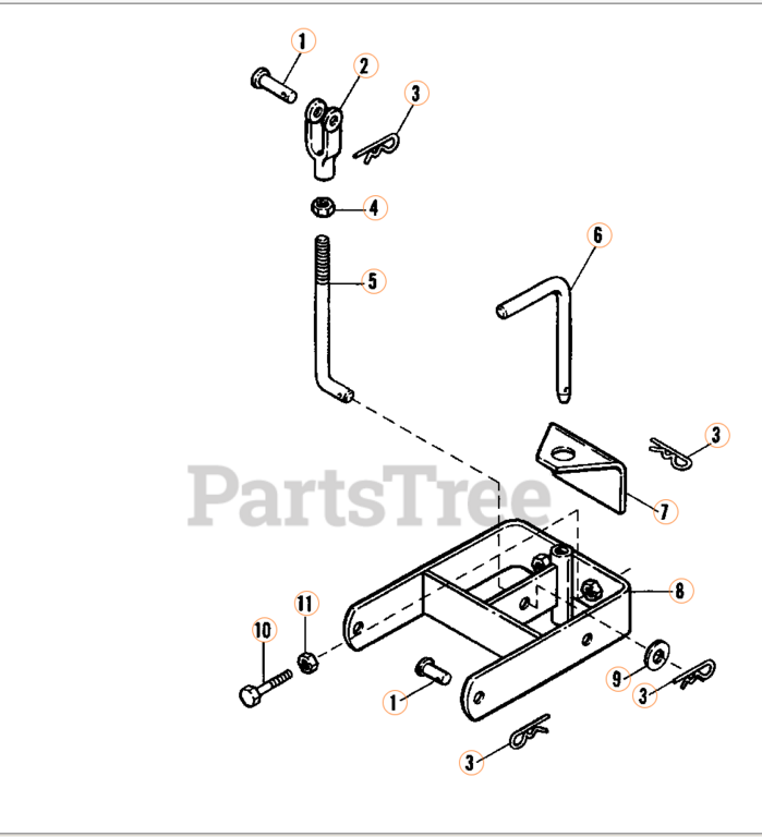

sergeant 350 #16 Posted June 28, 2025 On 6/17/2025 at 7:28 AM, AlexR said: Thanks! Yeah I was hoping it was hydro lift but I think it was just like Wheelhorse it was a option a lot of people didn't want to spend the money on. Usually the 7016 had an optional electric lift actuator. It wasn't until the early 1980s that hydraulic lift was back as an option. Before the 1970s, hydraulic lift was the only option after manual lift. But what is interesting about the manual lift is you can have two manual lifts on at the same time: one for the rear implements and Mowing deck (left side, which was standard) and one for the front implements (right side, which was optional). But the left side lever could Pick Up all 3 lift Points . The Optional right side lever was just for front Implements. But that was Nice You could run the front Blade with the Tiller Installed or a Front snow thrower with a rear blade on on control each Independently. My 7016 has the electric lift kit, but that Briggs in my 7016 gave up the ghost in 2015. I was giving it to a friend, and I dropped it at the mechanic for him, but when he found out the cost to fix it, he left it at the Simplicity dealer. All I have left of my 7016 is the one-point hitch (sleeve hitch), as I always planned to get a later Simplicity Sovereign 18H, which comes standard with hydraulic lift and hydraulic power steering. The downside of the 1-point hitch is that it also uses a cable to raise and lower the hitch, like the Wheel Horse slot or Clevis Hitch. I wish both Simplicity and Wheel Horse would have made a metal arm or some type instead of a cable to raise and lower their rear hitches. But the Simplicity 1-point hitch does lift a bit higher than a clevis hitch on a Wheel Horse. Nice when plowing with a sleeve hitch plow. Dips don't make the plow hit the ground when at transport height on the Sovereign Like My WH416H does sometimes. That's the one place Deere got smart after the round fender 110/112. which used a cable to raise and lower their integral hitch (sleeve hitch). Deere went to a metal arm setup for the Integral Hitch in their 110/112 Square Fenders in 1968. And that system was used through the JD 200 series until the end of production in 1987. When the Simplicity Conquest/Prestige came out, the 1-point hitch used a metal arm to connect their 1-point hitch to the tractor's rocker shaft. 1 1 Share this post Link to post Share on other sites
AlexR 3,083 #17 Posted June 29, 2025 1 hour ago, sergeant said: Usually the 7016 had an optional electric lift actuator. It wasn't until the early 1980s that hydraulic lift was back as an option. Before the 1970s, hydraulic lift was the only option after manual lift. But what is interesting about the manual lift is you can have two manual lifts on at the same time: one for the rear implements and Mowing deck (left side, which was standard) and one for the front implements (right side, which was optional). But the left side lever could Pick Up all 3 lift Points . The Optional right side lever was just for front Implements. But that was Nice You could run the front Blade with the Tiller Installed or a Front snow thrower with a rear blade on on control each Independently. My 7016 has the electric lift kit, but that Briggs in my 7016 gave up the ghost in 2015. I was giving it to a friend, and I dropped it at the mechanic for him, but when he found out the cost to fix it, he left it at the Simplicity dealer. All I have left of my 7016 is the one-point hitch (sleeve hitch), as I always planned to get a later Simplicity Sovereign 18H, which comes standard with hydraulic lift and hydraulic power steering. The downside of the 1-point hitch is that it also uses a cable to raise and lower the hitch, like the Wheel Horse slot or Clevis Hitch. I wish both Simplicity and Wheel Horse would have made a metal arm or some type instead of a cable to raise and lower their rear hitches. But the Simplicity 1-point hitch does lift a bit higher than a clevis hitch on a Wheel Horse. Nice when plowing with a sleeve hitch plow. Dips don't make the plow hit the ground when at transport height on the Sovereign Like My WH416H does sometimes. That's the one place Deere got smart after the round fender 110/112. which used a cable to raise and lower their integral hitch (sleeve hitch). Deere went to a metal arm setup for the Integral Hitch in their 110/112 Square Fenders in 1968. And that system was used through the JD 200 series until the end of production in 1987. When the Simplicity Conquest/Prestige came out, the 1-point hitch used a metal arm to connect their 1-point hitch to the tractor's rocker shaft. I saw the option for the dual lift that would have been sweet, I would have liked that for the front blade and tiller. Thank you very much for the information very informative. I see they have some sleeve hitch kits on eBay for these simplicity's, if I decide to use this one for plowing I might get that. But I already have my one gear drive Wheelhorse that is setup as a plow mule, and I have another gear drive wheelhorse that is in line to get restored that I am thinking of using for plowing as well. Share this post Link to post Share on other sites
sergeant 350 #18 Posted June 29, 2025 43 minutes ago, AlexR said: I saw the option for the dual lift that would have been sweet, I would have liked that for the front blade and tiller. Thank you very much for the information very informative. I see they have some sleeve hitch kits on eBay for these simplicity's, if I decide to use this one for plowing I might get that. But I already have my one gear drive Wheelhorse that is setup as a plow mule, and I have another gear drive wheelhorse that is in line to get restored that I am thinking of using for plowing as well. Well, the good thing about the tiller is you already have most of the 1-point hitch; all you need is this. shown below BTW that section of the 1 point Hitch has actually never changed from the original simplicity Garden tractors of the 1960's to the Conquest or Prestige I actually have two Late Model 1- point Hitches for the Conquest an Prestige as well One for tractors with suspension and one for tractors without Suspension. The 1-Point set up for the Tractors with suspension have extra Brackets that Bolt to the frame so You remove the rear shocks to use the 1-point Hitch 1 Share this post Link to post Share on other sites

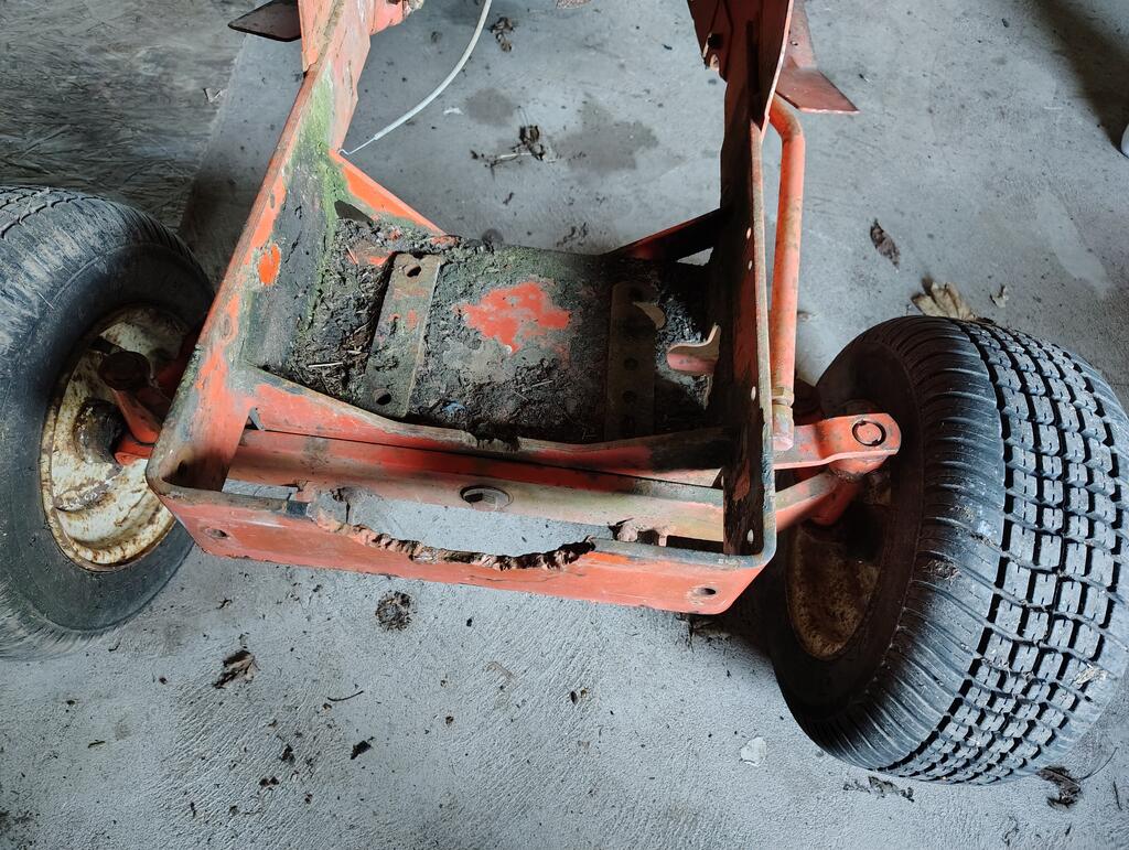

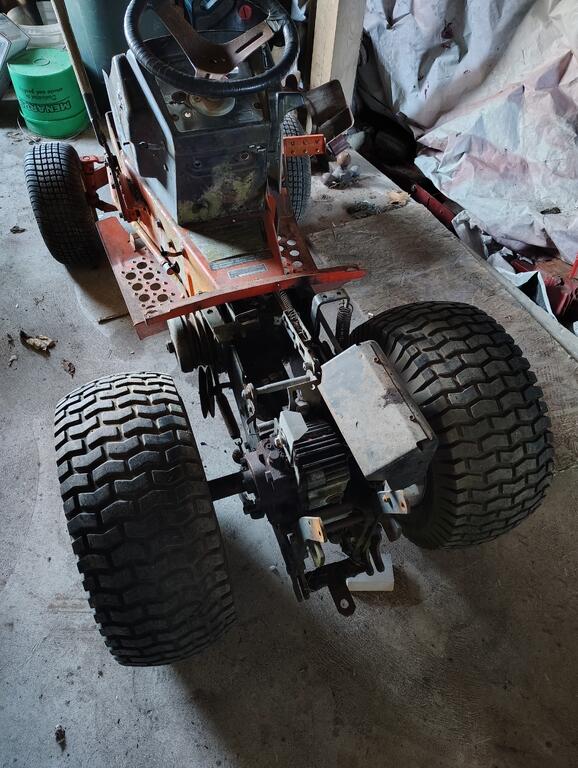

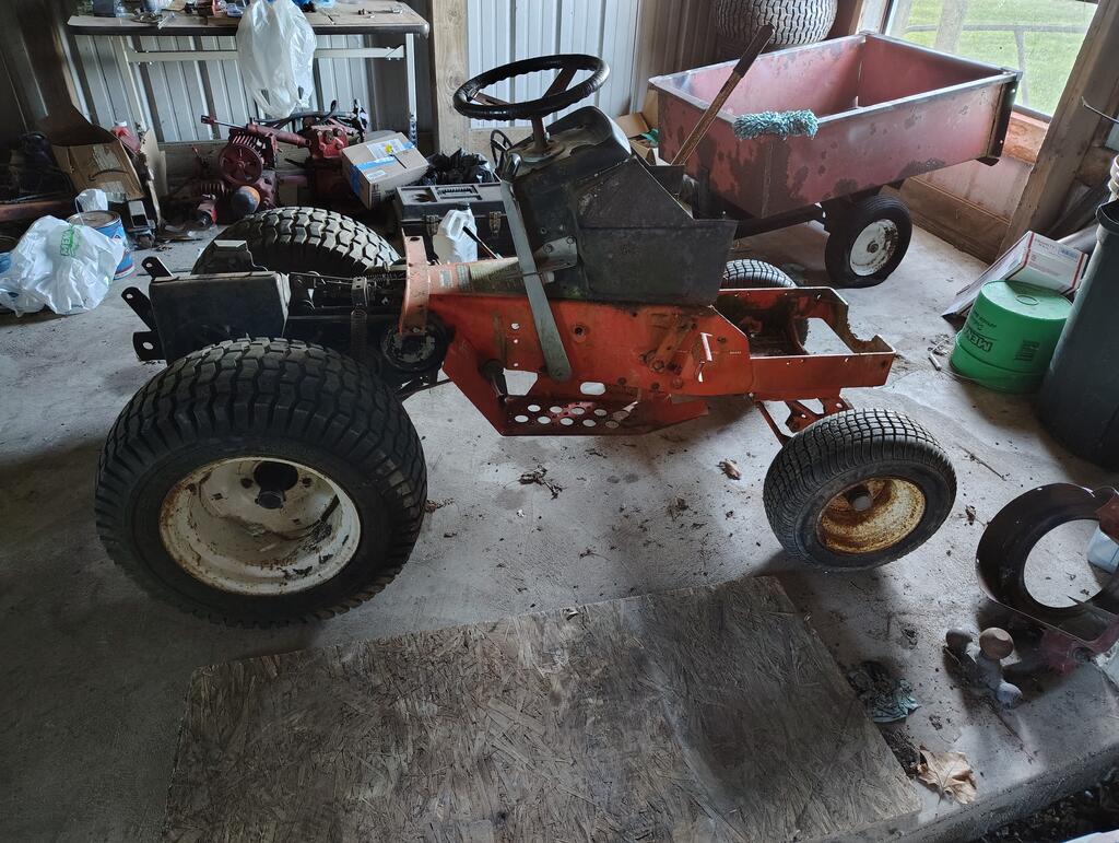

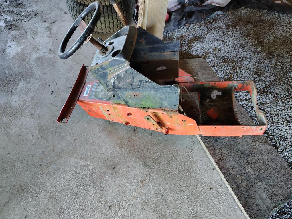

AlexR 3,083 #23 Posted April 25 Got a parts machine with hopefully a hydro that works. It came with a completely rusted out seat pan that is going to the scrap, the hood was rough cut up some, I gave that to my neighbor he likes to make things sometimes. Going to pull everything off that I think I might use the frame has been destroyed enough I think I will probably scrap what's left. Going to keep the bevel gearbox for sure as well. Thinking about pulling steering components and the front axle as well. Tires and wheels are worth what I paid though. 2 Share this post Link to post Share on other sites

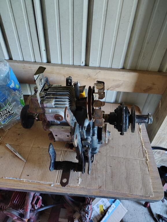

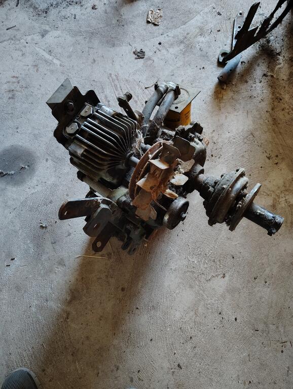

AlexR 3,083 #24 Posted June 19 Simplicity's aren't very simple Got the transmission pulled out of the parts tractor and it was not simple. I almost thought I was going to have to completely disassemble the tractor until I realized I can rotate and twist the transmission and hub through the hole on the left plate. I can definitely appreciate how easy the Wheelhorse's are to work on. 6 bolts and remove the belt and parking brake linkage and the wheelhorse hydros come right out. And you don't even have to remove the wheels. 2 Share this post Link to post Share on other sites
AlexR 3,083 #25 Posted June 19 Cleaned up the transmission and bevel gearbox and got the rest of the tractor apart to keep the good parts and scrap the rest. 3 Share this post Link to post Share on other sites
